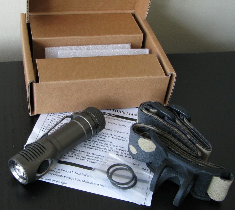

For both lights, included in the simple but firm cardboard box was the light with removable clip (attached), extra o-rings, and a one-page instruction sheet. The SC50w also came with the classic Zebralight headband with soft plastic light holder (shown above) – but the SC51 sample was lacking this accessory.

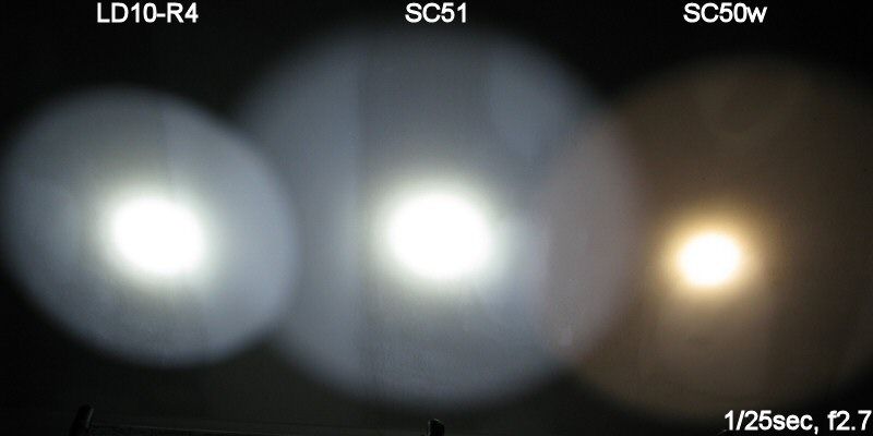

Beamshots
Sorry for the quality of the beamshots – I've recently moved, and haven't had a chance to set up a proper beamshot closet yet. What you are looking at below is un-primed drywall, with a range of spakle/sanding marks.
All lights are on Max, ~0.5m from a white wall on Sanyo Eneloop. The camera was set to automatic white balance, and the SC50w doesn't look that warm in real life.
Although the un-primed drywall makes things a bit messy, you can see that the SC50/SC51 have a wider beam profile than the Fenix LD10-R4. Throw on the Zebralights are reasonable for this class.

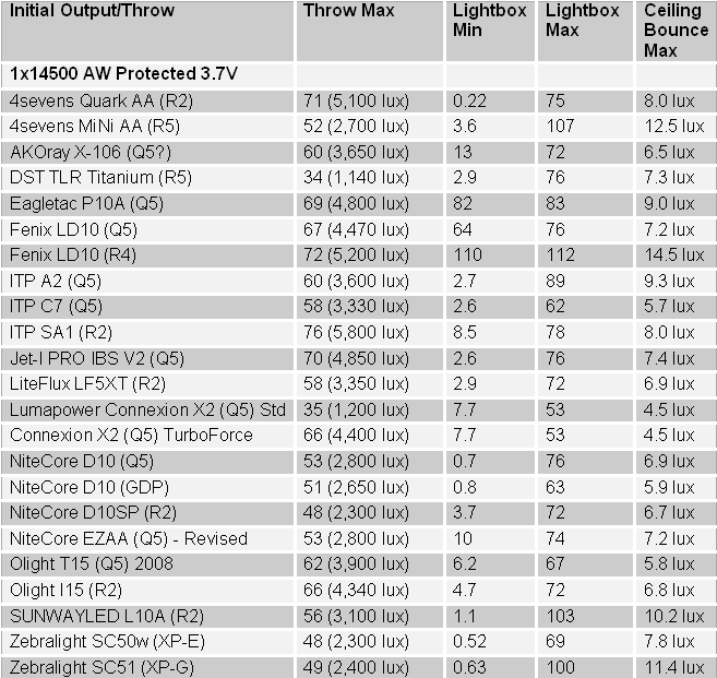

Testing Method: All my output numbers are relative for my home-made light box setup, a la Quickbeam's flashlight reviews method. You can directly compare all my relative output values from different reviews - i.e. an output value of "10" in one graph is the same as "10" in another. All runtimes are done under a cooling fan.
Throw values were taken at 1 meter for all lights shown below.
And no, those output numbers for the SC51 on Eneloop are not misprints! :eek:

Output/Runtime Comparison
I don't know the output bin of the SC50w, but its performance is quite good for a neutral-white XP-E emitter. It certainly matches or exceeds most R2-equipped cool white lights in my collection. No surprises – all modes tested did very well on all batteries :thumbsup:
So how do you top that? Enter the SC51 - performance on standard batteries (Eneloop NiMH, alkalkine, L91) is simply outstanding. :eek:oo:
Zebralight informed me that the SC51 was optimized for standard batteries, but I wasn't expecting this kind of performance. Output/runtime efficiency clearly outperforms even the Fenix LD10-R4 – in some cases by as much as 50% or more! Max output is also noticeably higher than the Fenix (which was itself head-and-shoulders above the other lights in my collection). The Eneloop, L91 and alkaline graphs all tell the story pretty well!
So has the SC51 skimped on 14500 performance? Not all – in fact, I would say it performs as well as any other light given the R4 output bin.
Something else to note – the regulation pattern (on all batteries) is excellent – perfectly flat in all cases except max output.

The beam from the XP-G is definitely bigger and more usable for EDC applications.
A thought occurs to me here - both my lightbox and ceiling bounce measures are similarly affected by beam pattern. Lights with narrow spill beams focused for throw tend to report lower than lights with wider and more diffuse spill. So it's possible the tables and runtime graphs are artificially giving the SC51 a slight output advantage compared to some lights. But this effect likely isn't huge - and after all, a number of the other lights also have wider dispersion beams.
