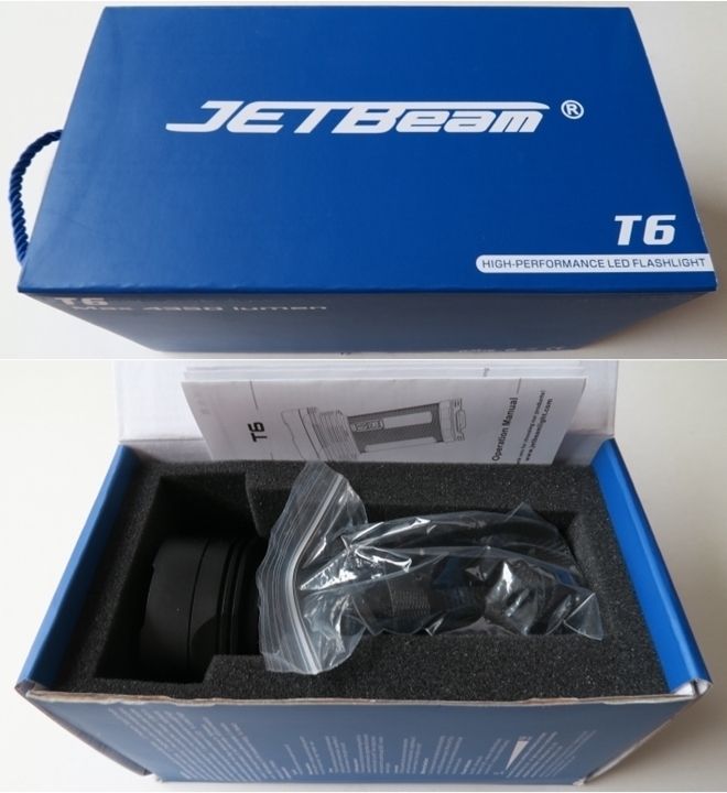

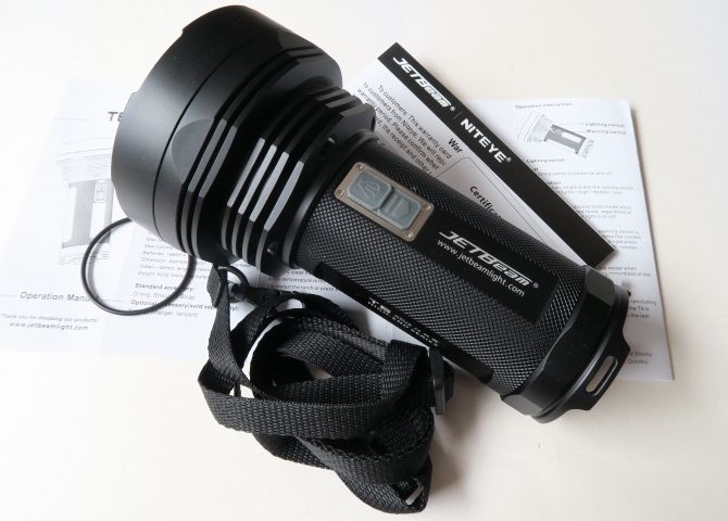

T6 comes with warranty card & manual, shoulder strap, and spare o-ring.

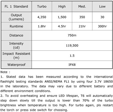

Manufacturer Specifications from Jetbeam website & manual :
• LED : CREE XP-L
• Maximum output : 4350lumens
• Max beam distance : 750meters
• Max runtime : 300hours
• High strength aero grade aluminum alloy body
• Premium Type III hard-anodized anti-abrasive finish of grey
• Toughened ultra-clear mineral glass with double-sided anti-reflective coating
• New circuit design provides double intelligent protections for LED and battery to
maximize their lifespan
• Built-in advanced efficient power management circuit, max runtime endures 300 hours
• Low voltage warning/ power indicator
• Overheating protection to avoid high temperature of flashlight housing and increase
lifespan of LED
• Latest high performance optical system, max beam distance up to 750meters
• Ergonomic double switch design
• Features strobe, SOS and memory functions
• Side switch for selecting different modes
• Compatible with 4x18650 batteries
• IPX-8 waterproof rating
• Impact resistant up to 1.5 meters
• Dimension : Head (88mm), Tube (52mm), length (163mm)
• Weight : 543g (excluding battery)

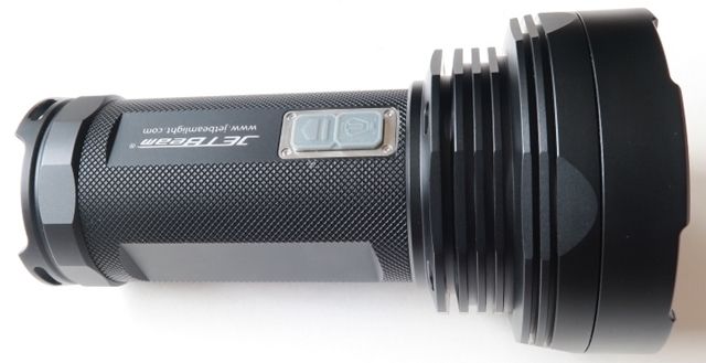

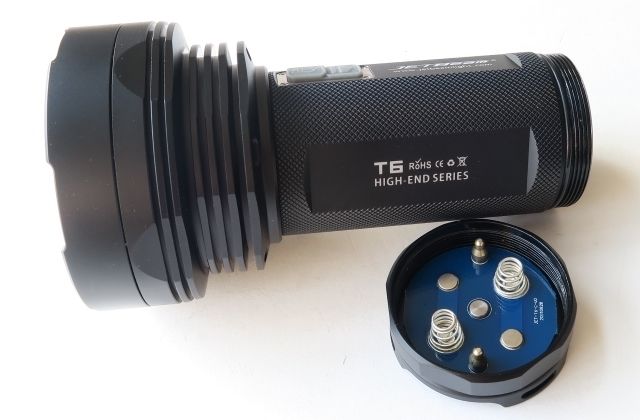

The hard (type III) anodizing is a matt black and consistent throughout with no blemishes or flaws on my sample. Labels are not as bright white (i.e., light gray) as some other lights, but those actually help to make them less obtrusive. The knurling is present over battery tube.
The light has no tail switch. Overall fit and finish looks very high.

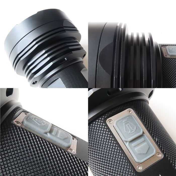

The light has 2 parts. The body is one piece with the head (i.e., the head is integrated into the body tube and is not removable). The light opens at the tailcap only.
The light has a shallow scalloped bezel. There are lots of cooling fins on the head. The light doesn't have anti-roll features on the head, so the light does roll very easily on its side. The dual-side switch is conveniently located right below the cooling fins to control the light. These are both electronic switches. The upper is the on-off and mode changing switch, and the lower is the flashing switch. The side switch cap is a silicone rubber. The switch cap is slightly protruded from the body. There is a blue LED indicator beneath the switch area between upper and lower switch. You can know the battery power from the blue LED signal.

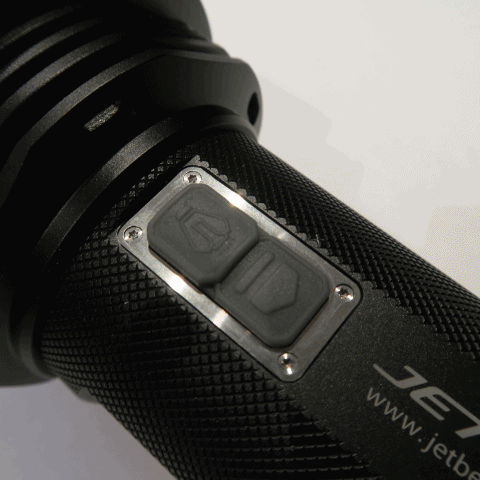

The switch has a good feel to touch and has typical travel, which produces a nice clicking sound when pressed.
If the power is above 20%, there is no blue signal. Slow flashes indicate that battery power is between 10% and 20%. Quick flashes signify less than 10%, and it means the battery power is close to depletion. In this case, you need to change or charge the cells.

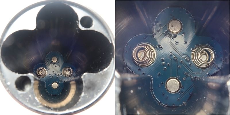

The light doesn't use a battery carrier, instead has cut-out wells for the cells. The cells are arranged in 2S2P. Half of the positive terminals of the cells are going toward the head. You can run the light on 2x18650 or 4x18650, thanks to the working voltage 8.5V.
Note that the small positive (+) battery contacts in the head are raised from the blue contact board. These raised contacts have a electrical reverse polarity protection function. [Edit 16.11.7] But true flat-top unprotected cells will not work in the light due to their short length.[Edit 16.11.7] The built-in cut-out wells do accommodate my longer and wider 18650 cells without any problem.
It seems there is a black thick C-shaped waterproof o-ring between the bezel inside and reflector. The light uses AR coating lens where the purple hue is reflected on it.

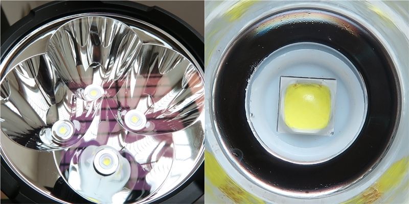

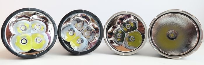

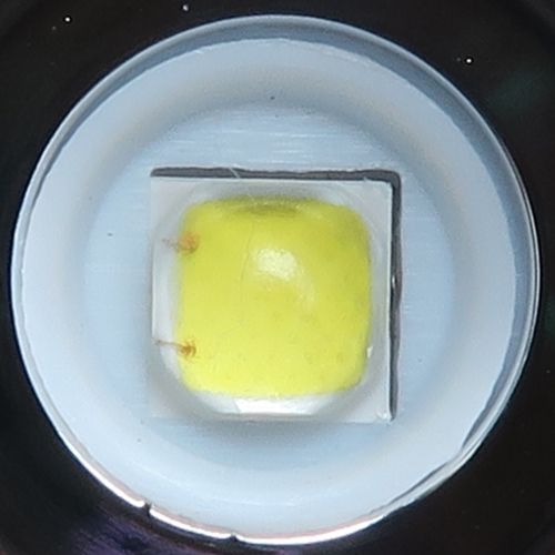

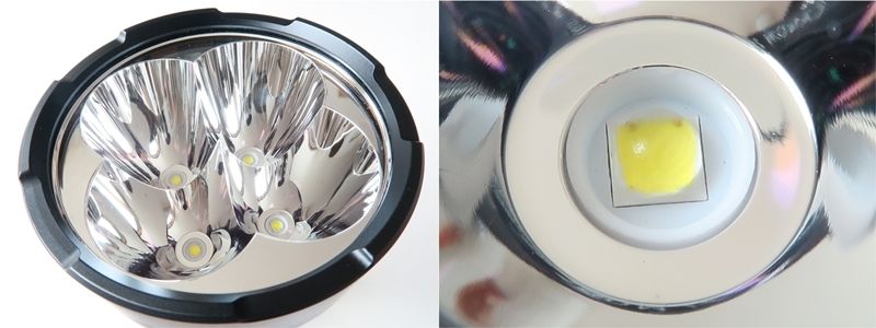

The T6 has a large head and uses four XP-L HD V6 emitters, each emitter is almost perfectly centered in its own deep and smooth reflector well. The reflector is well polished with no noticeable finishing flaws, but it's not aluminum.

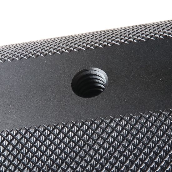

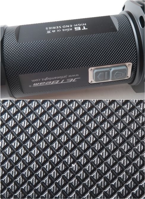

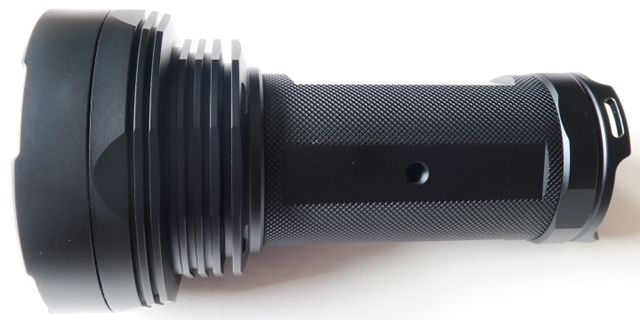

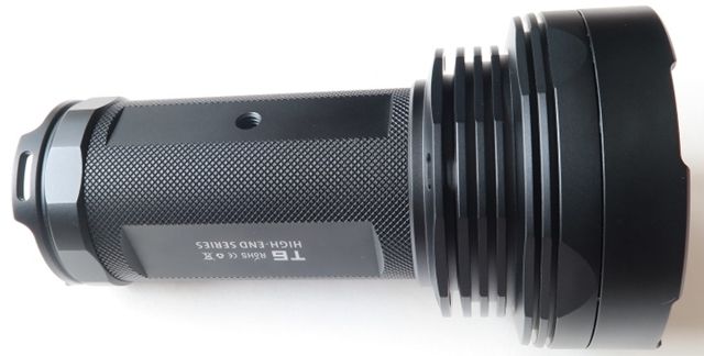

The body tube has knurling, and there are a reasonable number of grip elements along the body. Knurling is not so aggressive, but the grip is good. The cooling fins on the head and side switch on the body help further as well.
There is a tripod attachment point in the head (i.e., on the opposite side of the dual-switch).

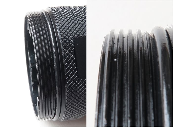

The screw threads are square-cut of good quality. Both male & female threads on the battery tube and tailcap are fully anodized, but it doesn't really matter since the current is carried through the PCB and contacts in the tailcap (i.e., not body wall). However lock-out is still possible when unscrewing the tailcap two full turns or more in my test. As supplied, threads are well lubricated. Screw threads action is smooth with no cross-threading or squeaking on my sample.

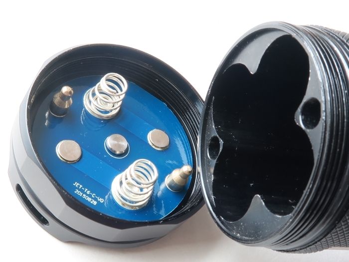

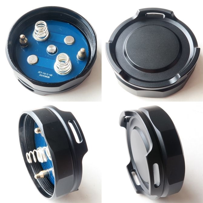

T6 features the rotating contact disc with body locking pins in the tailcap.
As mentioned above, the cells are arranged in 2S2P, with connection being made by contacts and PCB on a disc in the tailcap. This disc can spin freely, and locks in place to a couple of holes in the body that line up with metal locking pins in the tailcap.

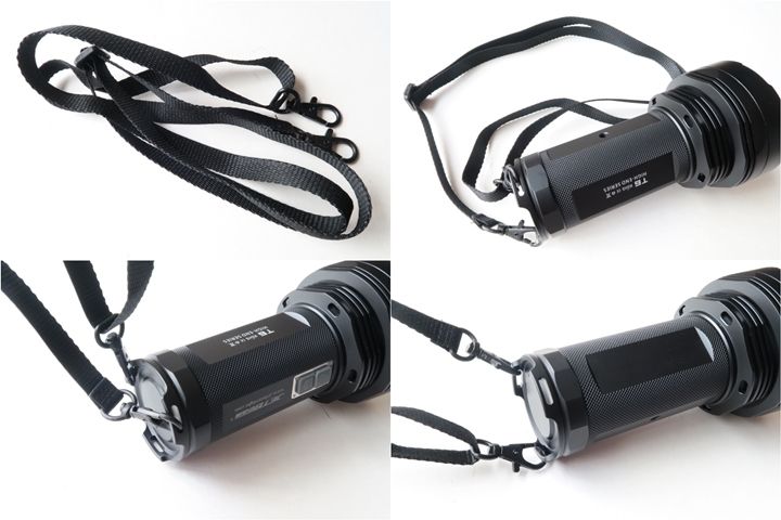

There are three shoulder strap attachment points at the tail end. The light can tailstand stably.

On-off and mode switching are controlled by the upper switch and flashing mode is controlled by the lower switch.

I didn't think I would need the bundled shoulder strap. But with the light, the shoulder strap pretty increases the light's usefulness.

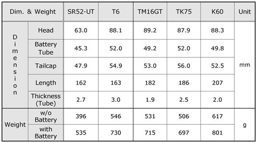

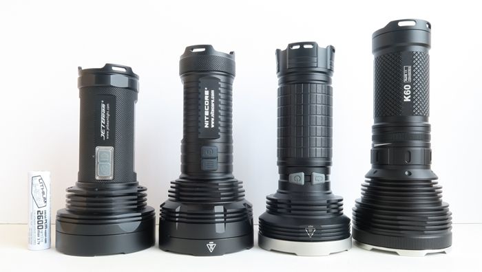

From left to right, VicLite 18650 (2600mAh) protected, Jetbeam T6 (4xXP-L HD V6), Nitecore TM16GT (4xXP-L HI V3), Fenix TK75 (3xXM-L U2), Acebeam K60 (XHP70).
From left to right, Jetbeam T6 (4xXP-L HD V6), Nitecore TM16GT (4xXP-L HI V3), Fenix TK75 (3xXM-L U2), Acebeam K60 (XHP70).
Measured Dimensions

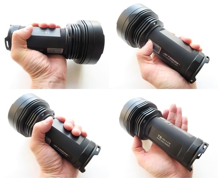

The gripability is good. The build feels nice (i.e., large head, but not heavier than expected), and I find handling & balance of the light is good. Overall build quality is very high.

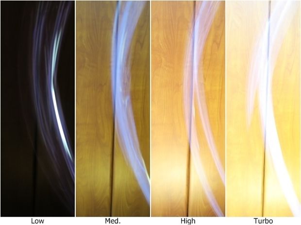

PWM
The light shows no sign of flicker by PWM at all output levels. I notice there is no buzzing sound at any levels. The light is current controlled.

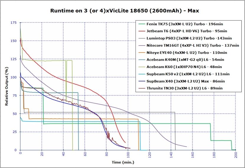

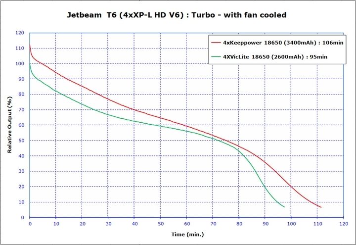

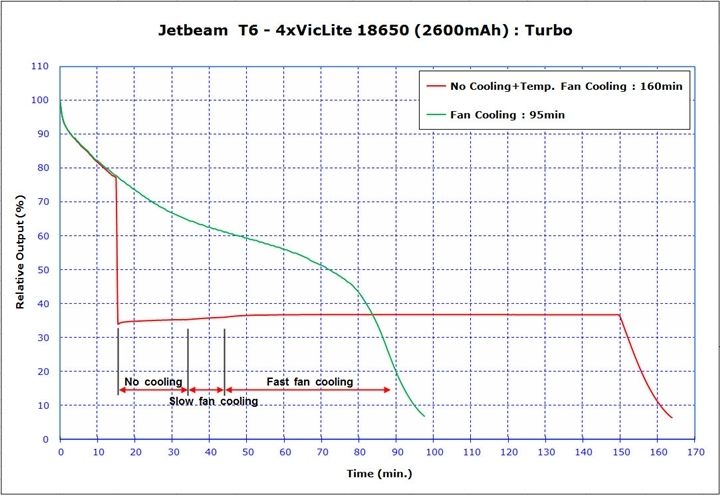

Runtime
The runtime to fall to 10% of its initial output from 30 seconds after the point the light is first turned on (i.e., based on ANSI FL-1) for Turbo with fan cooled is as above graph.
T6 has a built-in thermal sensor which is a nice safety feature for the high output light. There is no thermal step-down on Turbo, thanks to fan cooling during testing. Instead, fan-cooled light is semi-regulated on 4x18650 (i.e., slowly drop in output) as the battery drain or near exhaustion.
You will not be able to notice the drop in output over time in practice. It's quite acceptable for the class using 4 cells with 4xXP-L HD LED. As expected, higher capacity Keeppower 18650 (3400mAh) gives you both longer runtime and higher output for an extended runtime. Overall output-runtime efficiency seems good.
This is a comparison with cooling and temporary fan cooling to see how the light activate. The lack of cooling make the light step down sharply after 15 mins of continuous runtime. I turned the fan on with slow (i.e., very mild) cooling for about 10 mins. But, this only cause the output to start to rise very slightly. Then I let the light cool down with fast cooling for the rest of runtime. This doesn't make it come back on to original Turbo output. That said, the T6 will not recover Turbo output level once the T6 step down. This feature is similar to the Nitecore TM16 GT. The regulation pattern and runtime efficiency of the light seem good.
The output and runtime efficiency of the light seem good.

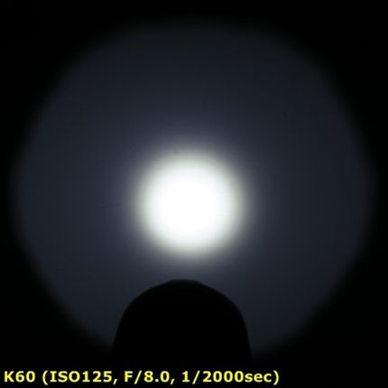

Beamshot

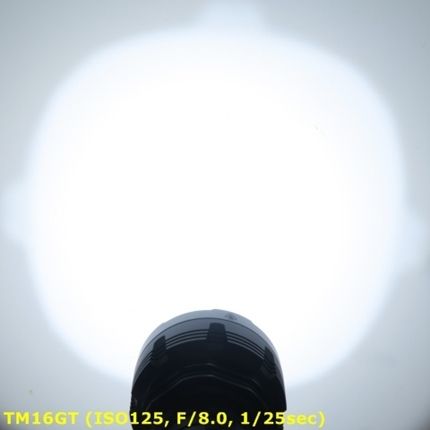

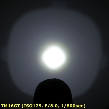

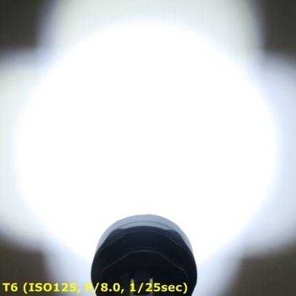

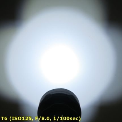

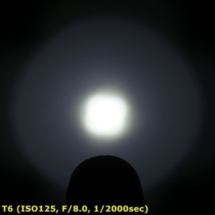

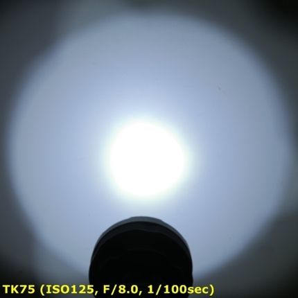

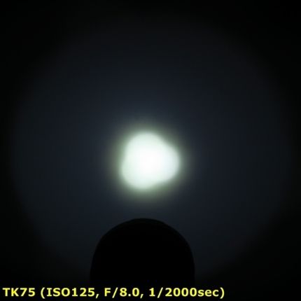

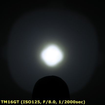

1. White door beamshot (about 50cm from the white door) on max. output on 4x18650 (2600mAh) VicLite protected cells
- ISO125, F/8.0, 1/25sec, Auto white balance
- ISO125, F/8.0, 1/100sec, Auto white balance
- ISO125, F/8.0, 1/800sec, Auto white balance
- ISO125, F/8.0, 1/2000sec, Auto white balance
The T6 shows artifacts in the spill beam area due to the overlapping reflector wells. As you know, it depends on what distance you use the light. Beam pattern is similar to other multi emitter, hight output light in this class. A corona surrounding the white hot spot is slightly greenish yellow, and the spill beam shows slightly blue tint. The overall beam tint is in between cool white and neutral white. Both T6 and TM16GT show very similar beam tint.

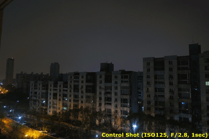

2. 7m Indoor Beamshot on max. output on 4x18650 (2600mAh) VicLite protected cells
- ISO125, F/2.8, 1sec, Auto white balance
3. 85m Outdoor Beamshot on max. output on 4x18650 (2600mAh) VicLite protected cells
4. 120m Outdoor Beamshot on max. output on 4x18650 (2600mAh) VicLite protected cells
The T6 is not an outstanding thrower, but throw further than expect. The beam shows good balance between hotspot and spill.

You need protected 18650 cells to turn the light on. Sorry about that again. brighterthanthesun!
