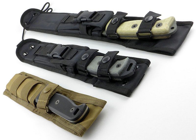

The Ontario Knife Company Black Bird SK-5 review is the third of a three-knife review series featuring the Black Bird SK-5, RD Tanto and RTAK II. (See - OKC Group Review.)

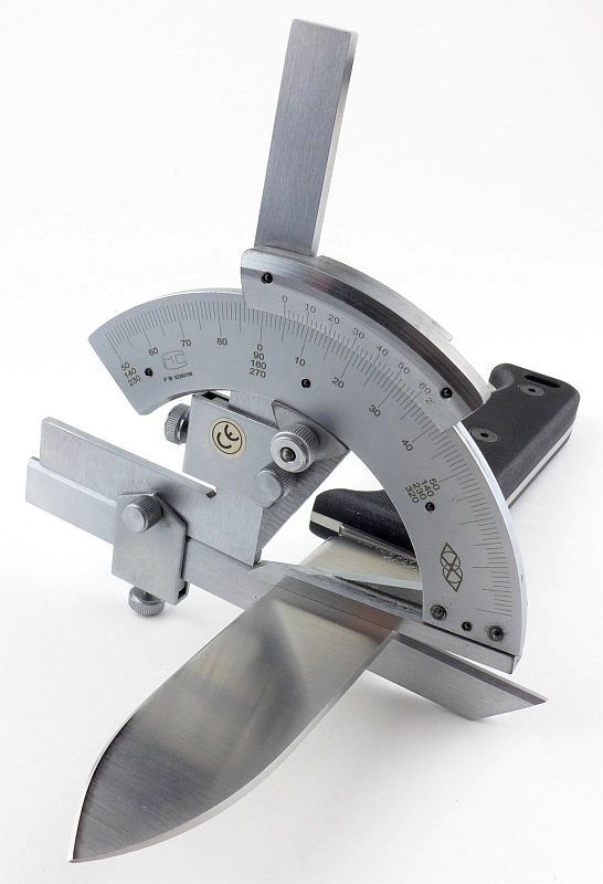

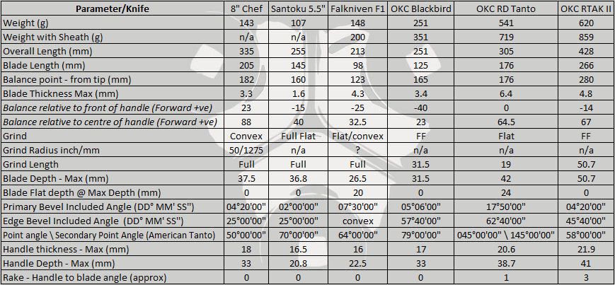

Most knives specifications have a basic description of the blade geometry, but in this section I will be taking a more detailed look at geometry and balance.
Using a set of gauges and precision measuring equipment including a Vernier protractor, callipers, fixed radius gauges and the unique Arc Master adjustable radius gauge (the one that looks like a crossbow).
These measurements have been tabulated and are presented along with a few reference blades (8" Chef's Knife, 5.5" Santoku and the popular Fällkniven F1).
Key aspects such as the primary bevel angle, grind type, blade depth, blade thickness, length, weight are detailed, along with balance information.
The 'Balance relative to the front of the handle' tells you if the knife will feel front heavy, or if the weight is in your hand (a positive value means the weight is forward of the front of the handle). The 'Balance relative to the centre of the handle' indicates how close to a 'neutral balance' the knife has in the hand.
In the case of full convex grinds the approximate centre of the grind is used for the primary bevel angle estimate.
The blade is made from 154CM steel.

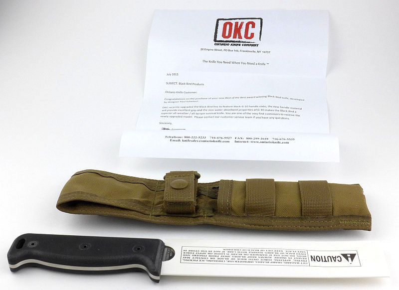

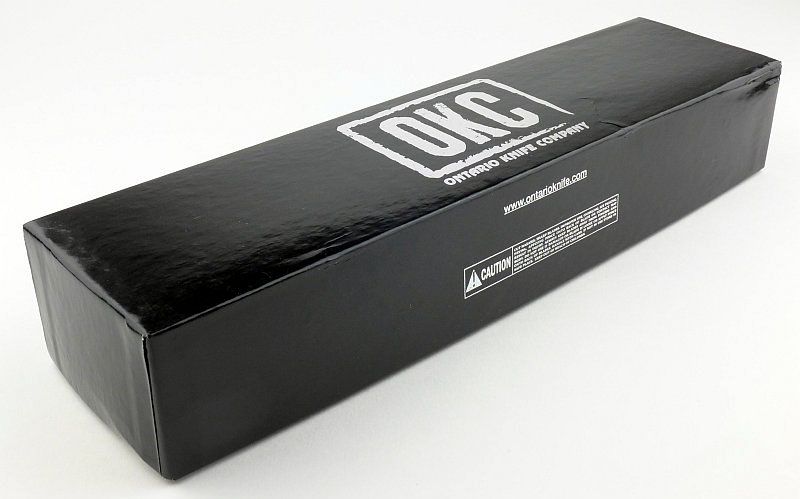

Just as with the others in this series, the Black Bird SK-5 comes in Ontario Knife Company's standard knife box.
Inside the box the knife has a cardboard protector over the blade, and the knife is not fitted into the sheath. There was also a letter explaining that this knife had upgraded G-10 handle slabs.

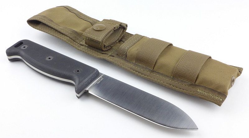

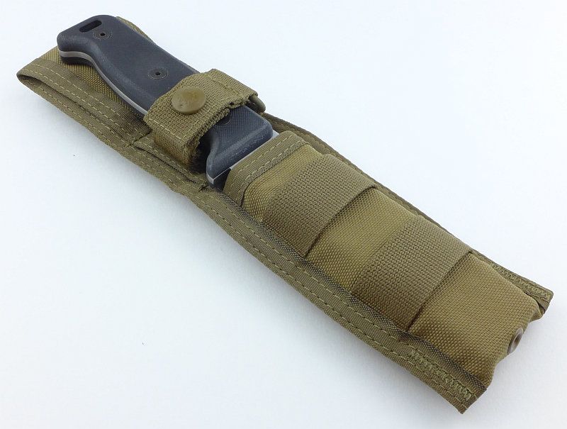

The first proper view of the Black Bird and its sheath.

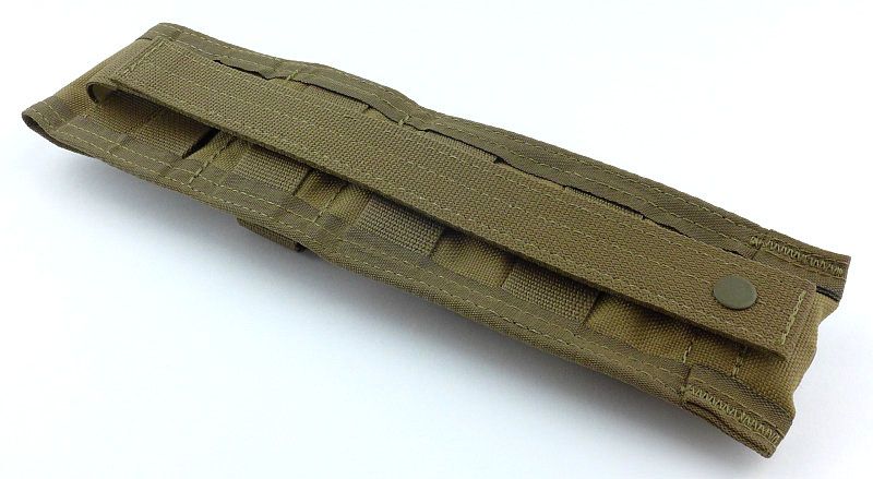

Before going back to the knife, a quick look at a few details of the sheath. On the back, the sheath has a PALS/MOLLE strap for mounting on a pack, vest or load carrier.

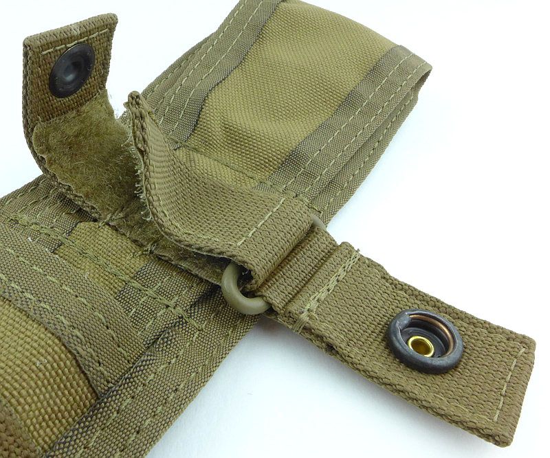

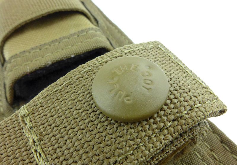

The press stud used on the retention strap is a military specification type where you can only release it from one direction.
It is possible to change the fit of the retention strap using the Velcro adjustment.
Inside the sheath is a felt liner.
As well as there being PALS webbing on the front of the sheath, here you can also see the drainage hole at the bottom to allow water out.

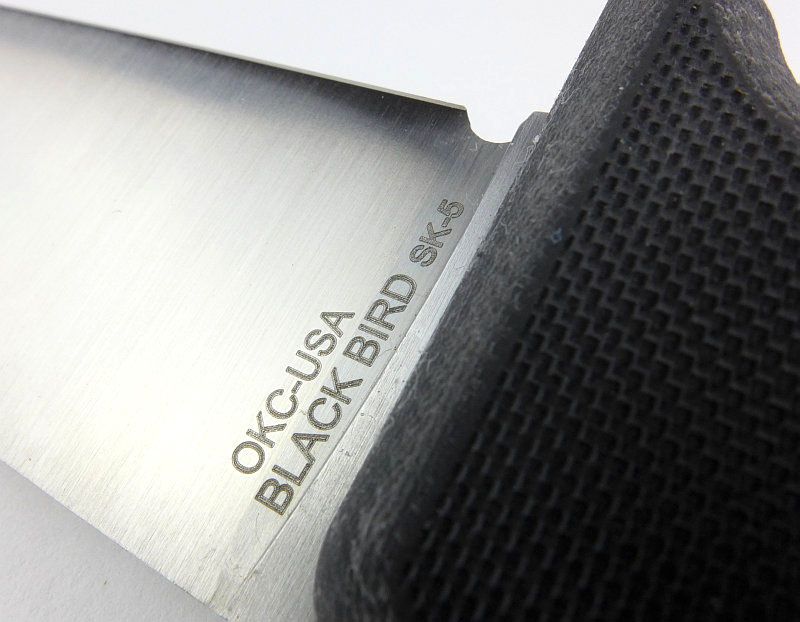

Back to the knife and its details. On one side the maker and model are engraved on the blade near next to the handle.

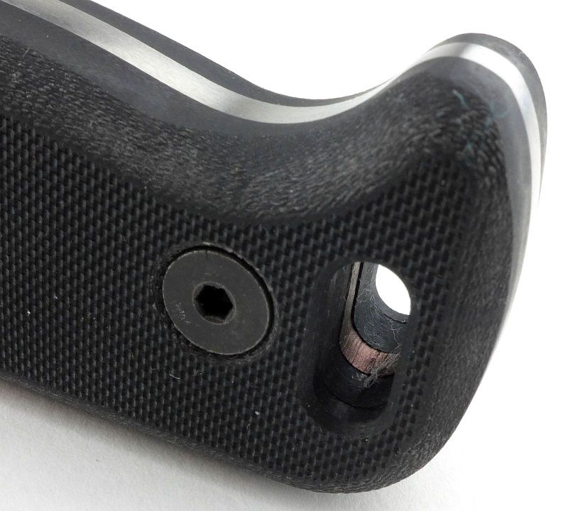

There are three details I'd like focus on in this photograph:
- The generous lanyard hole allows for easy fitting of a lanyard.
- Inside the lanyard you can see evidence of the water-jet cutting and slightly imperfect fit of the handle material, but on the outer edges of the handle and blade tang have been ground to a smooth finish.
- We are looking at the handle grip hook which gives plenty of purchase for all tasks.
Although the handle slabs are flat sided, they have been well rounded to remove sharp edges. Three bolts are used to secure the grips.

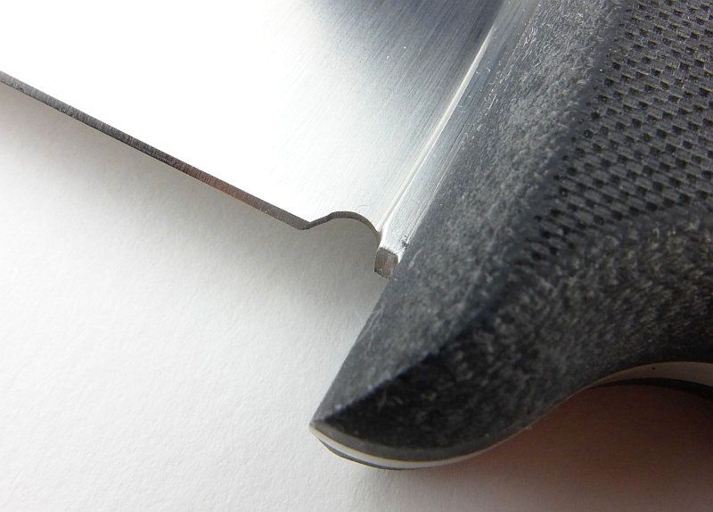

One of my personal preferences, a sharpening choil.

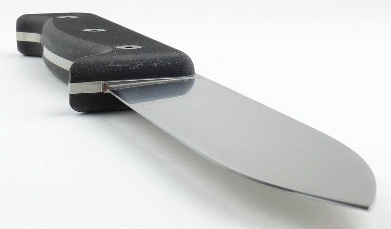

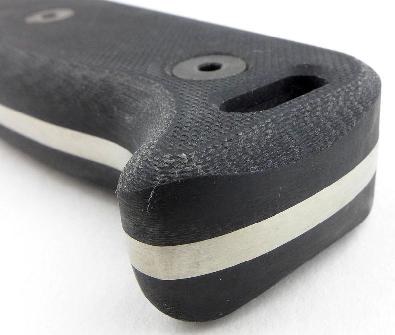

As mentioned earlier, the handle slabs and blade tang are ground/sanded to a completely flush fit.
A sharp edge is left all along the spine meaning you can strike a ferro-rod from any part of the spine that suits you.
Though not a mirror finish, you can see the reflection of the handle on the blade flat so you could use the knife for signaling.
Unlike the other OKC knives in this series of reviews, the Black Bird's sheath has only a single retaining strap. There is enough room for the knife to come about half an inch out of the sheath with the retaining strap closed.

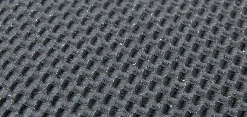

For the last photo in this section, we have en extremely close view of the peely-ply G-10 handle texture.

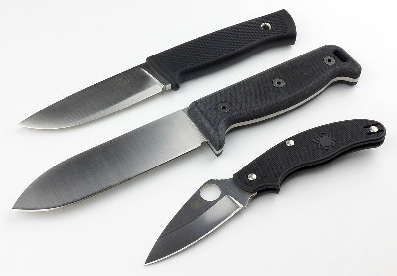

To give an idea of scale, here it is next to the Fällkniven F1 and a Spyderco UK Pen Knife.
At 5", the blade is half the overall length of the knife. Combining this with the full flat grind and full tang, even though the blade is 5", the balance point is brought right back into the hand (see 'The Blade and Handle Geometry:' section), and this is the reason it feels light and easy to handle.
With this blade length you still have great control over the point and enough length to make batoning easy (if you need more than 5" to baton, you should probably choose smaller wood or be making wedges for splitting instead).
