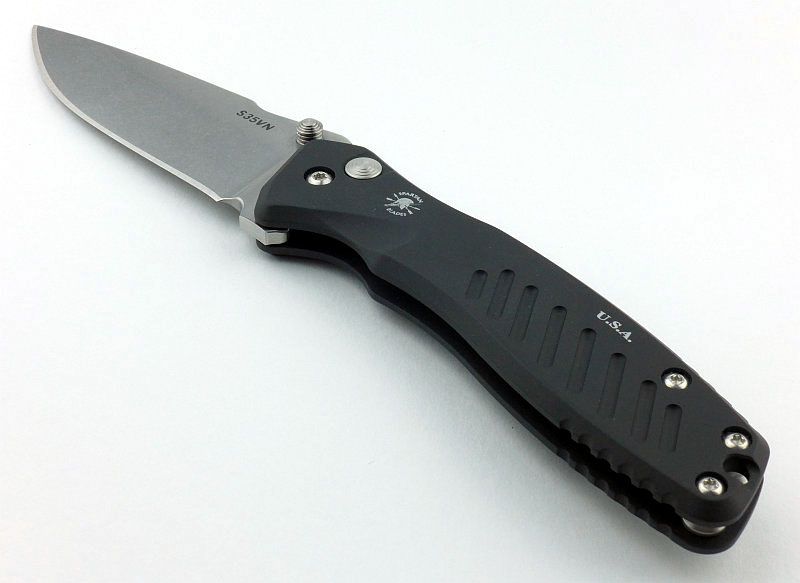

Fresh out of the box, the Pallas.

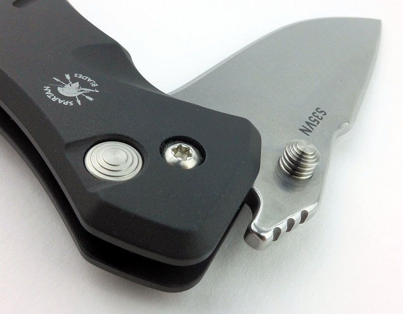

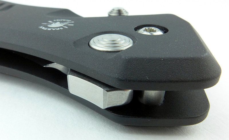

Straight in for a look at three key aspects of this knife, it is made by Spartan Blades (with the logo engraved in the handle), there is a button lock, and the blade is S35VN steel.

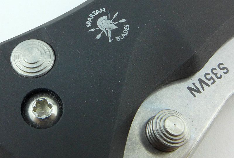

Closer still to the stainless steel button.

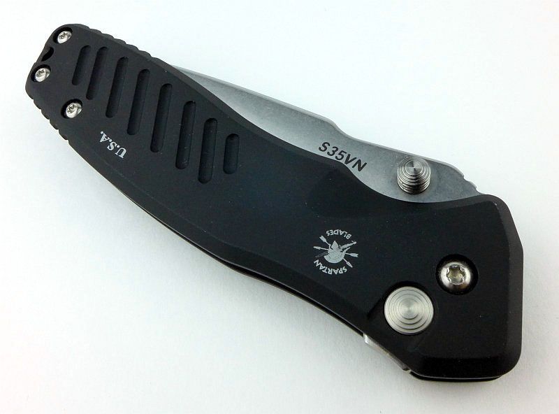

Despite an overall flat cross-section, the Pallas is full of curves that make the design flow and provide its ergonomics.
Note the deviation from a standard Pallas in the there is no longer a flipper tab on this special UK version.

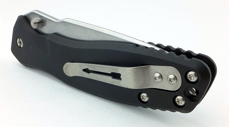

SpartanBlades' signature titanium arrow pocket clip.
The pocket clip is one sided and cannot be fitted to the side with the lock button.
This is where the flipper tab would be on the standard Pallas.

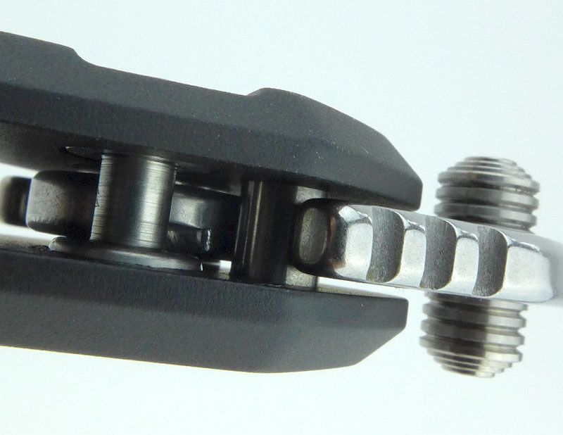

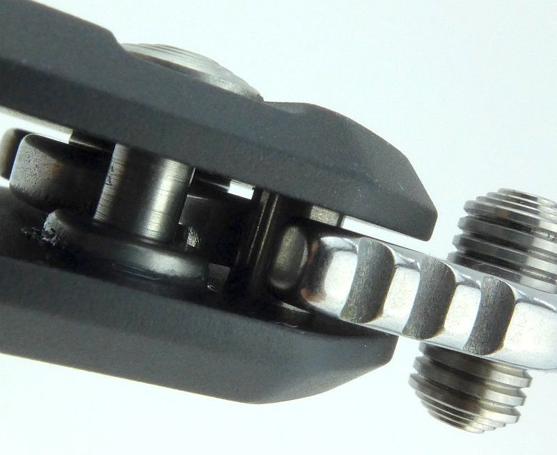

Button locks are far less common in non-autos, than other locking mechanism, so warrants a closer look. Here the blade has been opened slightly to allow the button and its shaft to be seen.
Viewed from a slightly higher angle you can see how the button has been pulled into the handle as the blade starts to open.
With the blade a little further open you can see the locking notch in the blade into which the button engages. You can see it is just to the right of the blade stop pin.
The blade is now nearly fully open and the locking notch has nearly reached the button.
And fully open the button has locked itself into the notch in the blade. The blade has also hit the stop pin and is firmly wedged between the two.

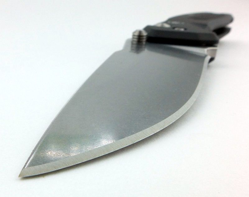

when looking closely at the blade tip you can see the contrast of the crispness of the final edge bevel and the rounded blade spine.
The entire blade surface has a stonewashed finish.
Not quite a full flat grind, the Pallas blade is a high flat grind.

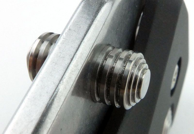

Each side of the pivot bolt is different, with a nut on this side.
And a torx bolt head on the other side.

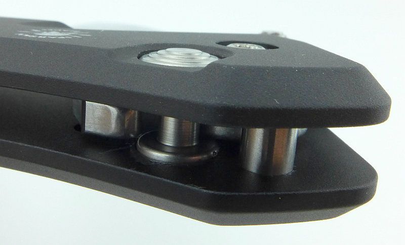

Though they look good, the handle spacers are also a very practical design with wide flats where they contact the handles and a slight waist which will reduce weight without any significant loss of strength.
You can see straight through the handle with the three spacers one end,and the blade pivot at the other.

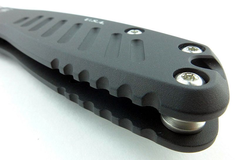

All the edges of the spine are nicely rounded. So you won't be striking sparks off fire-rods, but you also won't be fraying your pockets.
There is a little jimping for your thumb where the blade meets the handle.
Each side of the spacers are held with torx bolts, as is the pocket clip.

At the butt of the knife handle, there is jimping top and bottom giving a surprisingly useful amount of grip. I'd also take this opportunity to point out the surface texture of the anodised handles. There is a matt finish to the anodising due to what appears to be an underlying bead blasted surface.
Grooves cut into this side of the handle provide grip where your finger tips press onto the handle. Subtle and effective.

Lastly for this section, a close-up of the thumb stud which looks crisp and precise, yet without any sharp edges on the thumb contact surface.
