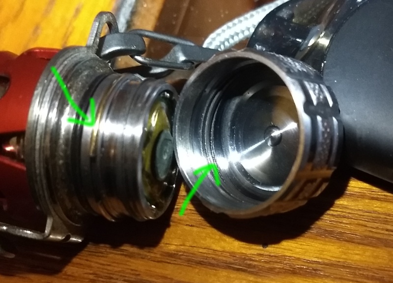

I stand corrected (about the design part).
Here ya go Pete
The brass looking "C" clip holds the light in the groove shown to the right.
I forgot I had accidently removed mine one time. I just twisted until it came off (not knowing any better).
Note, mine is a prototype so the Knight may differ.
Just thread it back on like normal
Here ya go Pete
You must be an ox. Or have the strength like one. I'm trying to twist it off an it's not budging. I even have some pieces of rubber on the body and tailcap for extra grip and it still won't come off.

I had a good try at unscrewing it this morning - no dice.
Also tried with wrenches and it didn't budge, still it's beaten up enough now for me to find a way.
Maybe PK will have the answer....
P
peter yetman
Mar 23, 2014
5,100
North Norfolk UK
Yes, I'm sorry, he did.
He explained that the tail is held on with a stainless ring and is not designed to be removed. However he said that someone had managed to remove it, but he doesn't know how. He also sent me a useful scematic of the body and tail.
I got a bit rough with mine the other day to no avail, apart from scratching up the PVD coating. I've now jammed the tail in the on position and doing the on and off with the head. That works fine for the stuff I need it to do.
