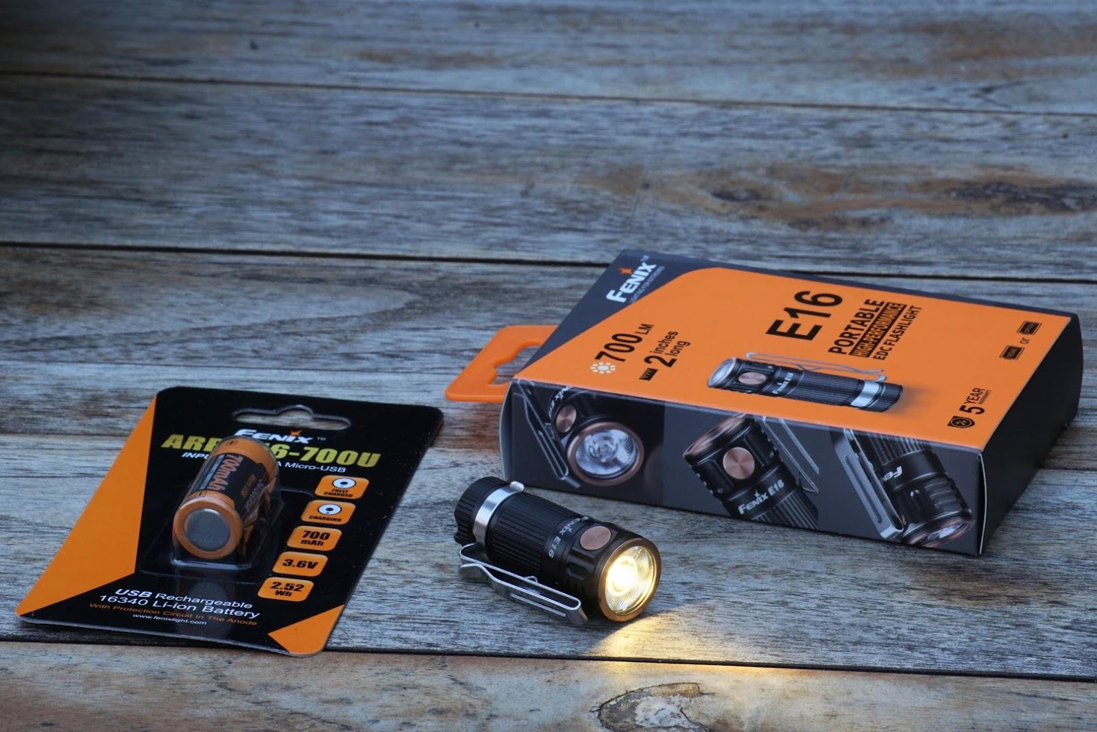

The Fenix E16 is packed in a good looking in mainly orange and black. Looks good; on the box we see the E16 back and some applications on the sides. It's a kind of showcase: The light is hidden behind a window that is covered by a flap. Opening the box takes some effort and a tool; unfortunately my box tore out. I hope that Fenix will find a solution for this is future. As you can see on the photos, my light came including a 16340-cell that can be charged directly thanks to the built-in micro usb port. Many thanks to my local dealer knivesandtools! In the box, we find back the E16, a clip, some spare o-rings and a lanyard. A holster is missing. Further we see a manual en some leaflets. Sufficient for most users, but I'd recommend to order it including the optional battery. Below some pictures that show the carton in different positions and the contents.
I got the E16 including the recommended battery, the ARB-L16-700U
yPtjMioBETd1SwdVEW12gDpcDvTLehoV57qF6YTAY-ez26OPOTvvjQWXCt7MLpWDAwImrsVLv-BYoByc_mDdl6NyqKlCfY0ae2RF64fRmZ3sljX6YusJEfaEuA-dMTSUod48VZhK

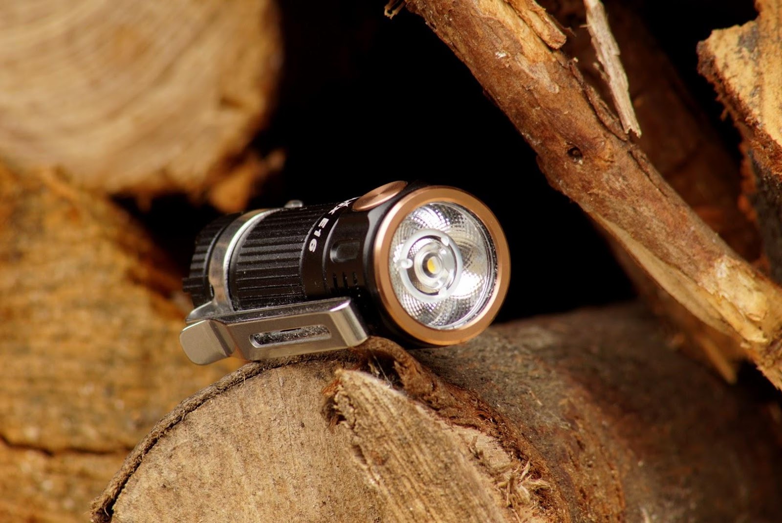

First impression: Really a nice Fenix baby-light! The copper / golden accents on the E16 give the light something special. I really like the looks of the latest Fenix-generation! This thumb-sized flashlight feels the same like his (large) members of the big family. Fit and finish are very good. A stable torch that hasn't sharp parts anywhere; anodizing and engraving is done well. This tiny one stands very stable both on head and tail, but looking at the design, that wouldn't be a big surprise.. Thanks to the hexagonal head the anti-rolling design is very good, even without the clip. The clip can be added at one way. The body has knurling, but the grip could be better in my eyes. There a cut-out in the tailcap with a hole to fix the lanyard. Adding the lanyard took some more time, because of the small hole. The E16 has a fairly small but metal switch in the head. The golden edge on the lens gives an exclusive appearance to the light. I never saw a lens like the E16 earlier on a Fenix torch or someone else: A shallow reflector with a special "TIR-design" and orange-peel structure that will spread the beam and give the E16 a smooth profile. This idea is not completely new, we saw this already back at some other brands, but not exactly like this. The XP-L HI led is perfectly centered and luckily we find back a glass lens here. The "CE" letters on the lights' tail affect the nice design in my eyes, but mentioning this mark is probably mandatory. There's a magnet built-in the tale, that can't be removed. By opening the E16 (just under the lights' head), we notice that the threads need some glue to expand the lifespan. But that's not a big issue, the threads are machined well. Looking into the head we see a gold-plated contact and a "plus"-icon. A spring in the tube protects against shocks. The body's layer is rather thin, but strong. Overall I can tell you that the E16 looks and feels like a durable and stable light and that the finishing is done at excellent way. Please scroll down to watch a couple of photos that show you more details and close-ups of the E16!
thumb-sized, barely larger than the recommend battery: the Fenix E16

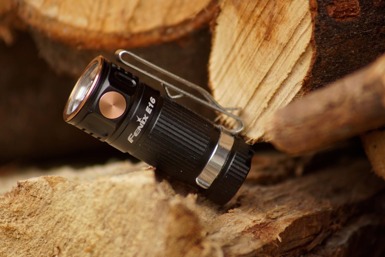

stylish baby flashlight
njUCU7swB5lwDpSrSuF3HWwCiLWS1ahSZRUT5AnLrDXvX9V66maMu39hsC6V9GCiKNsEF1CparfTxn3pOH0Y4P2Tu19zVHBoQ_RNMv9ca7RYYPPCclnktt7y8lRP8ewdUeiQbc2o

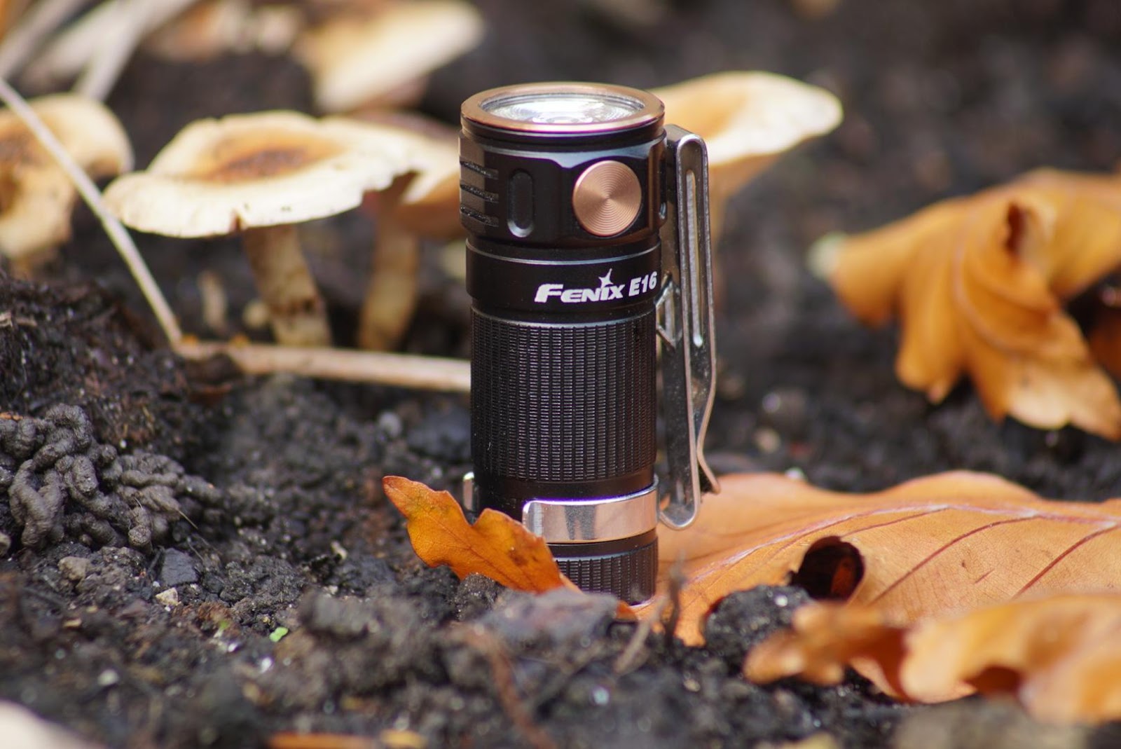

excellent job on anodizing and engraving

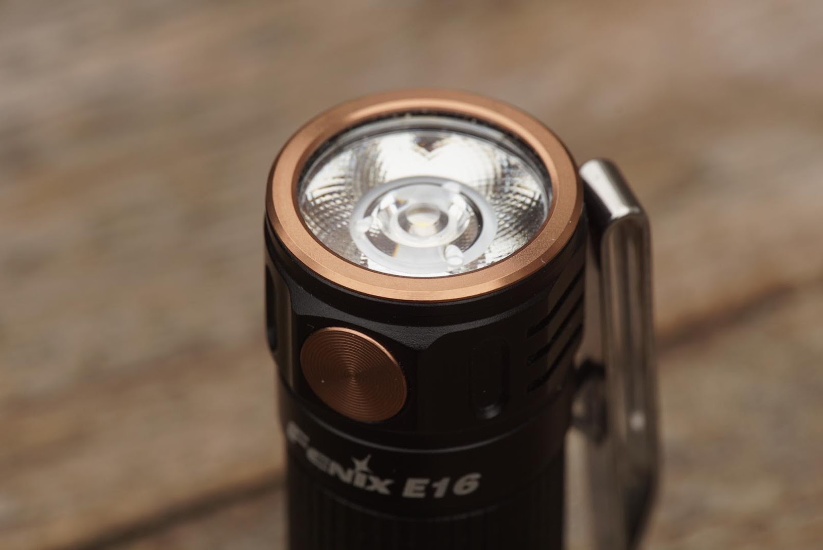

nice accents on the head
IK2oOvi_87mphQTu3F8lBU_Ejx1eDl0FYp21Q1RYj5hLyLjkiSXHZgkCqBbLQ1HyW5aLnsIXHgyaEvQC7lAaFvPQuEOhvIdkUGtpnnfk18Q-JcTOcW4Ar_-X2KDOsSSoS_nbfi3C

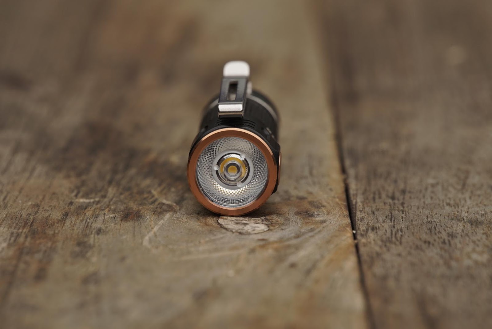

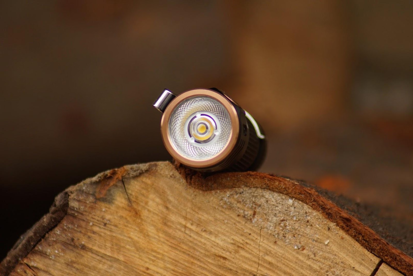

perfectly centered XP-L HI-LED and orange peel-reflector
a8N9vi8XrN9FyZh_056HZFRUgqLsOO4cHDL8vkqr4GUHgtXMwcxpoLqR4K7lU28QLmZ9iHs-c84DkhRioSFRRYowM-thB-cYblXLjasjq_eF_OV6DvQ1IZa1fBQ81I6am4W3R-Av

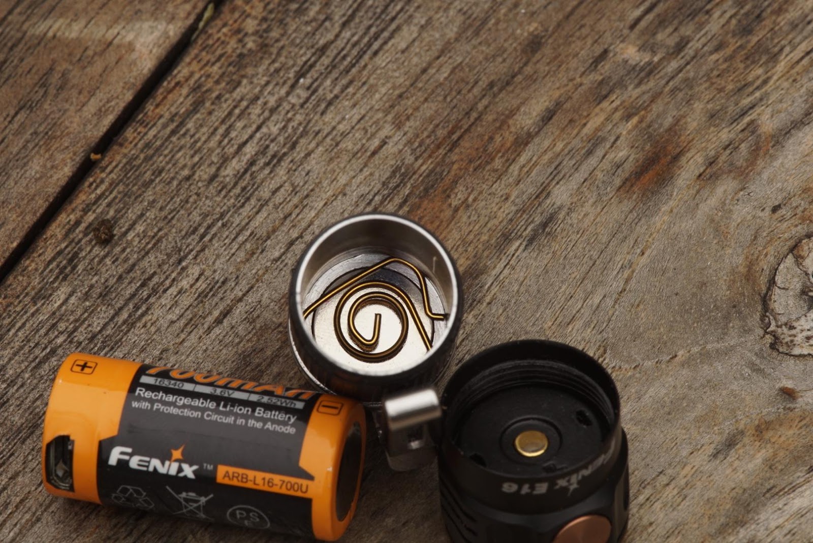

a spring in the body protects against shocks

the color of the led shows that the light will have a neutral / warm tint
WJLFFQa2cw0ApYunnOV-M-60hcoGbC5CqRT0OGGqNt3BHFVnKyTBE5ZWNndvudtdiE37emDHkOzw1HYpCNrhsmveRWTol3QSARLg5D_z4WMSVlF074VninvJ64Nv69gPLYidcnqv

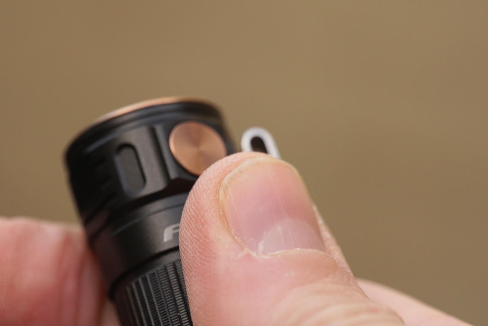

the switch is (too) small for an average thumb

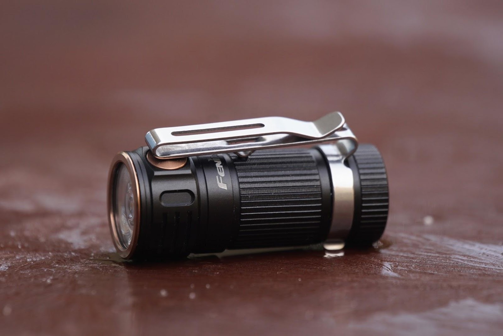

compact with such a nice design

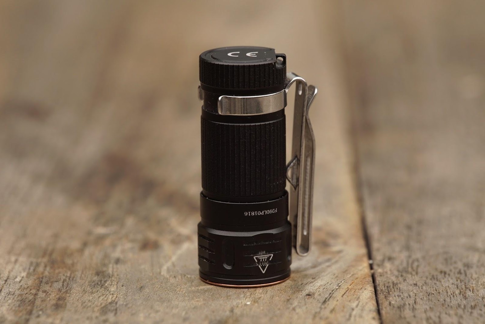

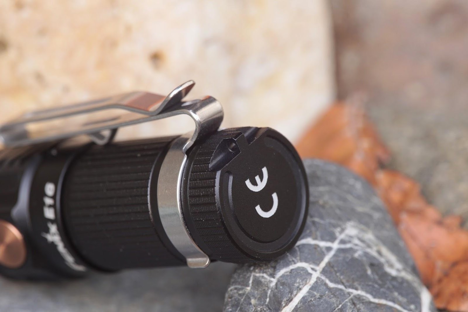

the back with built-in magnet and CE-mark
a14Lh1KtyXIW1HsPQq6U8ZZ6kFxonufYNvho3fpranatAgY_caRqqLjrwdn35ebMVkZUQTn0arLXsMagxz8rPYe2lpUlrfdyqspUu4aOcio-70q5oSDk9Cm5nIL3KAsSoB30gmUs

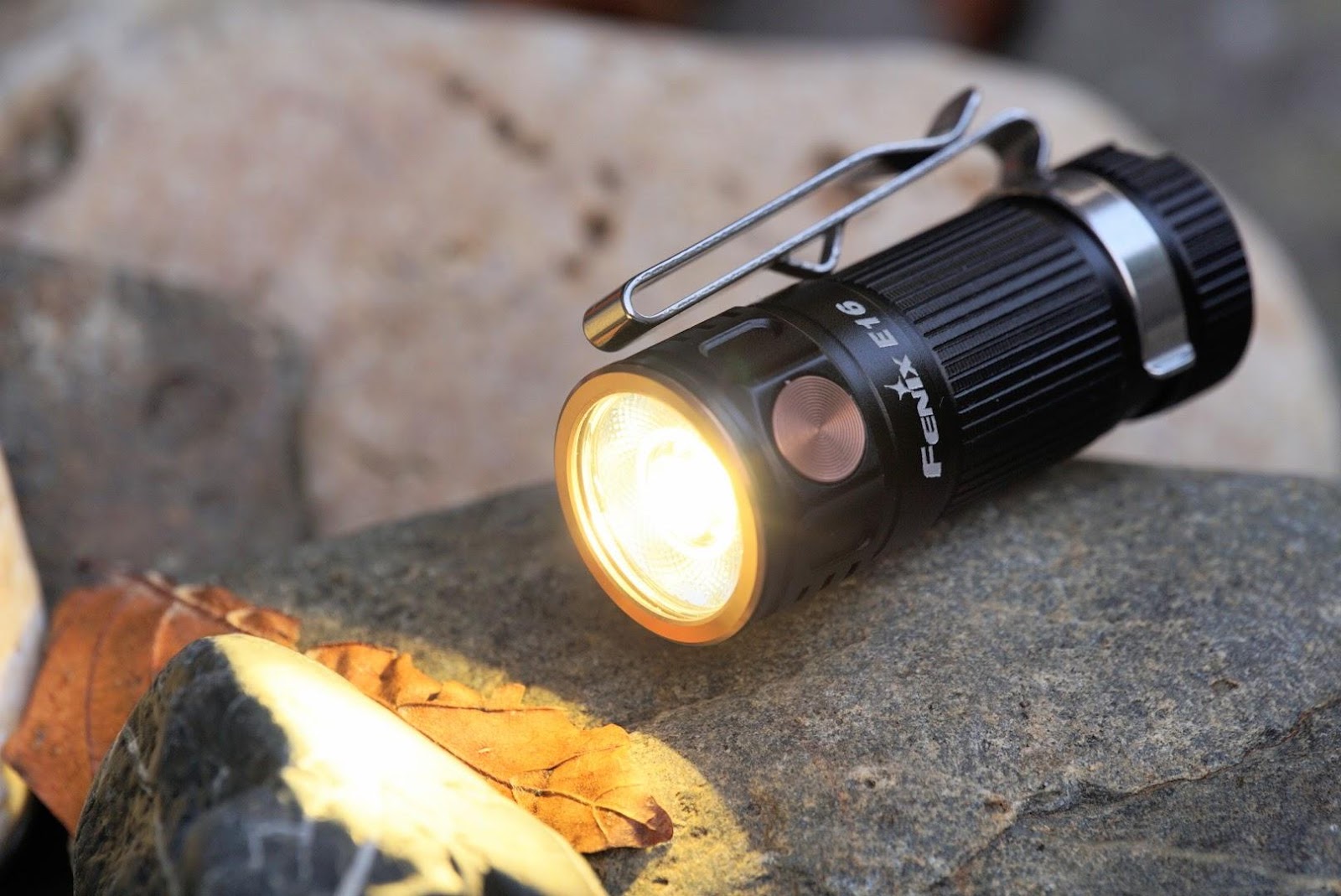

up to 700 lumens in a thumb-sized torch!

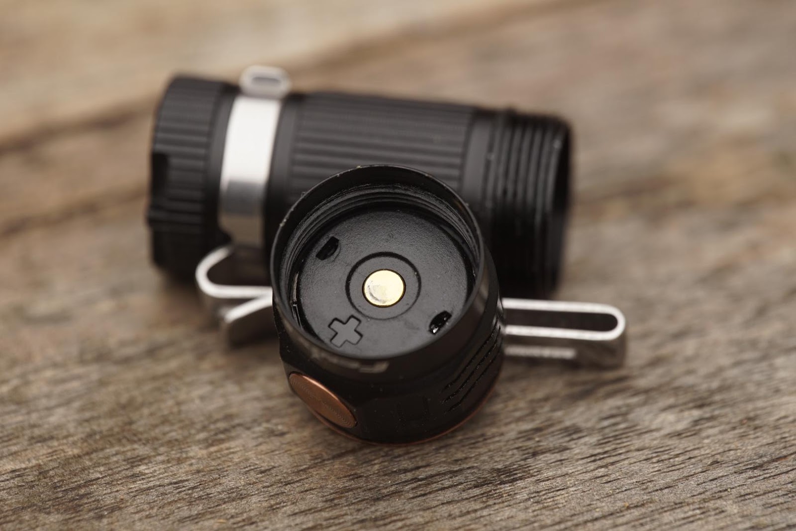

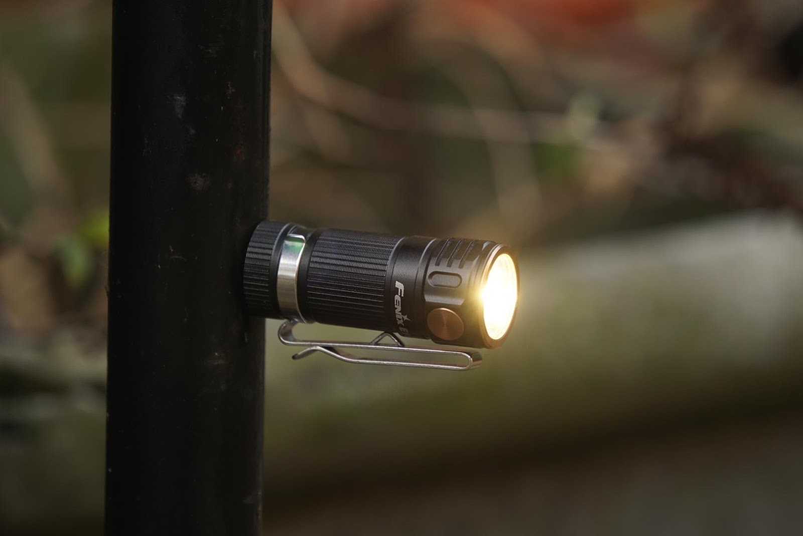

hands-free working thanks to the magnet in the tail
vApVQ2nhvhY2cqsPUUBb2i96rW78G0-SVvlQ4idhHrnJzCs7cZsVcdpkRWEYJ7shIcI9jKY-lXCa_cKSpjnUjJDkzt7BMF1BxDdzlPohbPsKvhnnrhkmuPYhaMRKmGO1iMdaV2iG

The E16 must be controlled by your thumb. To me, the metal side switch is too small; it's hard to locate in the dark. At my dealer, I tried out the slightly larger Fenix E18R-brother, that has a better switch to me. But I found a solution for it: I positioned the body-clip next to the button, so that helps me to find the switch in the dark. Works well to me!
To turn on the E16, you have to press down the button and hold it for about a half a second. The light has intelligent memory circuit, so it start in last used mode. When on, you can cycle through the four levels by short clicks. Turn the E16 off by pressing and holding for 0.5 second again. Works stable and without issues. The strobe, the only special mode on this light, must be activated by pressing and holding the switch for about 1.2 seconds. Not too long in my eyes, this mode is needed in case of emergency. Good point is that you can activate it directly, no matter if the light is off or on. Keep in mind that the light will turn on for short time from off, and shut off for a split-second if it's on when you activate strobe. This can't be fixed another way with a "one-for-all" switch. Another option that you need the button for is the lock-out modus: Quickly press twice to (de)activate it. If the E16 is locked the light will flash two times slowly to indicate this. Fenix has designed the clip that that way, that you can "cover" the switch with it: This is the second (physical) option to lock the E16. A good option that I really like. Third way to unlock is release the lights head by a quarter turn: This has been my favorite way during the testing period.

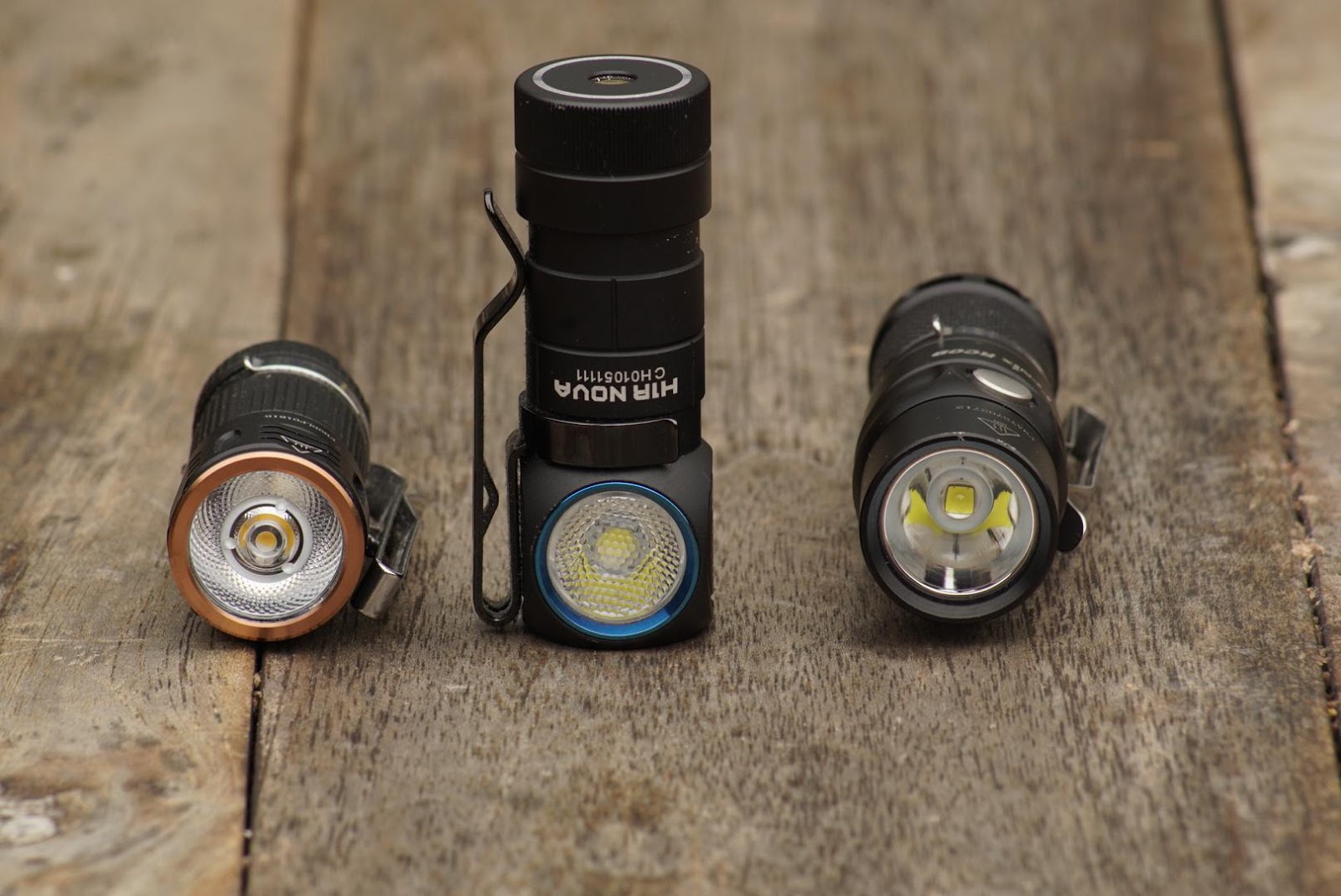

Size comparison:
For comparison I picked some lights out of my collection that run on the same of an equal battery. The pictures show again how compact the E16 is. I used these three also for my beamshots; I'll show you the results later in this review!
16340-cell, Fenix E16, Olight H1R Nova and Fenix RC09
hsTyxFWiLQgRycsFiqBJ6ORvgKtQEunguSmQsc49iF99QueopmU1vVsKvHi35b7vKJB52fEXbl3DD9oyt9h21kQQtN2oyaQV7eAIt7MqReAATzb1tsVom4_yeCFEf90f8jdwpvAH
9DUzoi1gqost-As12ruBOa2r6kX_SnDgS4d9j6CFNhc41t9i58jX7w6NWBbucQ6_sZnCB8op0I0sdRfWB2PzyxeLMuCNkbVKzSUt6rhByFWTm8sqz-GZcKAp_2W-lsClxHXJZK6F
QG0cFVFYNi02Nk1aCLvXbHHNHE8-AewwFAfVM0p0zdELgeCIcz55hi_4qrKgSCyITTUQRGrhRgtTOoR4vksvdUjvUj6yJ0o42fNBa6i9U_OlfNPrACUSWQiPnqU9xtuH1AptPZlU
the heads: XP-L HI, XM-L2 and XM-L2 (U2)
Al56o85RnG6UD0wJGPUmhF2hSgkziy5UhuWn3OIWyFIH9WE2mqI8dHVfAz0gLP_zaAURsUEtCA31IzV0zcky0YZWZhmSZ-7h86kujBY2Hsj_V8lerzJ3vjBYYzWSEE-MiEEx96tL
the tails: Fenix E16, Olight H1R Nova and Fenix RC09
V9zjZZWHmTiHb5Iz8DtFCsJ7ej73r0OPFfmdlyABeDzhMsgRxdPTd1nr8v3ypCg6pEhkSPv5HychlIkS_5iyQyEPfkT2x7FkV0hpwUUyX9dKQDPs9SH2YrDfZpY3tcXokgAXzSPI

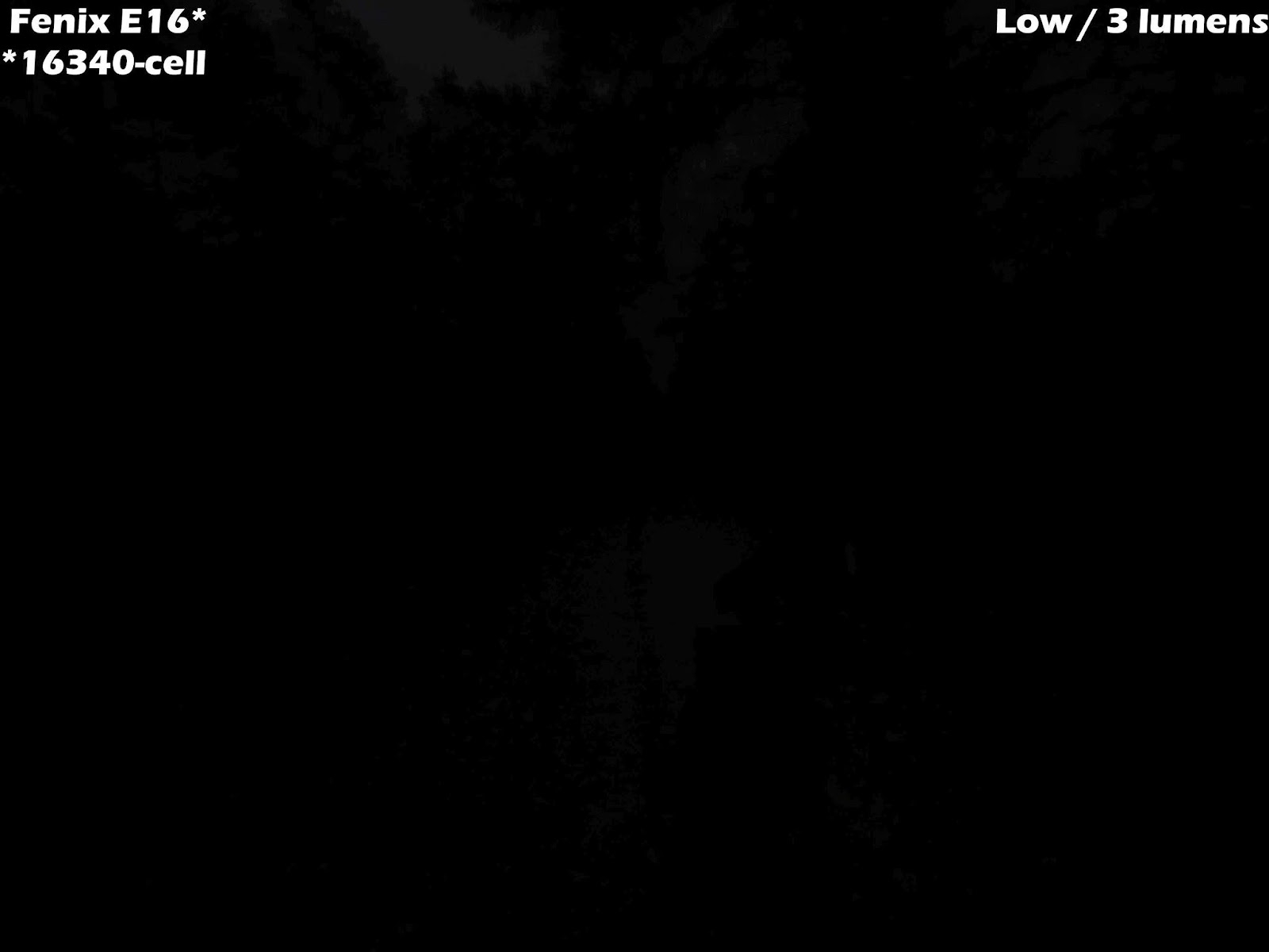

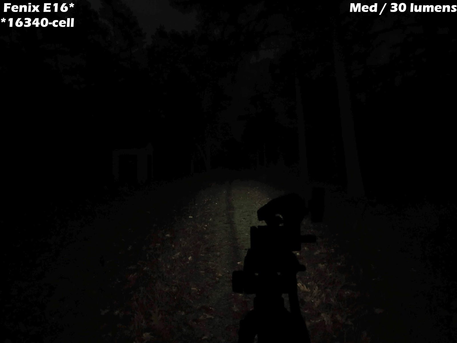

The special designed reflector with special structure has clearly its effect on the beam: A rather big spot with medium corona that gradually turns into a big spill. As expected, this shows a broad beam in real life. The E16 is designed to light up your path, to check your engine when you have a breakdown or for reading in your tent at the camping. But the flat XP-L HI has also surprising throw for a baby-light with such a shallow reflector. Therefore, the E16 will be your buddy in a lot of situations. The beam is uniform in shape, but not perfectly rounded. This is because of the reflector; outside you won't notice this. No PWM detected during the testing at any mode; this is what I'm used of Fenix, but a good point.
Highest time now to see how the E16 performs! As usual, we start indoors by shining a a white wall. The distance to the wall is about one meter; I'll show you the four output modes of the E16 and after that a GIF. I used the 16340-cell for my beamshots, at this way I can show you the maximum output of this light. Powered by a CR123A, the E16 will reach less than half the output, maximum 300 lumens. I skipped this battery in my test.
Camera settings: ISO100, WB daylight, F/2.7, 1/125 sec, 35mm
XdXw94WdzDZzDqZ0hkiXBqSYmu46wMXK2wFAu9FH4cH8ULcurau8gQjunHyjj2r3pGFjtl7KnC198GwYoeAnfxuxC4XLX9uZh3w_Smw23OeoAGiEgk-QIs6X5PNu1GDBUCjlPud1
BwGi6C-mlphr1jbRE4MPlCZwnbEHSO1tFdRgGY1SiB28QcWWQXktTMt_76DsjOuqzsJ24enyMB4B67QwzL1-gynp7rJAXr3Z8io7e0XiQtC2yahXNKITZYCbVn7so4kNWueXHRZK
eKCk0jWdYPP8PMukJUL-LuXP395AHm7CM1mN1mmPJ_yqKaEhzUc624649CP50nQQvN9-d9CBfr1NM1hzwV8MLgozlYOZaDU7P3JTSRRzdojjZ2ysnIVg7IM3sJ_b-9j29Ns2tHwd
kaIqP9eLtlzZbGUgFUSLr0t2lsbf2wE74NJgiFOI6MYunjLGVf2LHMbTb2BDYxH9COOs2dS4vYSHsGrjutO5wg0yUOIDLKt2_njOHns5LCVmF3SNa7Sb_j3qhqxgg891E6ozfp-L
