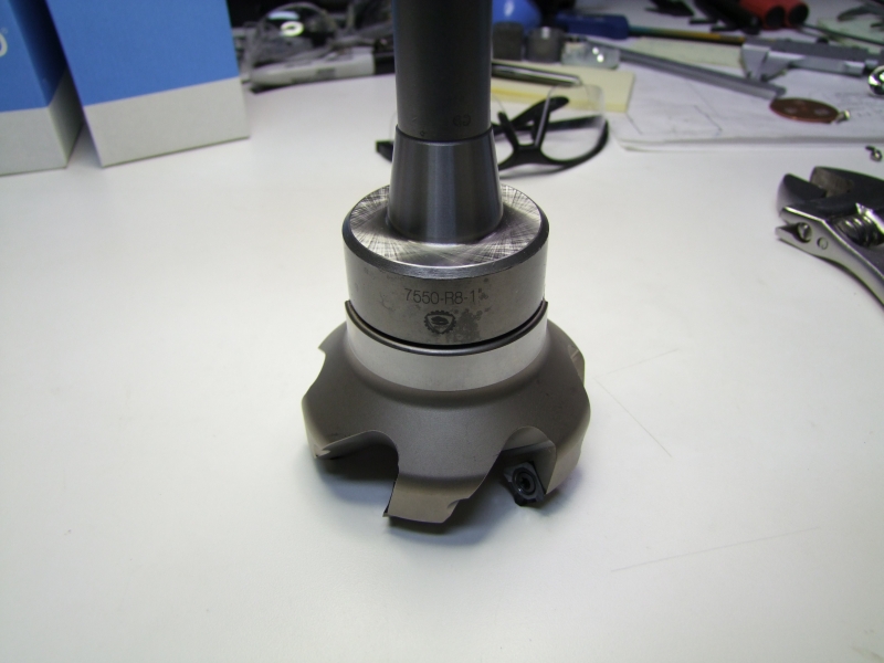

point me to the required, high quality R8 spindle shell holder
Always happy to help spend your money
Call Tom Johnson and tell him you want Bison-TMX part number HK30065010 at $56.50 + shipping. That's the R8 shell mill arbor with .750" diameter shank (double check to make sure that's the correct bore for your shell mill - other sizes are available from Bison TMX)
(248) 442-9482
I just spoke with Tom & he is waiting for your call

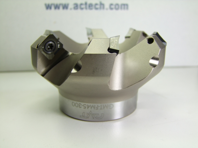

Is this the part number - RF00300S100SD43C - for the 3" face mill?
If so, bore is 1"

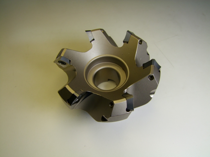

I went ahead and ordered the 3" 45Deg shell from Glacern Machine Tools:
link ...
and it does use/need a 1" bore.
For inserts, I wend with the Korboloy SEHT43 Grade X83 - Uncoated, polished, and ground inserts. Once I add the price of the shell and inserts, it was similar to the combined special on Grainger, but I got to pick the inserts I wanted.

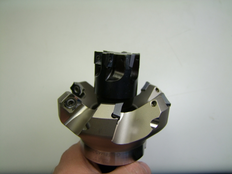

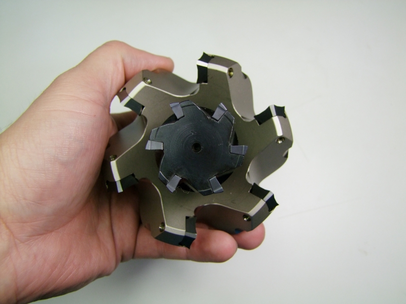

Got the 3" cutter today - it is HUGE!
Here it is compared to my Iscar 1.5" face mill cutter:
The matching R8 arbor should hopefully arrive this week

The Bison shell R8 arbor that I ordered from Tom arrived today:
