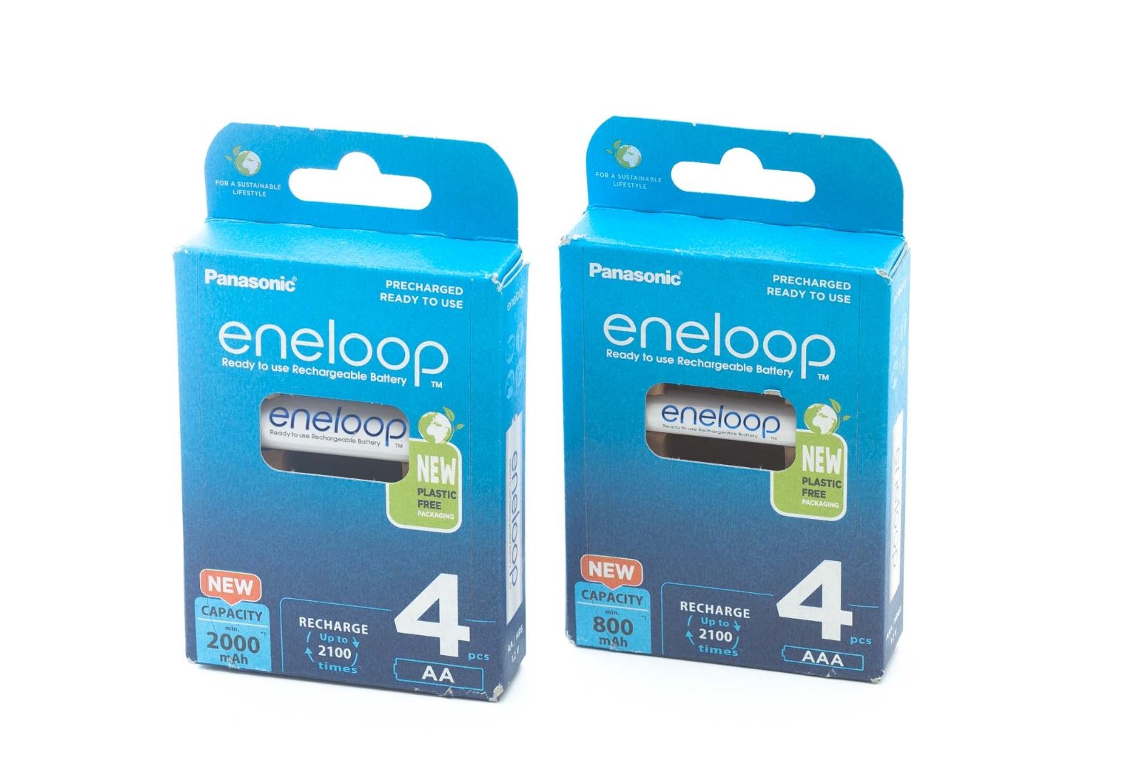

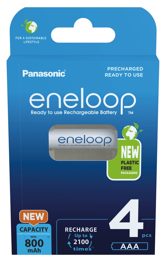

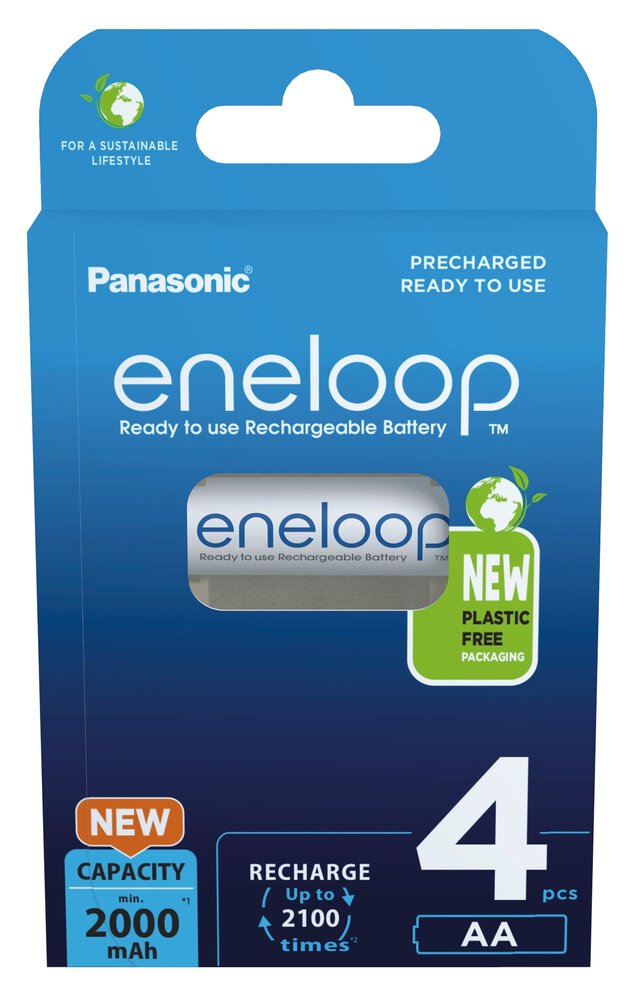

After so many years, finally a new Eneloop battery.
Besides a new kinds of packaging for the Eneloop Lite and Eneloop PRO, the 5th generation standard Eneloop White has just launched in Europe.
Thanks goes to one of our readers, Daniel.
Minimum 2,000mAh, but same cycle life

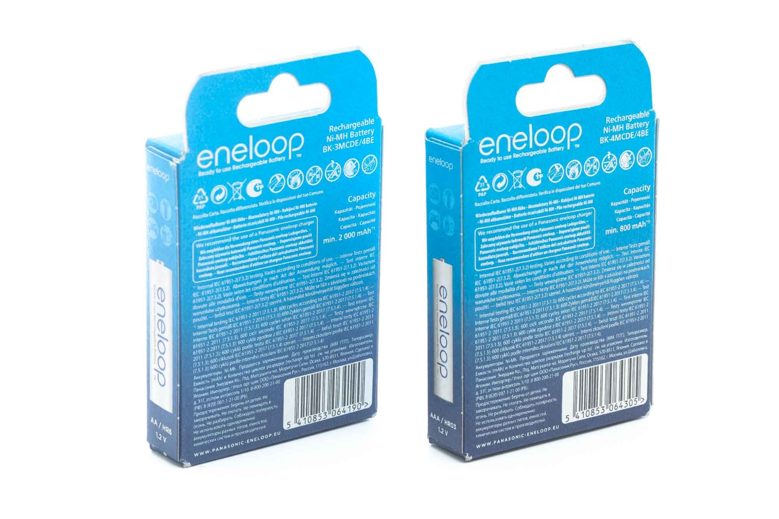

Answering some questions:
Yes, still made in Japan.
AA 1st-4th generation were all 1,900mAh Min. and the new ones (5th gen) are 2,000 mAh Min
AA 1st-4th generation were all 750mAh Min. and the new ones (5th gen) are 800 mAh Min
Some observations:
They are also heavier than the older 1st-4th Eneloops.. (1 gram)
The new paper packaging seems pretty weak and easy to damage. For retail stores it might be difficult to keep them in good condition.
I just received mine a few days ago.. Did some testing (not according to the IEC standards), and I'm making a video.
