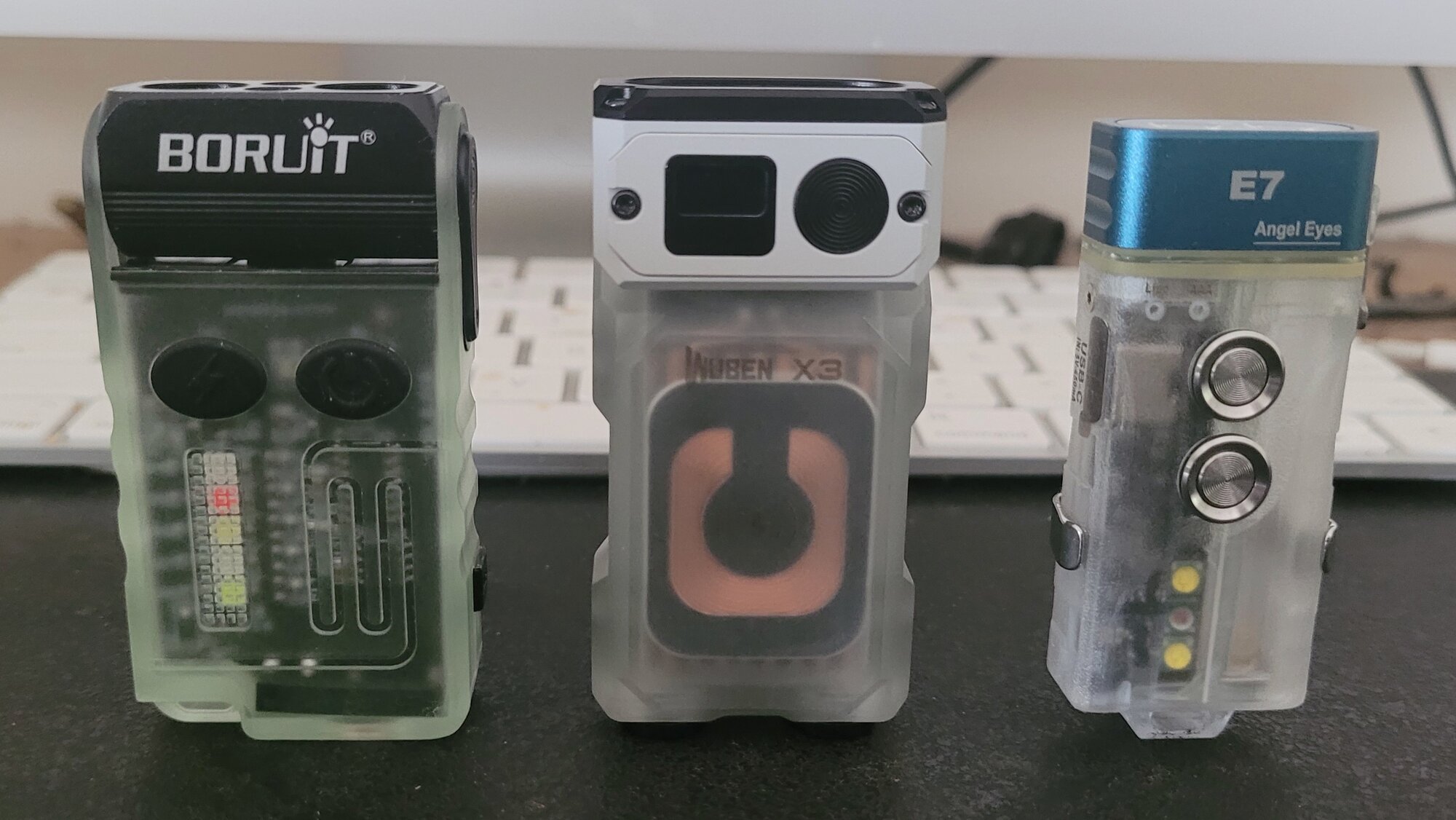

First up, a few group shot with the RovyVon E7 for a size comparison:
The E7 is the smallest of the three, but that, and the fact that you can use a AAA battery when the built-in rechargeable goes flat, is pretty much all it has going for it. There is a point where a flashlight can be too small, and I would put the E7 in that category. The V20 and X3 are similarly sized, and is the size and form factor I prefer for an EDC light. The X3 feels to me to be of a slightly higher quality in terms of materials used, overall design, and manufacturing execution. It's not that the V20 is bad (I rate it higher than the E7), it's just not as good as the X3, IMHO.

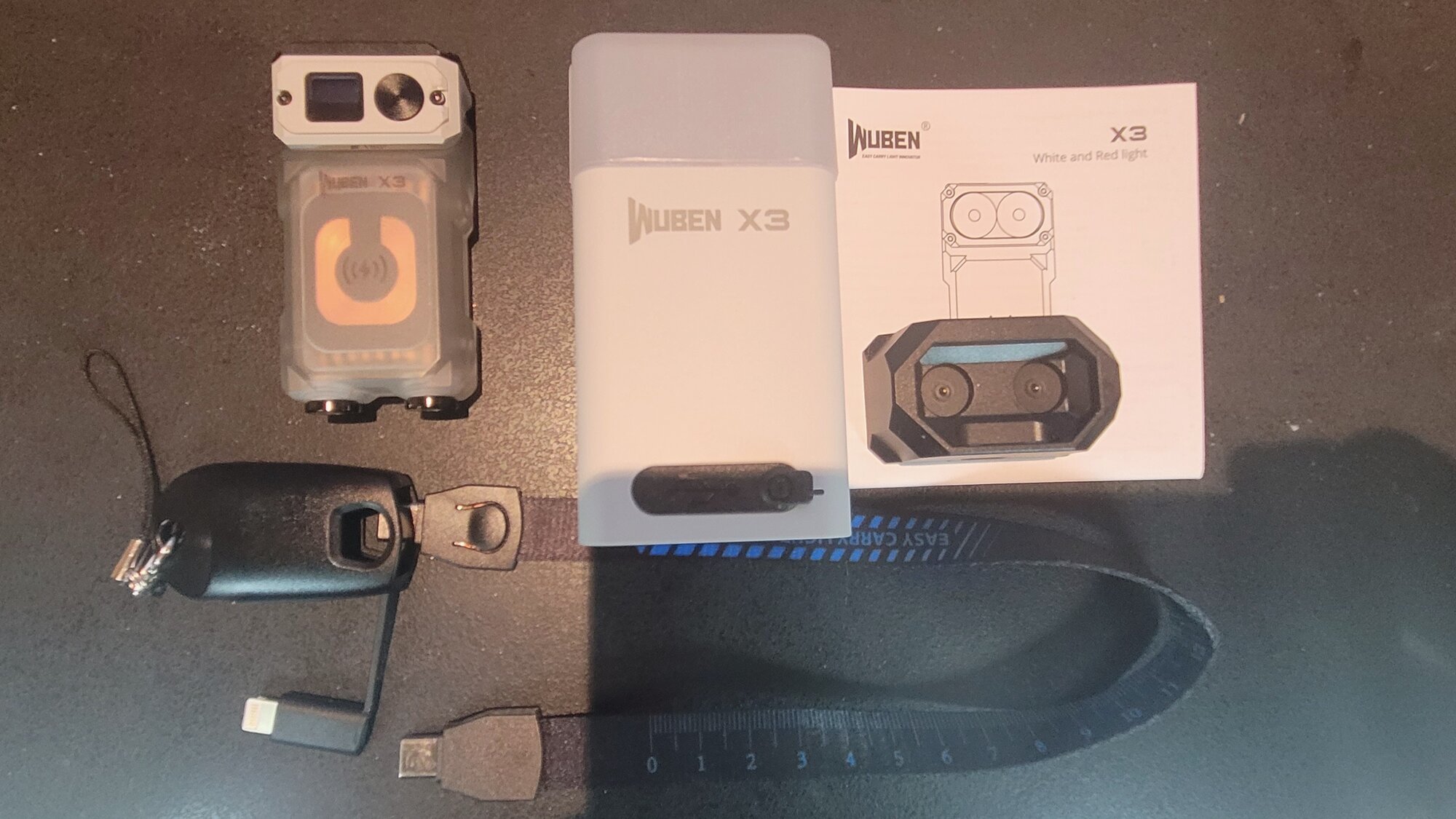

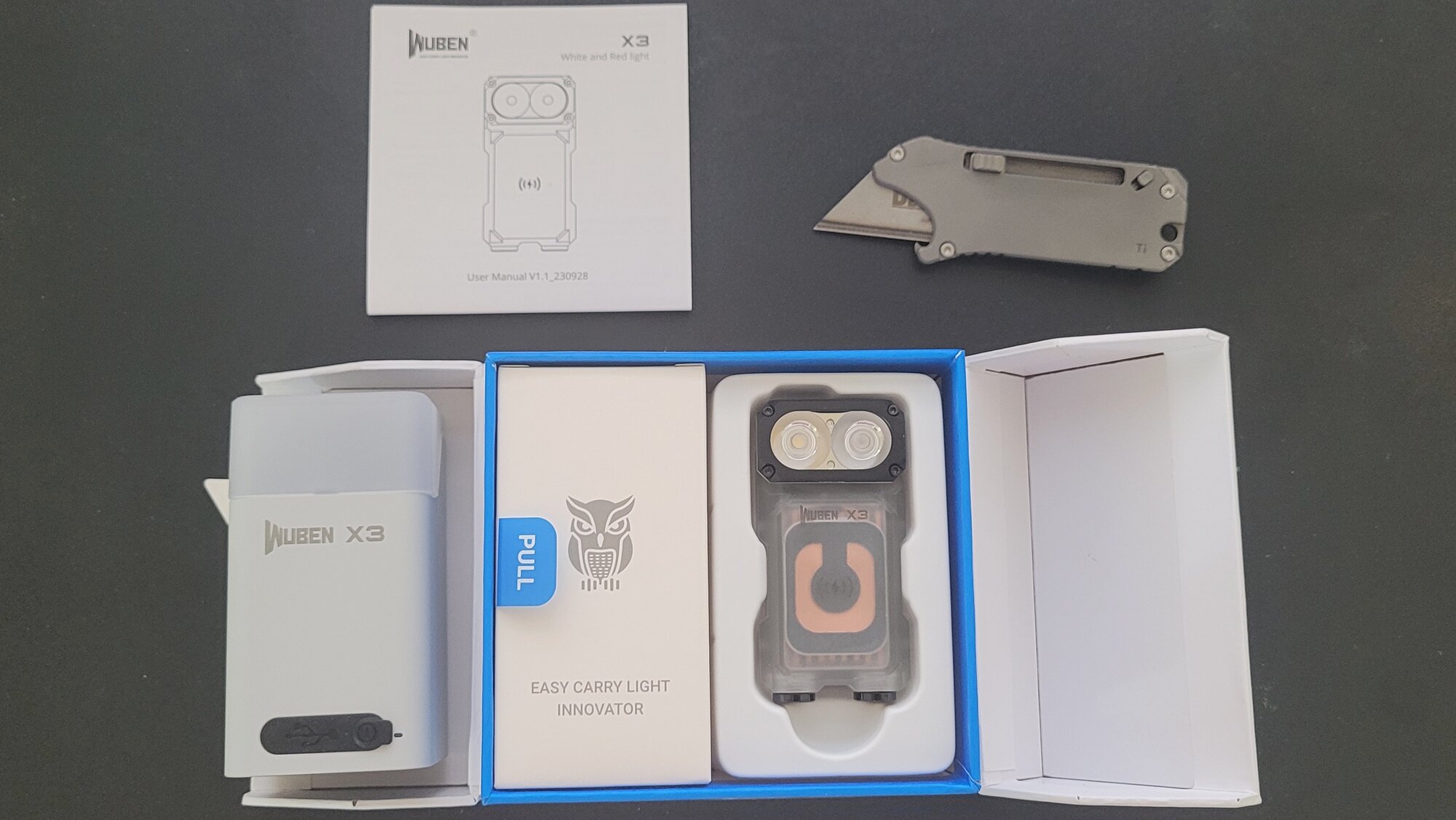

And here's the X3.....
Sorry, the Otacle Knife shouldn't have been in the photo!!! Just to clarify, it did not come with the X3. It's what I used to open the box.

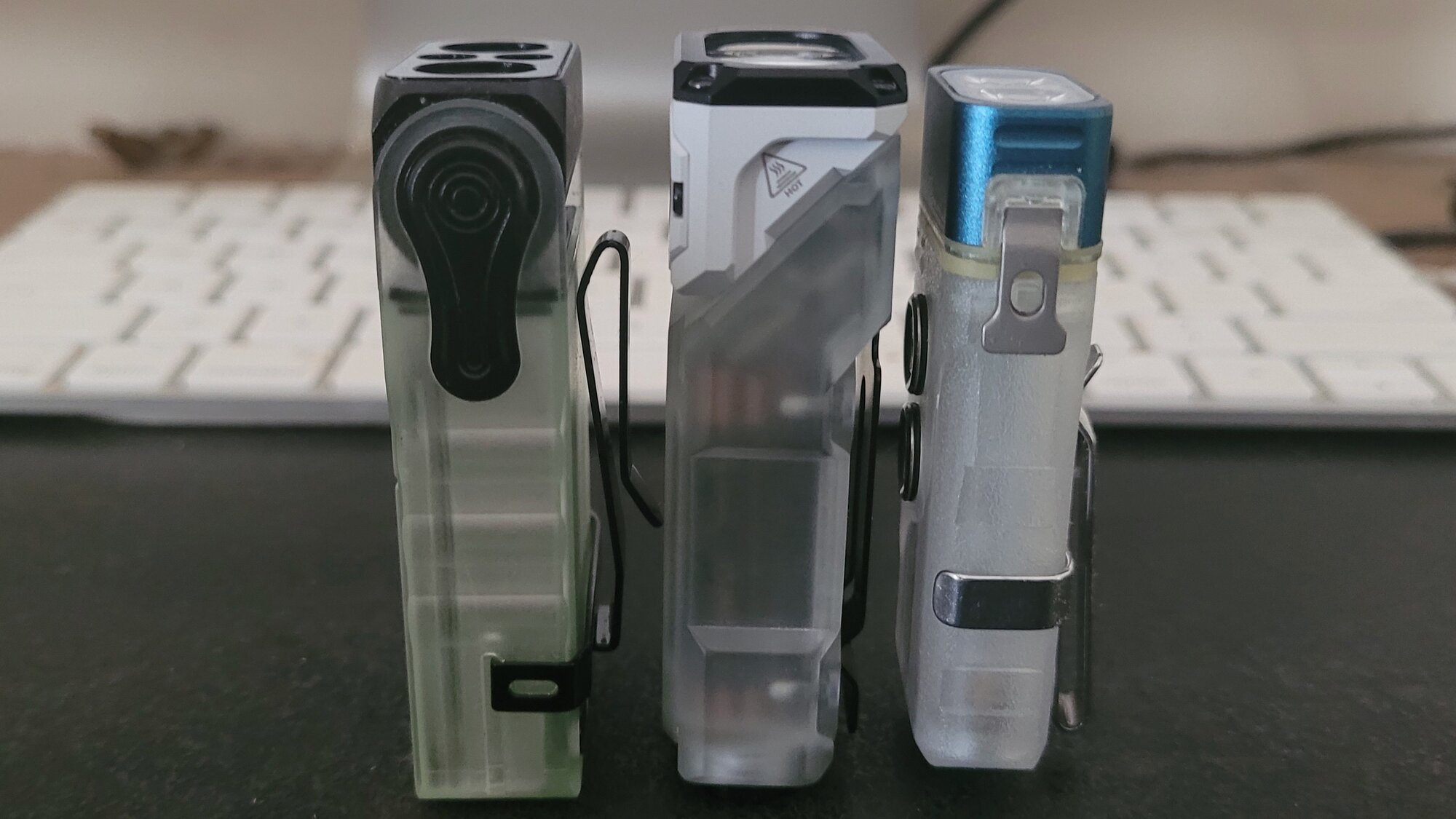

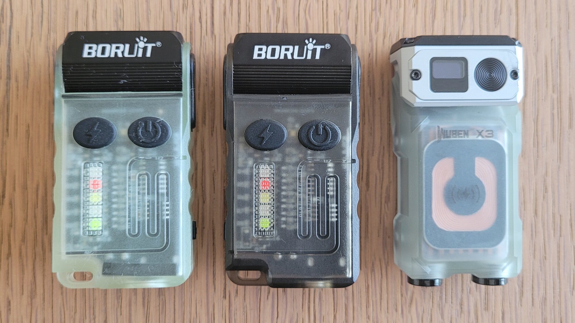

Here is a group shot. From left to right, GITD V20, Black V20, GITD X3.
I actually have another GITD V20 not pictured, and a Black X3 on its way.

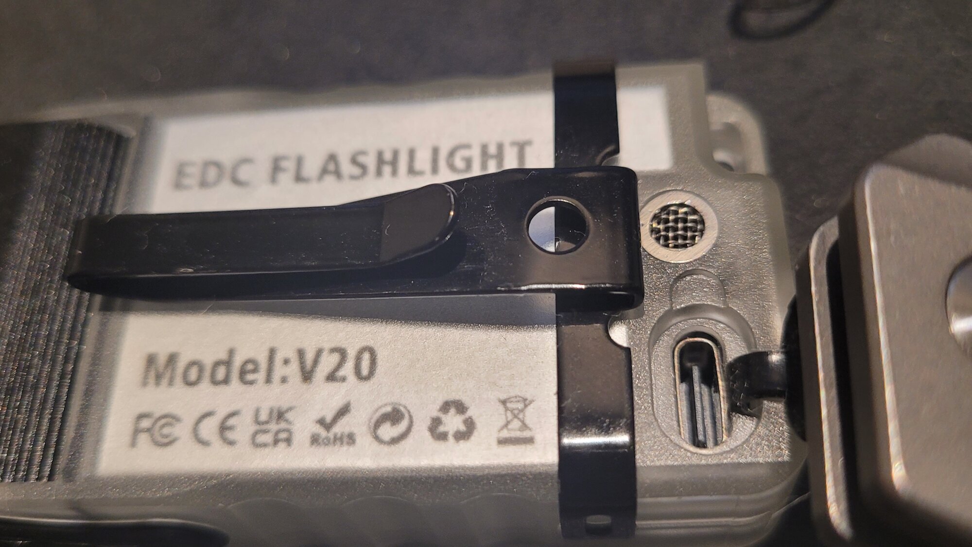

- The USB-C charging port is deeply recessed and the hole to access it is quite narrow. What this means is not all USB-C cables will fit. The one that comes with the light naturally does, but the lanyard cable from the X3 does not. I tried another cable, which was braided and not cheap, and it only fitted in with some modification (filing down the plastic on the plug ends). This is a real shame because I'm unwilling to modify the X3's lanyard cable because doing so will nullify the lanyard aspect.
The offending USB-C port of the V20.

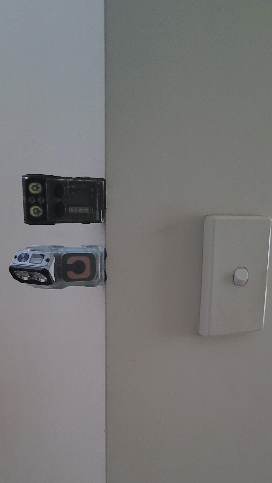

The photo above shows both lights magnetically attached to the steel protective edging on the corner of the drywall. Whilst both lights have the magnetic strength to support themselves, the width of the steel strip is such they can only be oriented as shown. The V20 in particular an only be mounted as shown. The asymmetry of it's magnetic base does not allow it to be rotated 180 degrees on its base. Doing so has the V20 wanting to rotate back to the position shown. The problem with the V20 is in this position the head cannot be positioned so that it is shining down. On the other hand, the X3 can be rotated on its base 180 degrees in which case the head will point up, which maybe what is desired. I've come across this exact situation at work where the only steel mounting point nearby was the protective steel strip in the wall. I concede this is a scenario that 99.99% of V20 owners will probably never come across, but it is a possible one nonetheless.
Note, the issue I've outlined is only an issue when you cannot mount directly to a steel structure. The magnets of both lights are strong enough to support their own weight in any orientation when you can.

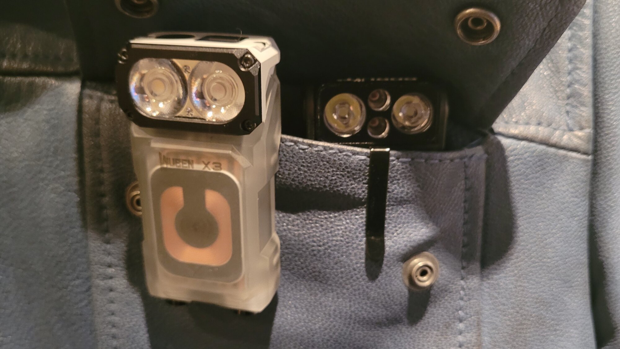

Below is where the swivel head of the V20 trumps the X3.....
The photo above is probably a more common scenario. It shows the pocket clip capability of the light with the LED's facing forward. Whilst the clip and swivel heads of both will allow you to clip the light on the outside of the pocket with the LEDs (including High RED) shining forwards, only the rotating head of the V20 will allow you to clip the light INSIDE your pocket and still have the LEDS shining forward. This is a big plus where there is a high probability of dislodging and losing the light. Being able to carry the light more discreetly this way also has the added benefit to those not wanting to seek attention.
