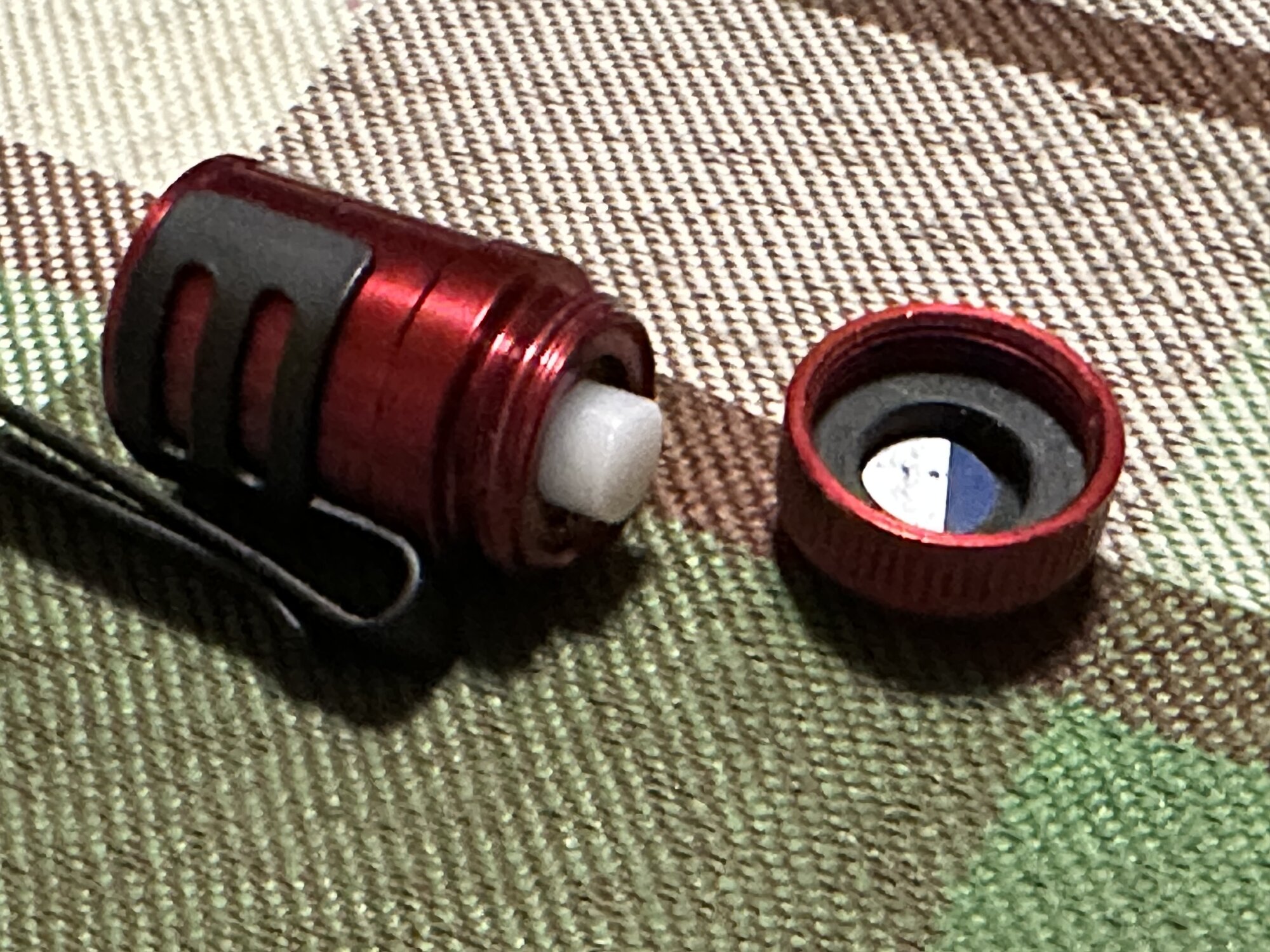

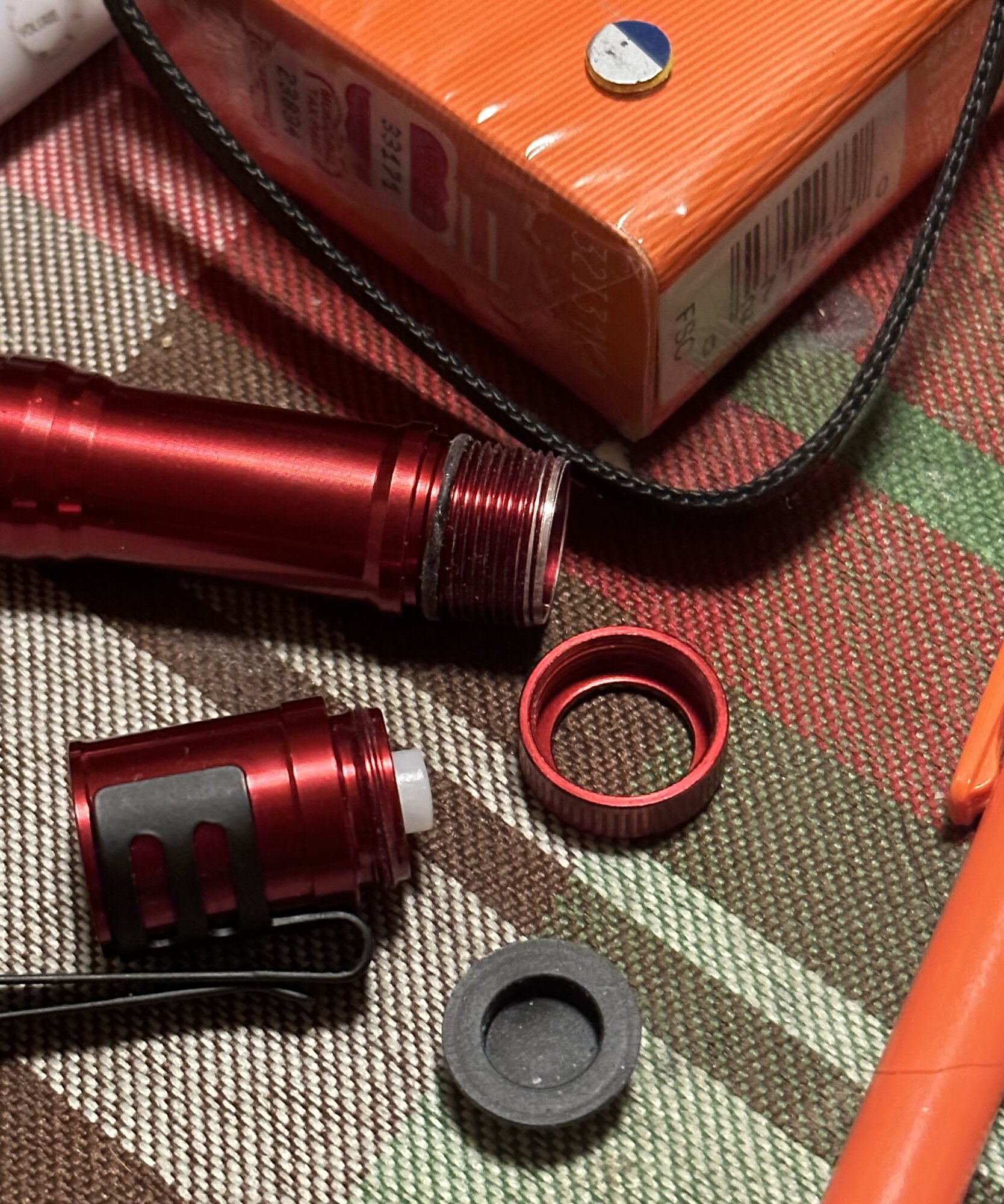

Here's a way to make the microstream a little easier to turn on/off. Wish I remember who here showed this so they could get the credit.
Tools needed: an old plastic card like a rewards card, a single hole puncher and a pencil with eraser.
- Disassemble the top and bottom portion of the tailcap. Remove the boot. (Button cover)
- Punch a hole in a plastic card and keep the "coupon" (the punched plastic).
- Use the pencil eraser to push the coupon into the boot.
- Push the boot back into the top half of the tailcap with the pencil eraser.
- Reassemble the tailcap.
Your microstream (or stylus pro) on/off switch will have about half the travel it had when new.
A word of caution, if you trouser pocket carry it, it now activates to momentary much easier.
