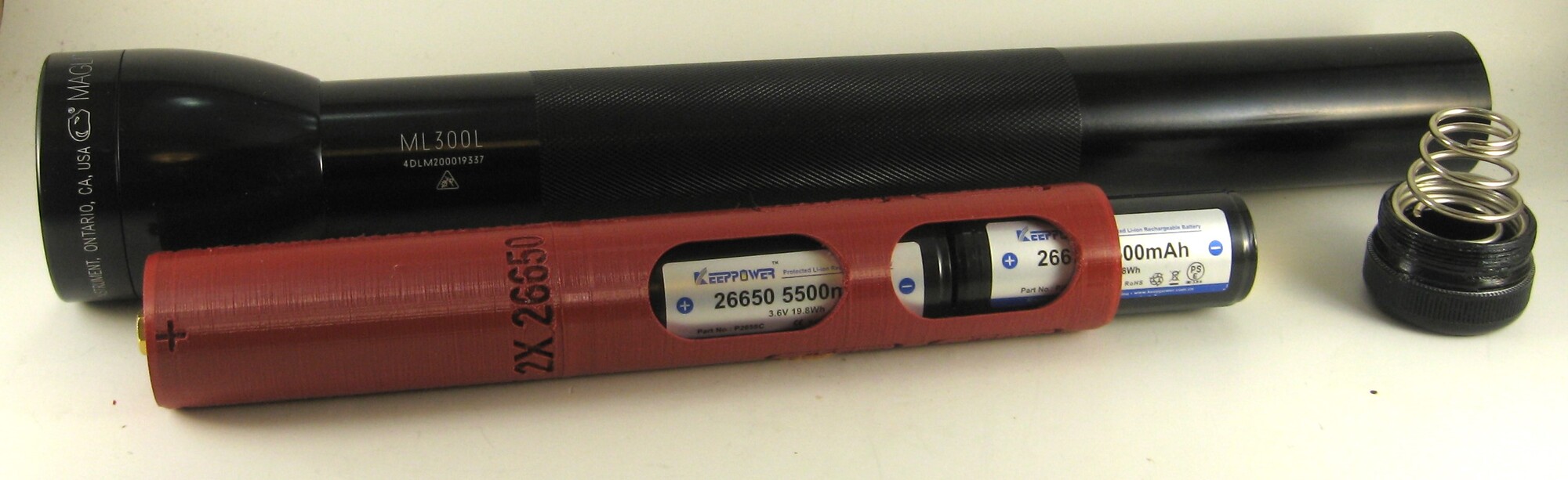

Nice where can I find this? Is it safe for the light? ordered a couple of the 4d L300Ls
Don't know how safe it is, there's always some risk in using two or more Li-ion cells in series, which is why it is essential to only use high quality matched protected cells. I also don't know how safe it is for the 4D ML300, all I can say is that I have tried it in 3 different ones and haven't blown the LEDs (yet?). For these reasons, I probably won't be making any more or offering them for sale.
hugodrax
Mar 3, 2003
131
makes sense I did the quick math and yeah good idea not to sell them and get yourself in a mess. I will probably just get some Tenergey rechargeable for it.
