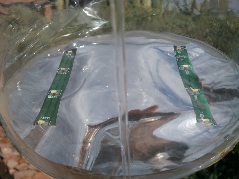

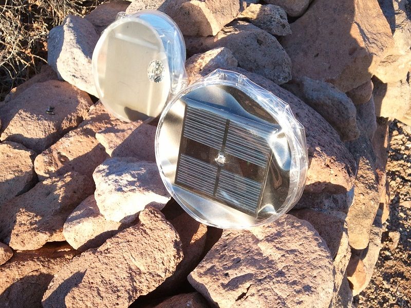

Then here is some more gadget pron, the PICS!!!

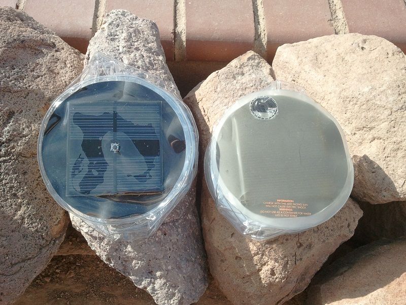

The first pic is them both side by side withe the newest version on the left with more LED's and a top mounted switch for convenience.

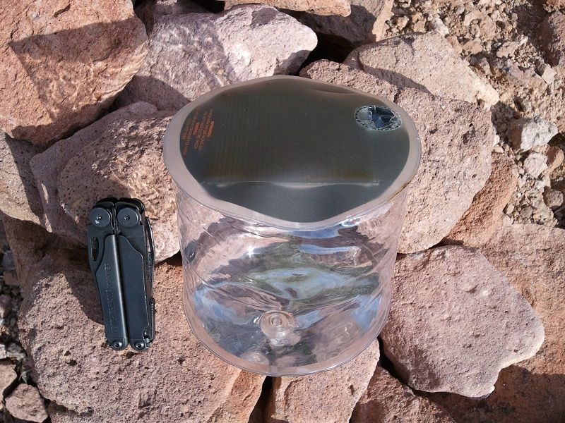

The second pic is of the two inflated and the newest version is still on the right.
Third Pic is of the two in the correct orientation to hang and use at night. Newest revision is on the left and old on the right.
Fourth Shot is of the two in close up with the valves that they changed and updated the new one with a more standard blow up valve.
Fifth picture is a close up of the first prototype sample sent to me that has fewer LEDs but they are the same ones used on the 2nd sample (newer) sent to me.
Sixth Shot is of the original prototype sent to me in size reference to a leatherman wave.
Seventh Shot is of the two side by side in charging mode. Make sure the device is not inflated all the way when exposed to 90F heat as it will pop and get a hole.
Left is the original and right is the newest version sent to me.

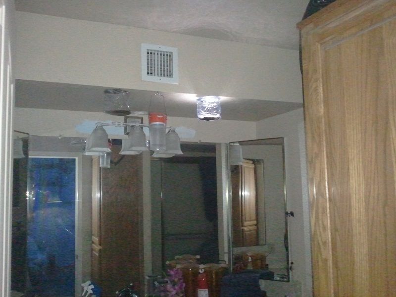

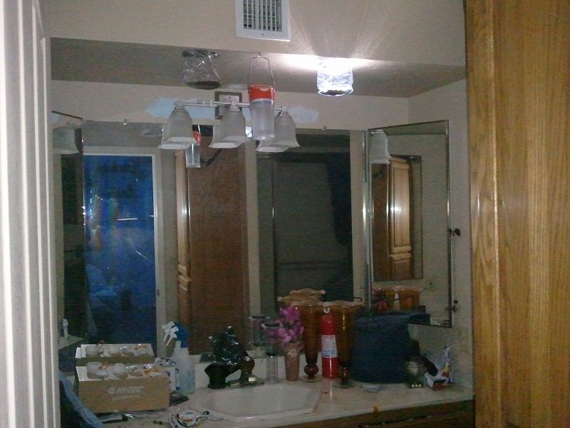

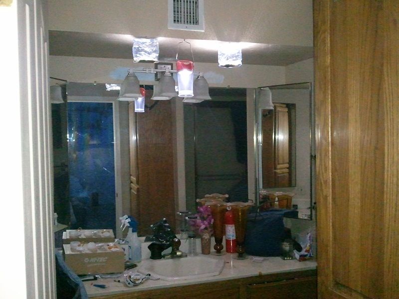

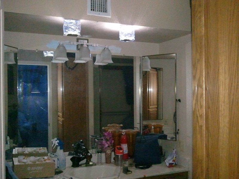

Then for the shots of this in action against a light that has the same mission, specs and price for $15.00 USD. It is the D. Light Design S10 and its brightness levels are low(30 Lumens) high( 50 Lumens) of nice diffused less bluish light
The first picture of the night shots are in my bathroom. The brightness of the two is hard to notice with the camera so ill keep it simple with the original sample on the left on low and the second sample on the right on high. It looks bright but I had my camera flash on and it pretty much lit up my whole bathroom. 30 Lumens is hard for my phone camera to pick up.
The second picture of the night shots with the same as above but with the d.light s10 in the middle on high.
Third of the night shots is of the newest revision sent to me. This is to show you that it has more LED's than the first sample and the anti reflective coating inside works great for reflection and not great for diffusion.

All LEDS would not show as the PV/LED Board move around and two LEDs are hidden behind the reflective coating inside the unit.

Q) Would it be possible to take a photo using One (1) Luci alone. I see you used 2 as well as a lantern. I'd like to see what this thing can do on it's own.
A) Here is two pictures of the light alone.
The first picture is of the Luci light on low:
The here is the second pic of the Luci light with it on high:
As you can see that both modes do a good job of lighting my bathroom.
