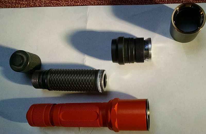

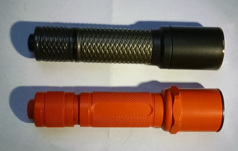

as to oveready:
pic of a diamondback (I think that was the name) body.
their special head neede a flat surface of the body and thus an adapter for a P60 insert
their special bodies / complete lights - like the fire red or ice blue hosts were great.
actually a body adapter for making a 6P a 2 * 18650 light/host is still available.
... unfortunately, with starting with their overmuch expensive own light engine heads, they stopped being of any use for a modder.
And the actual, lunaticly expensive, Boss lights are just blatanly crazy.
on the other hand I do undertand it, from a commercial perspective. When there really is a market for this, then it for sure is way "better" (for the maker) to sell a single piece of jewelry that also can give light, instead of producing, stocking and finally trying to sell 35 "normal" bodies.
