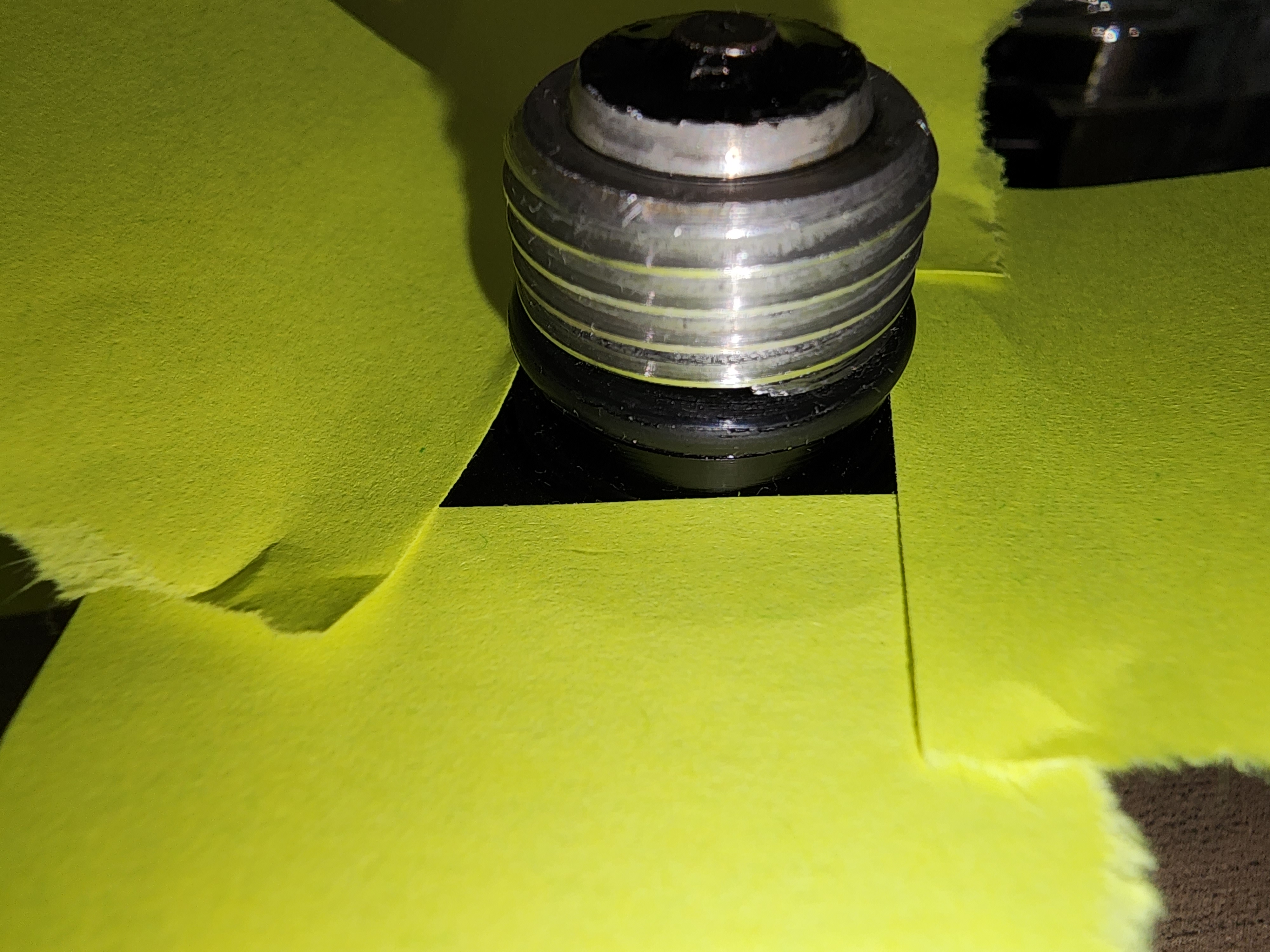

That's good to know. I had used a tiny dab of nyo760g on a Peak, and the Oring seems to be disintegrating slowly, like it's dissolving away, lol. I'm gonna put some plumber orings I've got instead and see how they fare...I think I still have some spray lube from my airsoft days, might give that a shot insteadIt’s fine.

No idea what Peak uses but nyogel 760g probably isn’t the best general o-ring (and thread) lube. The PAO could mess with some materials. Best leave it for what it’s supposed to be used for as a dielectric grease.That's good to know. I had used a tiny dab of nyo760g on a Peak, and the Oring seems to be disintegrating slowly, like it's dissolving away, lol. I'm gonna put some plumber orings I've got instead and see how they fare...I think I still have some spray lube from my airsoft days, might give that a shot instead

is the O ring Silicone? (what color is it)I had used a tiny dab of nyo760g on a Peak, and the Oring seems to be disintegrating
It's definitely not the silicone I'm accustomed to...it's hard, almost like a rubberized plastic, and feels very similar to the plumber Orings I have, except it seems to be reacting to the Nyogel and slowly disintegrating. When dry, it felt harder than fkm or nitrile, with noticeably less give, and took longer to return to shape when stretched.is the O ring Silicone? (what color is it)
