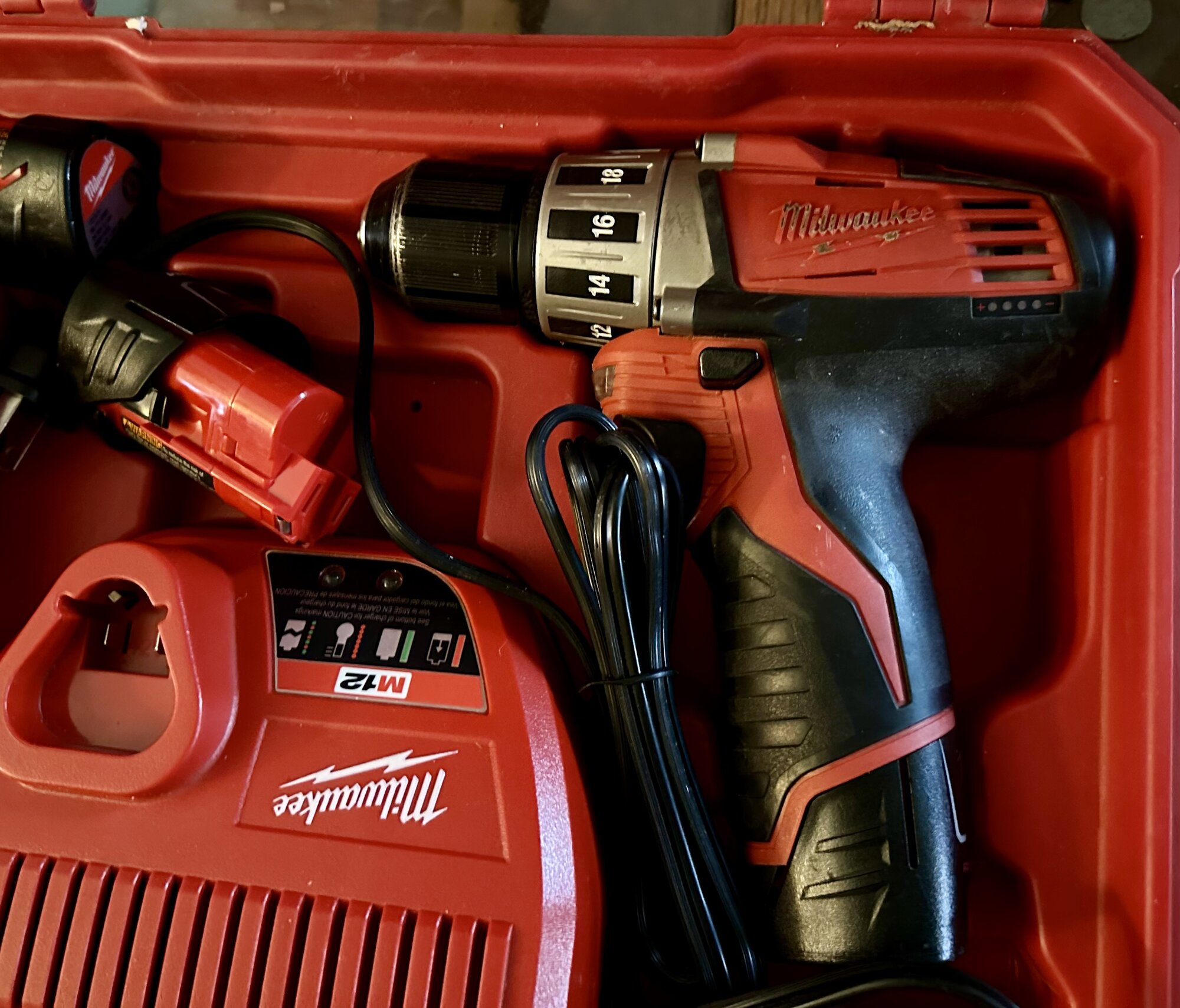

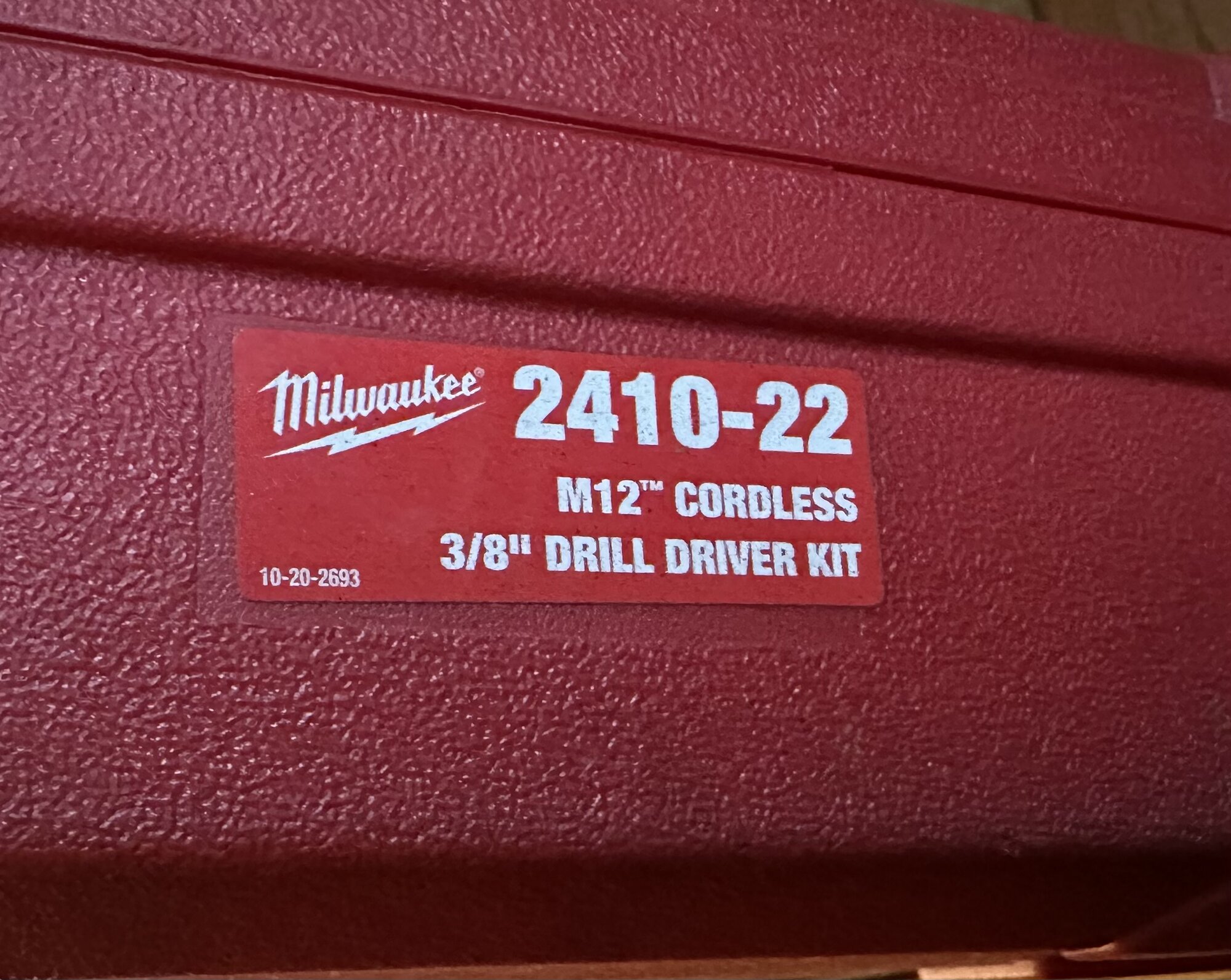

I have the 2410-22 from about 2009 or so.
You can twist the front end to have clutch settings like a drag on a fishing reel or lock it to become a screw driver.
My apologies, I didn't mean to cause you hassle with the pictures and everything, but thank you very much. ❤️
This is of course the drill driver version, whereas I only need a driver, but I would assume the torque is identical in both versions.
I had to google the 325 in-lb to Nm (and found it to be the locally listed 30 Nm), and I also just found the explanation on why the images I found online didn't match when I searched for the model earlier.
I presume the "Milwaukee M12 2402-22" is the US designation
...and "Milwaukee M12 BD-202C" being the EU designation.
But why the colours are not the same, I have no idea. Unless it is only to differentiate between the EU and US models.
In any case, I cannot say whether 30 Nm is much too much for my needs, when the DCF601 specifically seems to have entirely different types of measurements depending on the region. With the US site only saying "200W" (whatever that is in terms of measurement of force without a load), and the EU site saying 8 Nm (which I, as a non-prefessional, call BS - it has to be more than just 8 Nm).
Watching this right now to hopefully get a final answer on the DCF601 actual torque:
EDIT: And the conclusion on the DCF601 torque is..."low battery" >-<
But after all this, I'm kinda set on the M12 BD-202C or 2402-22 or whatever. Seems definitely like a more "heavy-duty" version of the Dewalt DCF601, which is pretty much exactly what I want. The weight is about 300 grams more, but that's okay.
...Yes, I work with IT, but I can handle a single kilogram, thank you very much. Can even handle 50 of them, up a staircase, if I have to. ^^
