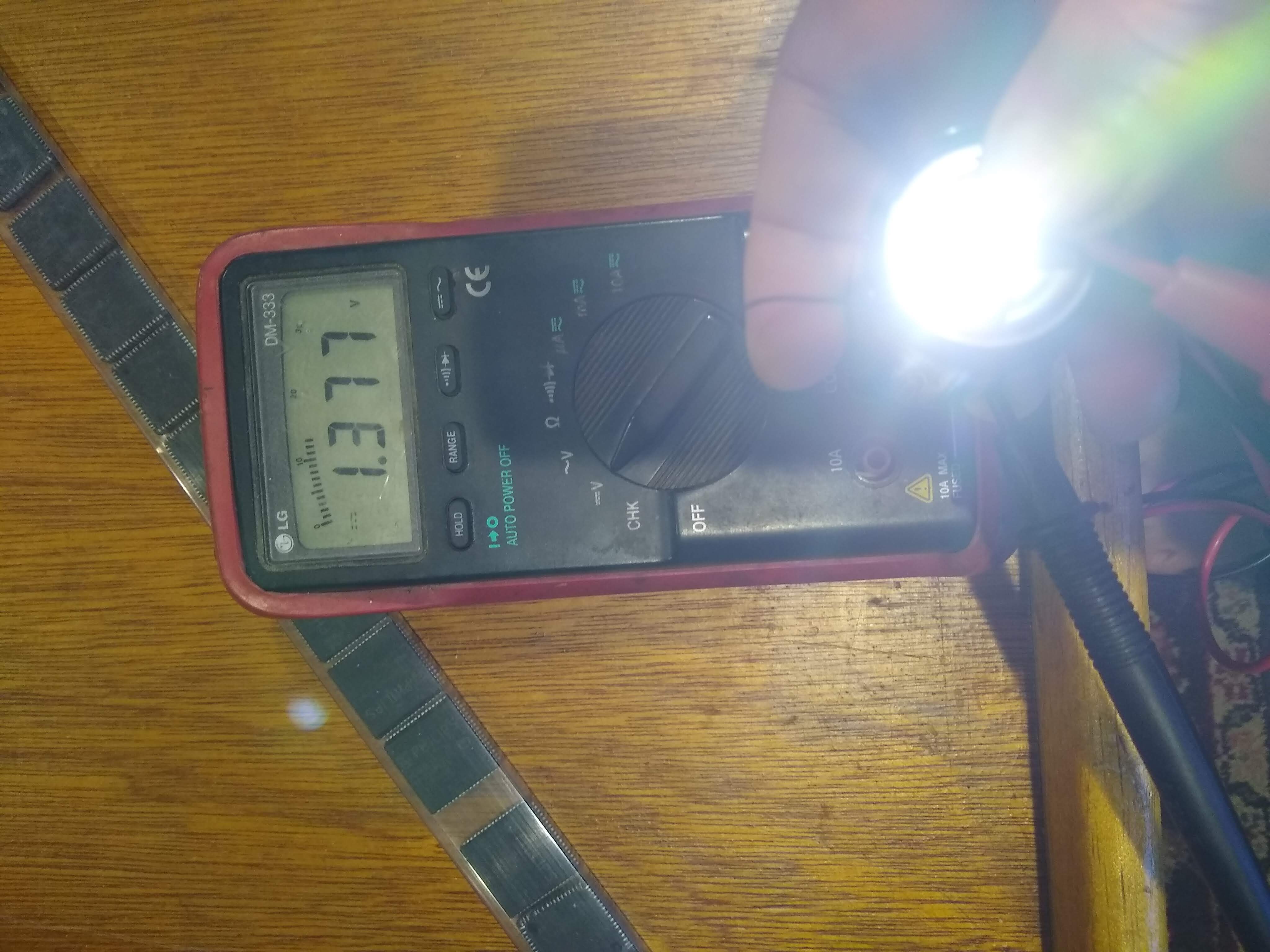

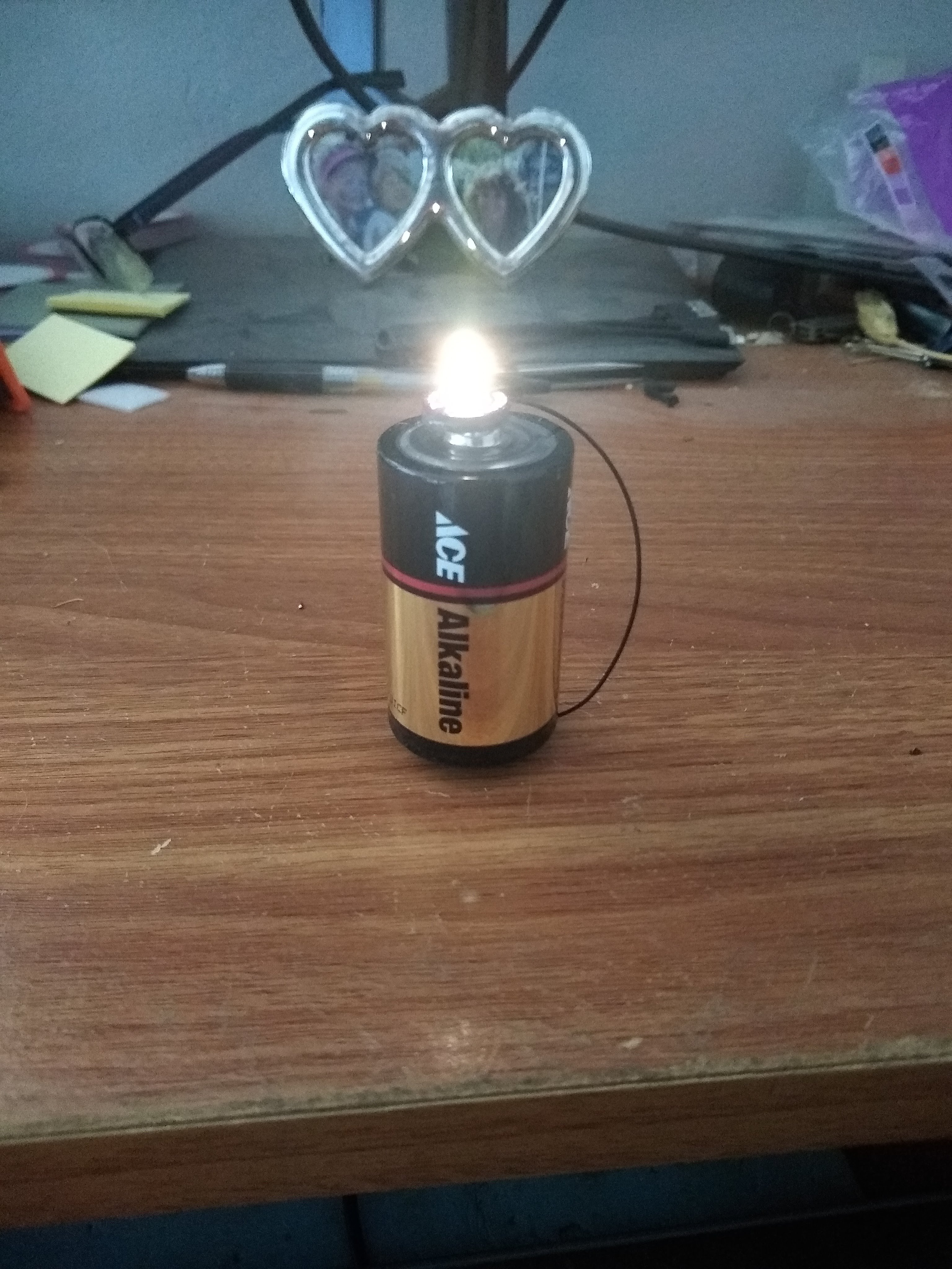

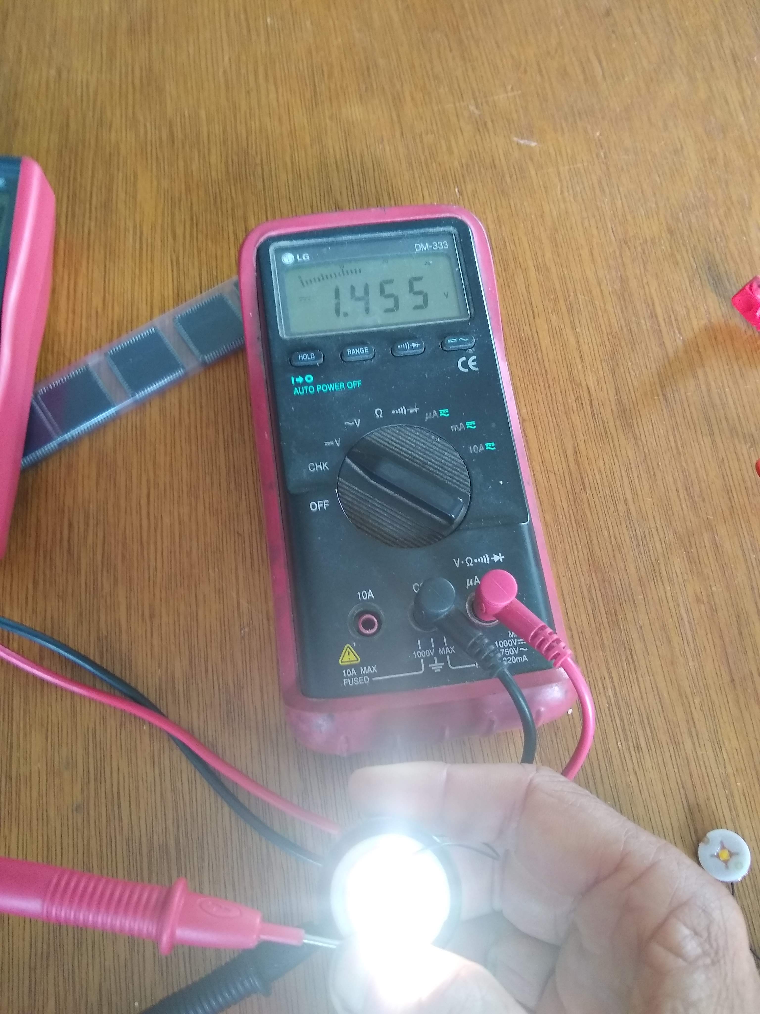

I recently purchased three Volt Vamps from datiLED, one of which is a 3V version for CR123s or other 3v primaries. I've noticed that it seems to run longer on my alkaline batteries that the 1.5V versions I purchased. I realized today why. The 3V board draws less current than the 1.5V board. I suspect it was designed for 3V cells (duh) and is out of regulation down at 1.5V. I don't have a good current meter for the current being drawn, as when I do try to measure the LED is dimmer than when directly connected to the battery. Edit: I connected the circuit using banana plugs directly to my meter, and this helped a lot. I suspect the measurement is affecting the result some, but it's not nearly as much as with the long leads. I was measuring about 20mA with the long leads.
Anyway, I started the test at 7am today. I think the battery is supplying about 70mA on my meter. If so, and if the D cell can provide 20,000 mAhr, it would be about 320 hours, or about 2 weeks. I think this is what datiLED told me for the 1.5V version of the Volt Vamp goes about 3 weeks. We'll see what the 3V version does. I imagine as the battery voltage decays the current will drop also, so it is not easy to predict the run time based on the initial measurements.
For the first few minutes I used a 1.5V version, which appeared to be drawing 95mA on my meter. I wanted to draw this out for as long as possible, so in the first 15 minutes I switched to the 3V version.
After running for 1/2 hr the battery measures 1.533V. I'll take data every day or so and eventually post the battery voltage vs time.
I checked the voltage again after making the current measurements, and it's down to 1.455V. That suggests this test may be over sooner than I imagined . . .
Images left to right, measured current, measured voltage 5 hours into test, Volt Vamp 3V on D cell, ISO 100, 1.250 sec shot for comparing intensity of the light.

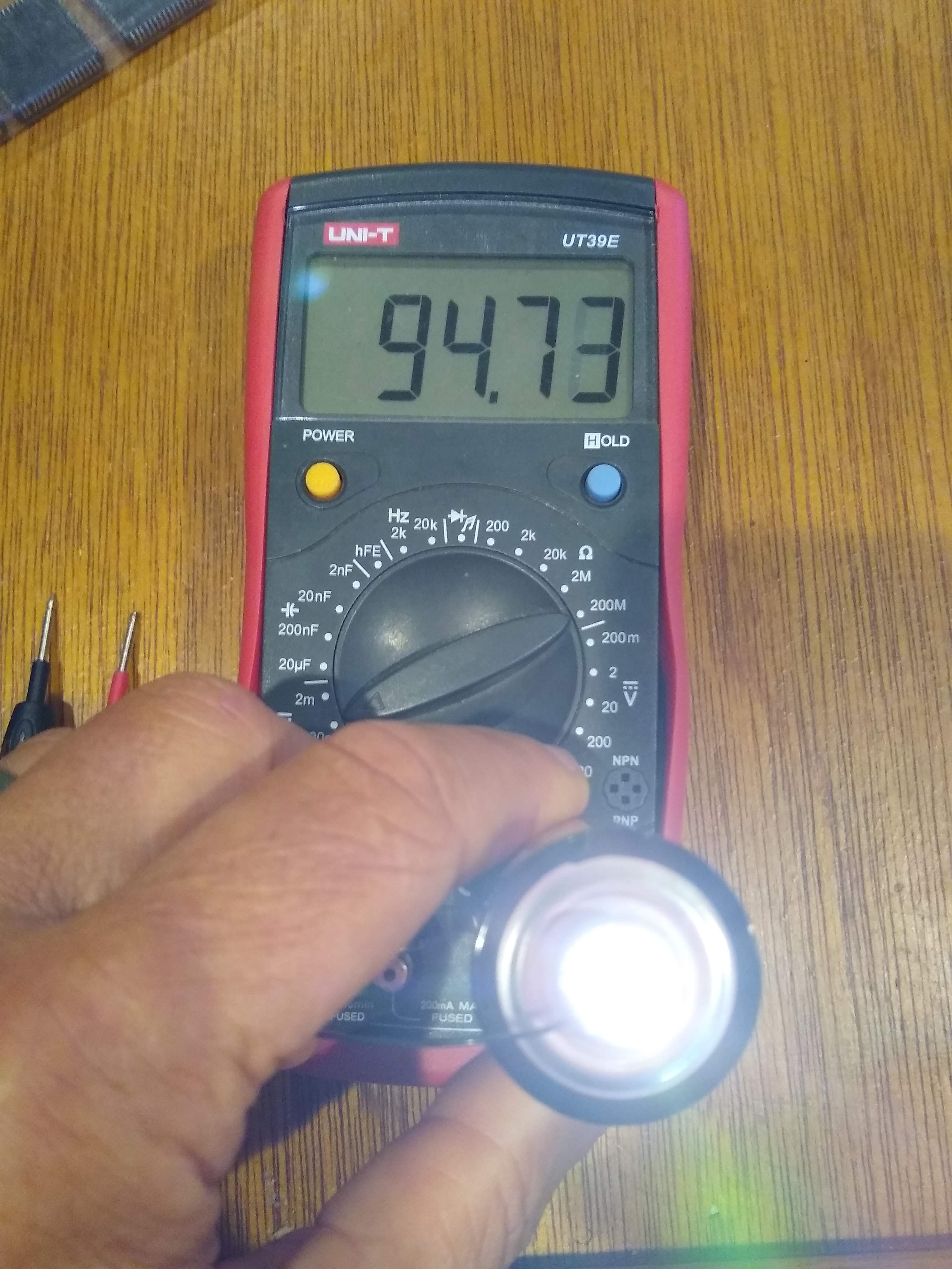

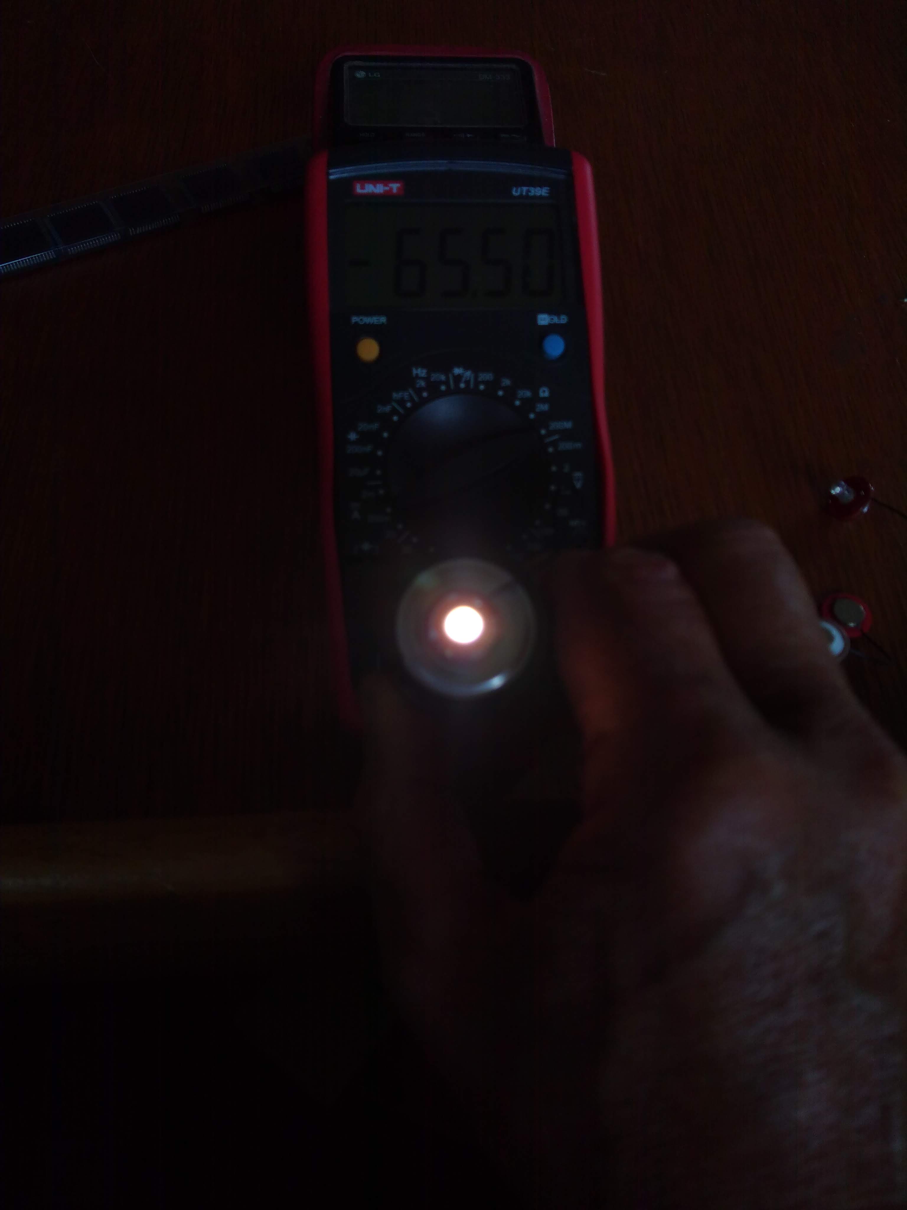

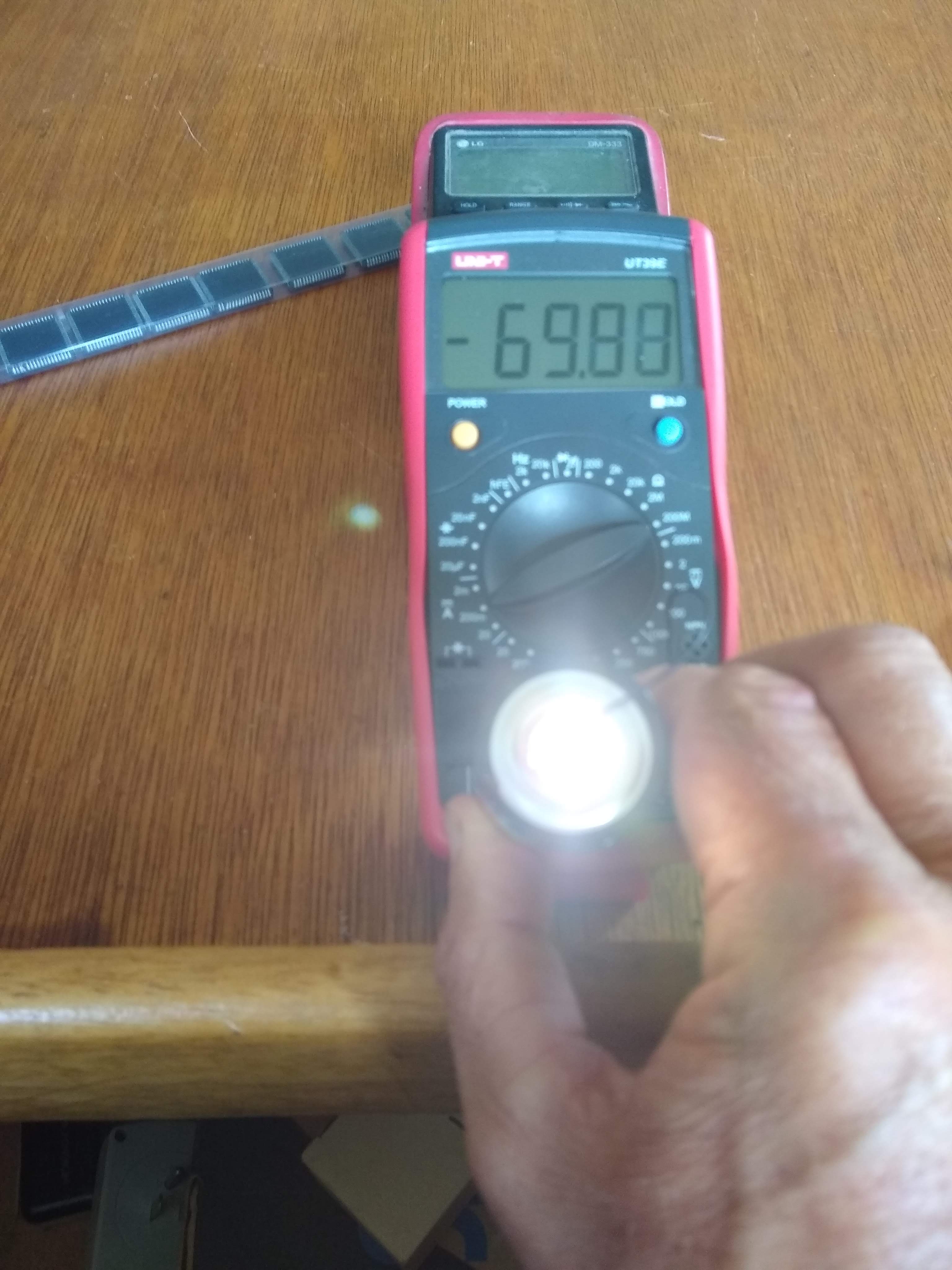

Paint's not dry yet. Thought I would take a look 24 hours in. looks like the Volt Vamp is still regulating as the battery voltage is down 0.2V from the start of the test and the current is up to 95mA. I don't have a good current data point from the test start. I also know the current measurements are a bit flaky, and often lower than what is actually happening due to my setup. but the previous pictures yielded power of 1.455 * 0.07 = 0.102W. Now the power is 1.377 * 0.095 = 0.131W. I don't trust my initial current measurements, or the efficiency of the Volt Vamp really starts to go down as the battery voltage goes down.
