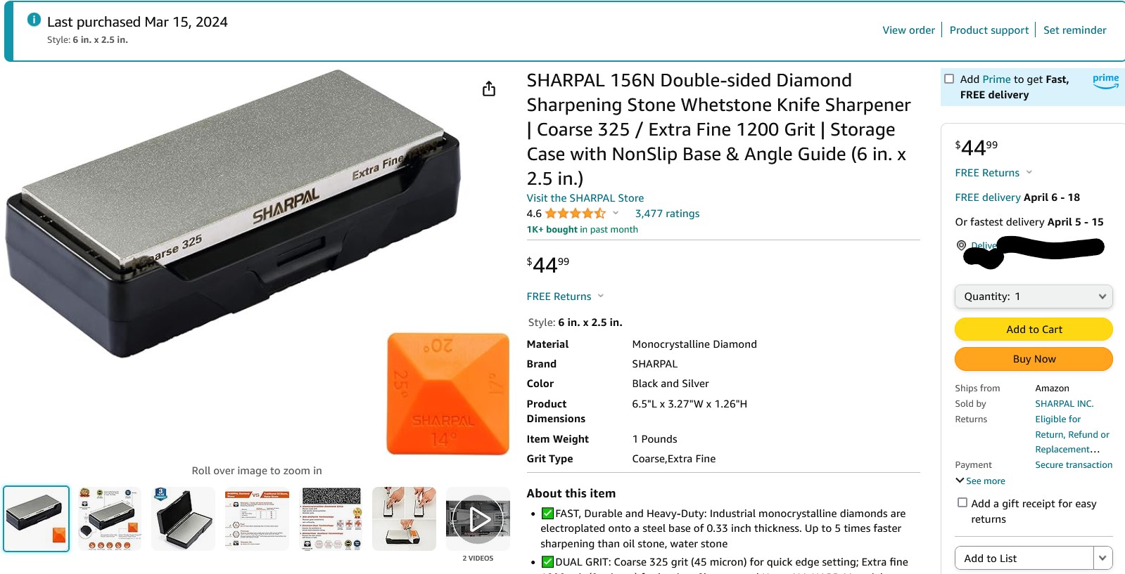

I don't know if this works but it arrived today, haven't opened it yet...
