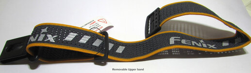

The HM70 has a good elastic band with Fenix logo and reflective bands, it can be seen very well in the dark and increases the safety of the user, it is in two pieces but I confirm that the upper piece of the band is easily removable.
I never use the upper part of the piston rings and it is the first thing I remove, but for some the upper band could be useful.
Being a Headlamp with 21700 battery it has its weight, but it is not excessive and I can use it for a long time without problems, but if you are a runner you will need the upper band.
The upper band can also be useful if you plan to use the headlamp on a work helmet, it is not mandatory to use it but it could increase the seal if your helmet does not have a good lateral fastening.
My helmet has the attachment points and the top band is not needed.

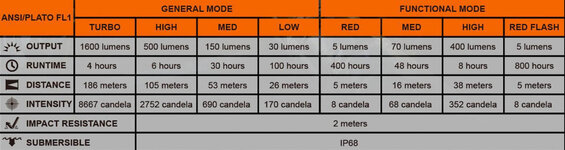

For the main menu the brightness levels are:
30 - 150 - 500 - 1600 lumens with cold light (approx. 5700/6000 K) and a spot beam which, except for the cold tint, resembles that of the HL60R
For the functional menu the levels are:
5 lumens_(red light) - 70 lumens - 400 lumens- SOS_(red light) - the two levels of 70 and 400 lumens have a very wide and pleasant flood beam, the tint is approximately 4500/5000 K with high color rendering.
