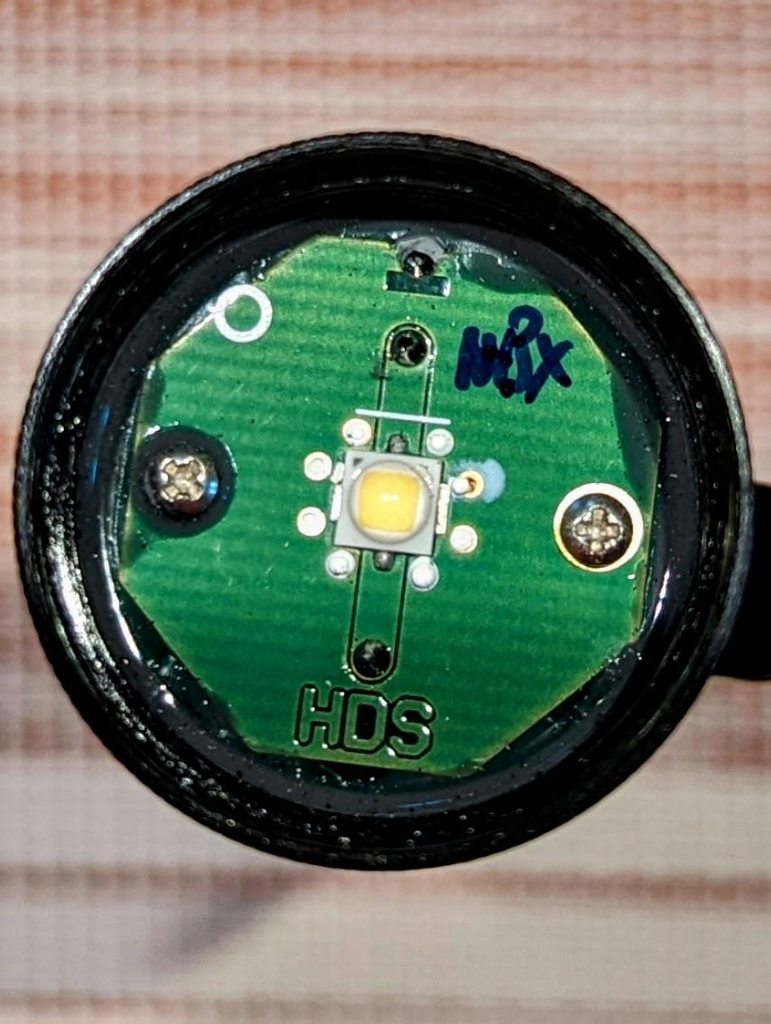

Good morning gents. Can someone help me out and tell me what LED this is?
I do not think it is a 219B, the PCB should be White. I checked all my 219B HDS, all white PCB, and believe me I have plenty 219B HDS lights.
The PCB change was between High Noon / 3 o clock - both 2nd run and the legendary final group buy that Hogo offered 2700-4000K 219C LED.
What ring color is on the battery contact?
The ring color on the battery contact is red.
IRed means 200lm if I remember correctly. I would bet on a NC50 or NC57. That would also correspond to the Green PCB. If you have the feeling it is NB4 than I would be more @ NC50 singe the difference between 4500K and 5000K is not that big.
Btw. If it is a NC50 - 3 o clock - than you have a really cool flashlight. There are only two runs of it.... You do not see them offered that often.
Interesting. Thanks for all that information. Now I am really curious. It does look warmer than my SDR50 if that matters.
You really have an interesting light. The PCB does not match to the LED :D The LED looks like a 219B and not 219C. Also the Head does not looks to me the light was modded. The gray stuff seems to be untouched. I mean the stuff around the PCB and one of the screws...
219B NB45 came after the legendary low k run. If I remember correctly a few NB45 and also NB40 were available for Aluminium Lights. The most of this LEDs were used in Brass, Bronze and Titanium...
Maybe Hogo can identify "NBX", at least that is what I read on the PCB as marking...
