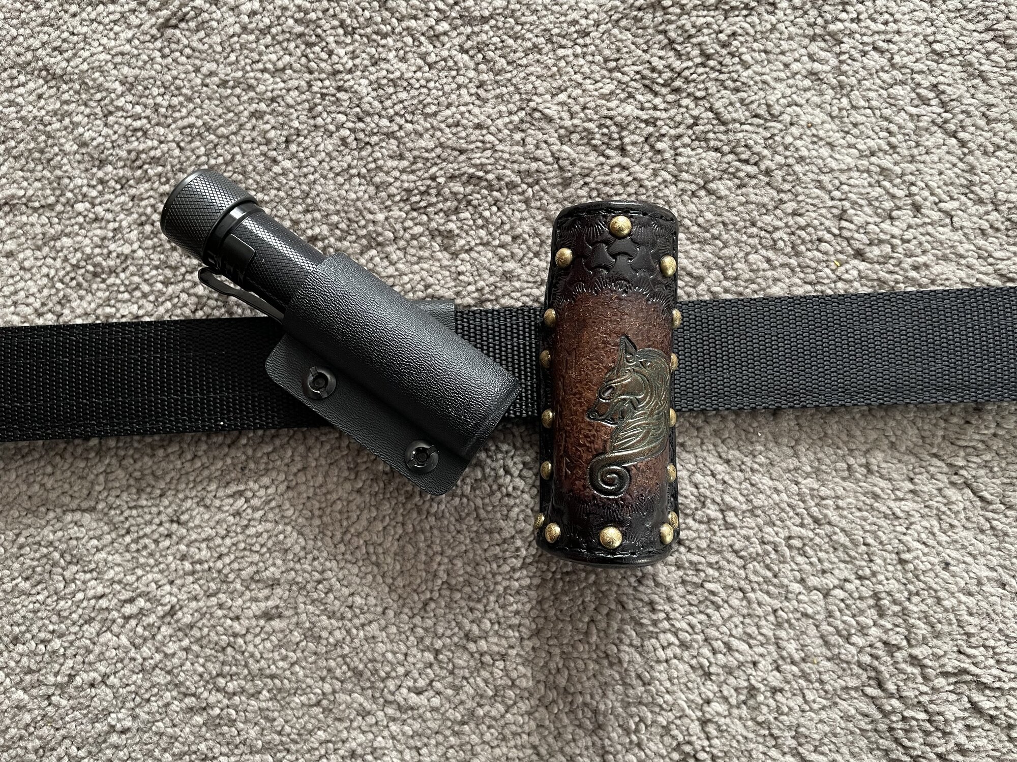

Now that it’s coat weather, I switched from carrying
the 18500 in a Thors Hammer holster to an angled kydex holster- easier to grab under layers.
Love the length of the 18500 and the added runtime means I don’t carry a spare cell unless I have my bag with me.
Still using the NLT- amazingly useful beam.
Of course I will have other lights on or around me, especially at night but the HDS is the one that doesn’t get swapped out.
