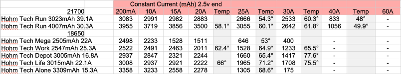

Test results for Hohmtech batteries.

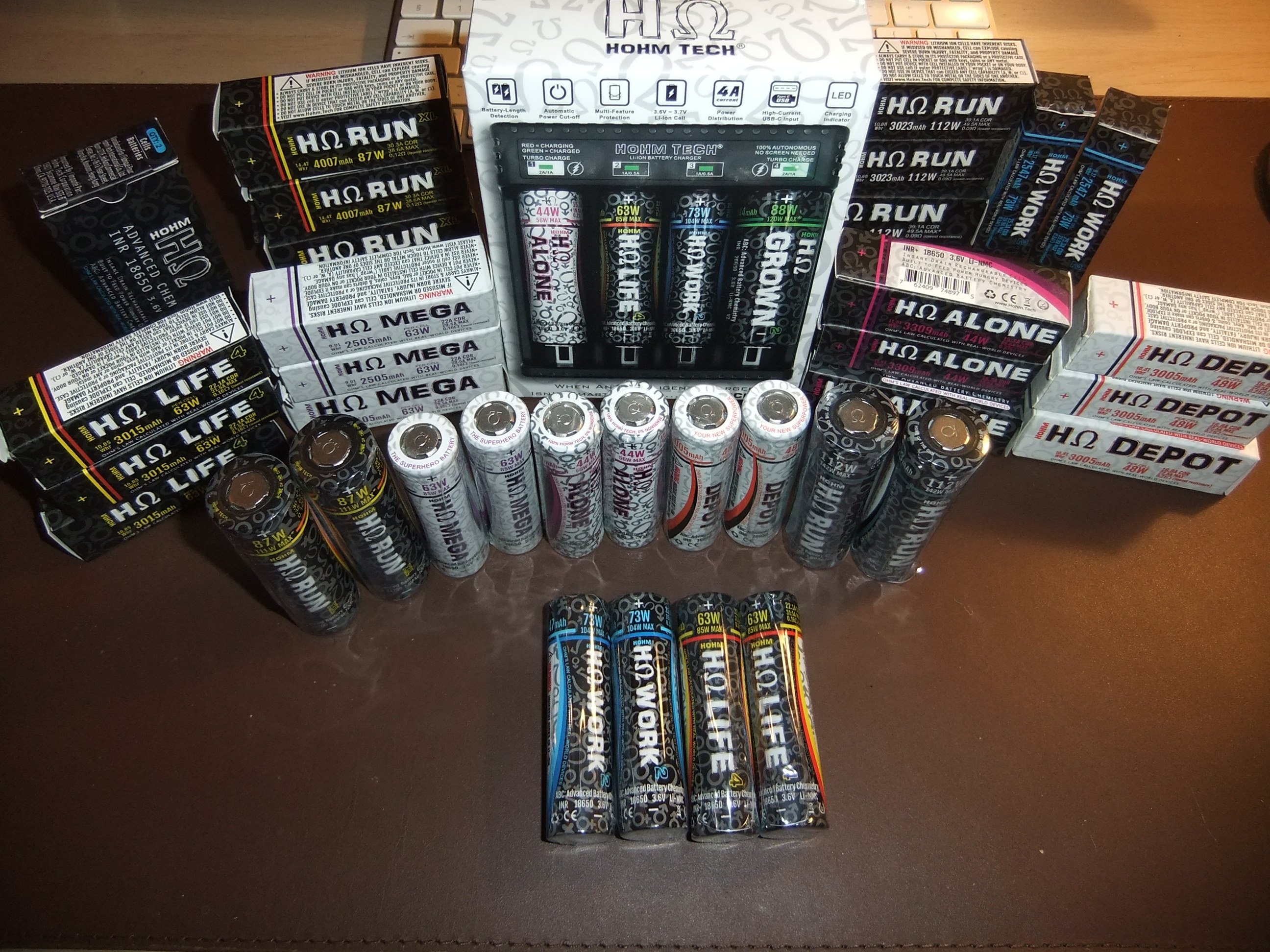

I was impressed with the amount of information on the outside of the batteries. All of the batteries were spot on as far as capacity is concerned. Current rating on the 18650s were pretty accurate too. A bit optimistic on the 21700s by my way of thinking.

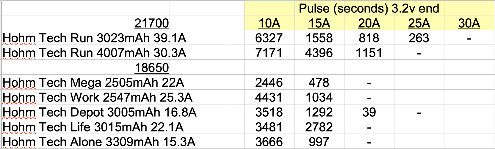

I have posted tables showing the results for all batteries rather than individual graphs for each battery, as there is a lot of similarities between them. The long and the short of it is they all do a good job up to 20A constant current and will deliver to varying degrees up to 30A for the 18650s and 40A for 21700s.
For vaping, you are really only looking at the 3015mAh LIFE 18650 and the 4007mAh RUN 21700, but only up to 15A (20A at a push for the 21700). Only a couple of the batteries got above 70° during the tests which is pretty impressive.
There can be no complaints about a manufacturer putting detailed and accurate information on their batteries, but I reckon the majority of folk will be looking for higher capacity and higher current.
