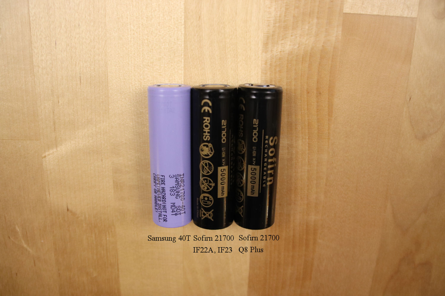

One thing about the Sofirn Q8 Plus though - the cells aren't standard. It's like they got a 1mm riser on their otherwise standard 21700.
The Q8 Plus does NOT work with my Samsung 40T's, because the positive isn't making contact inside the light. And not even Sofirn seems to offer the cells used in the Q8 Plus as a backup set.
