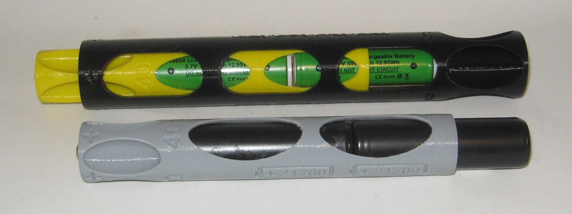

Came up with some new adapters for the 4D ML300 – the gray adapter is a 2X 21700 to 4C adapter and the yellow is a 2X 18650 to 4C. The black adapter converts the light from 4D to 4C to work with the 4C adapters.
Both the yellow 18650 and gray 21700 adapters will work in a 4C incan or in any 4D Mag using the black 4C to 4D adapter.

If need to adjust overall length for protected cells vs unprotected, can the brass screw be shortened, or is that end of sleeve solid material?

The length of the brass screw is fixed in the print. For safety, only protected cells should be used in series and the adapters are sized for protected cells.
