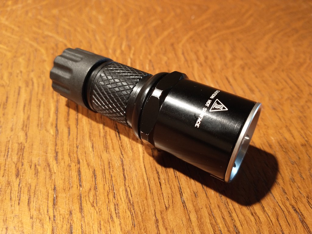

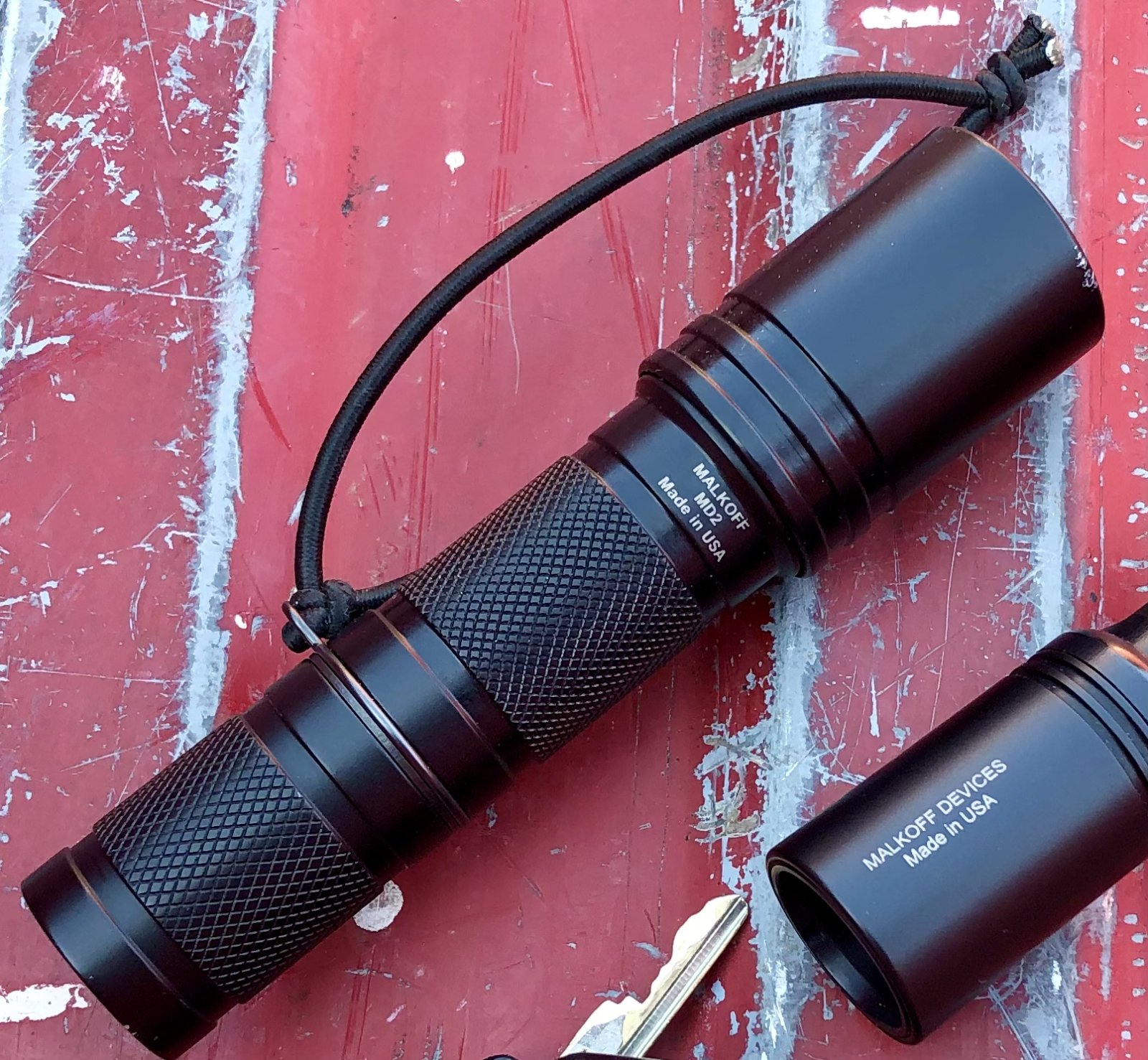

Does an md2 with m91bw count as lego? This is a great setup. More spill and similar brightness to an m61w, maybe slightly brighter. The m91 ran on a 16650 for about 90 minutes so it will do even better with the 18650 of an md2.
Even on an 18350 my m91bw feels like it runs forever. The 91's are seriously such a good drop in.
I bought the m91bw to use in a surefire c3 that I’m still looking for, but there are so many other ways to use it also. Never would I have imagined it’d be so versatile.

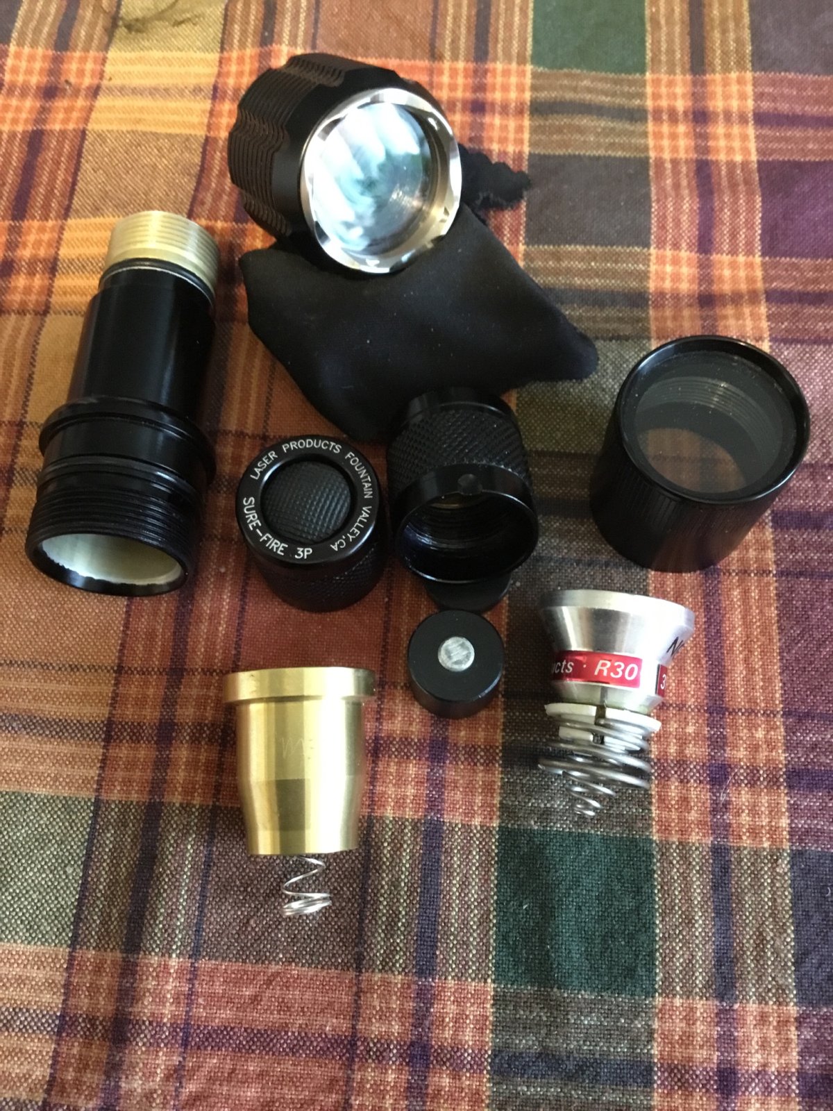

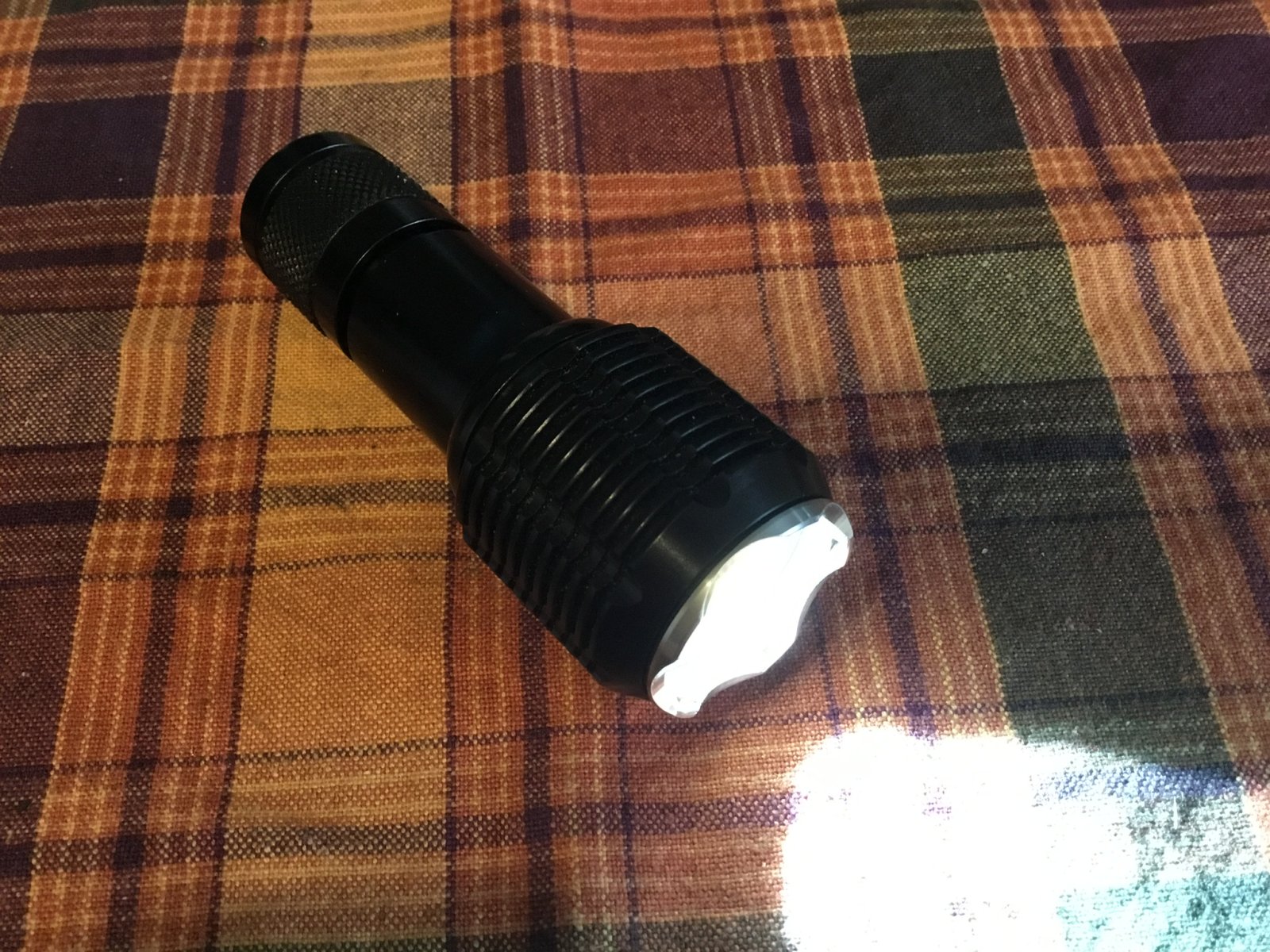

Surefire/Oveready/Malkoff original authentic Vintage Surefire 3P Mint

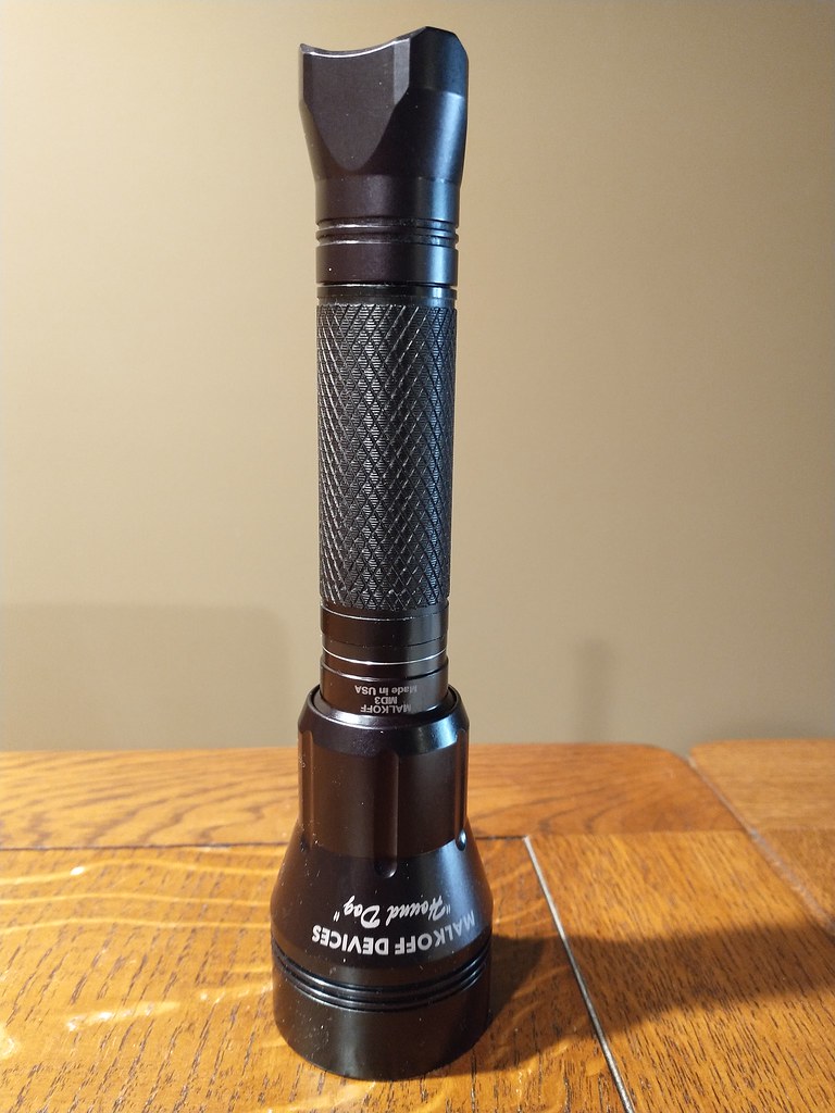

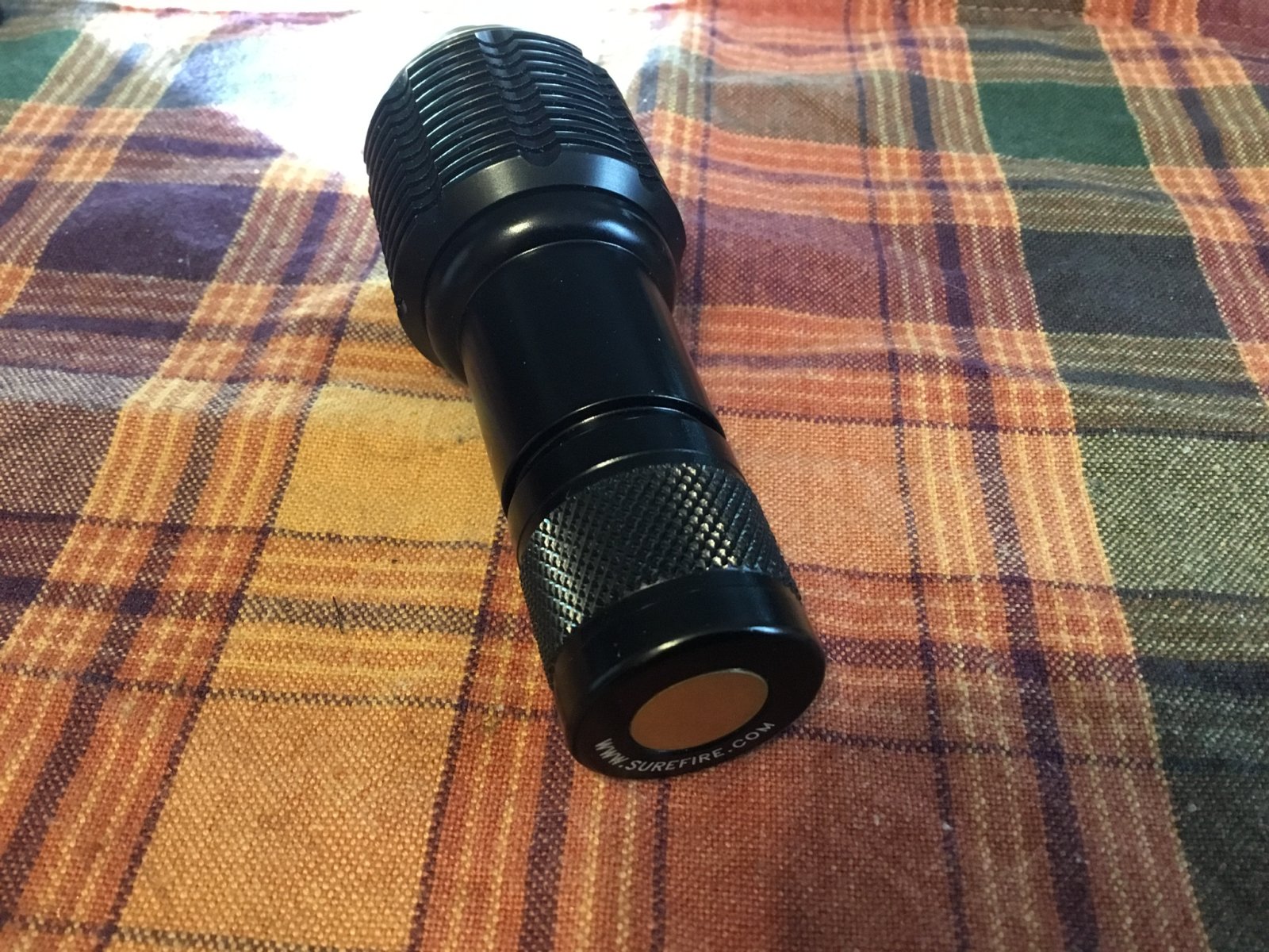

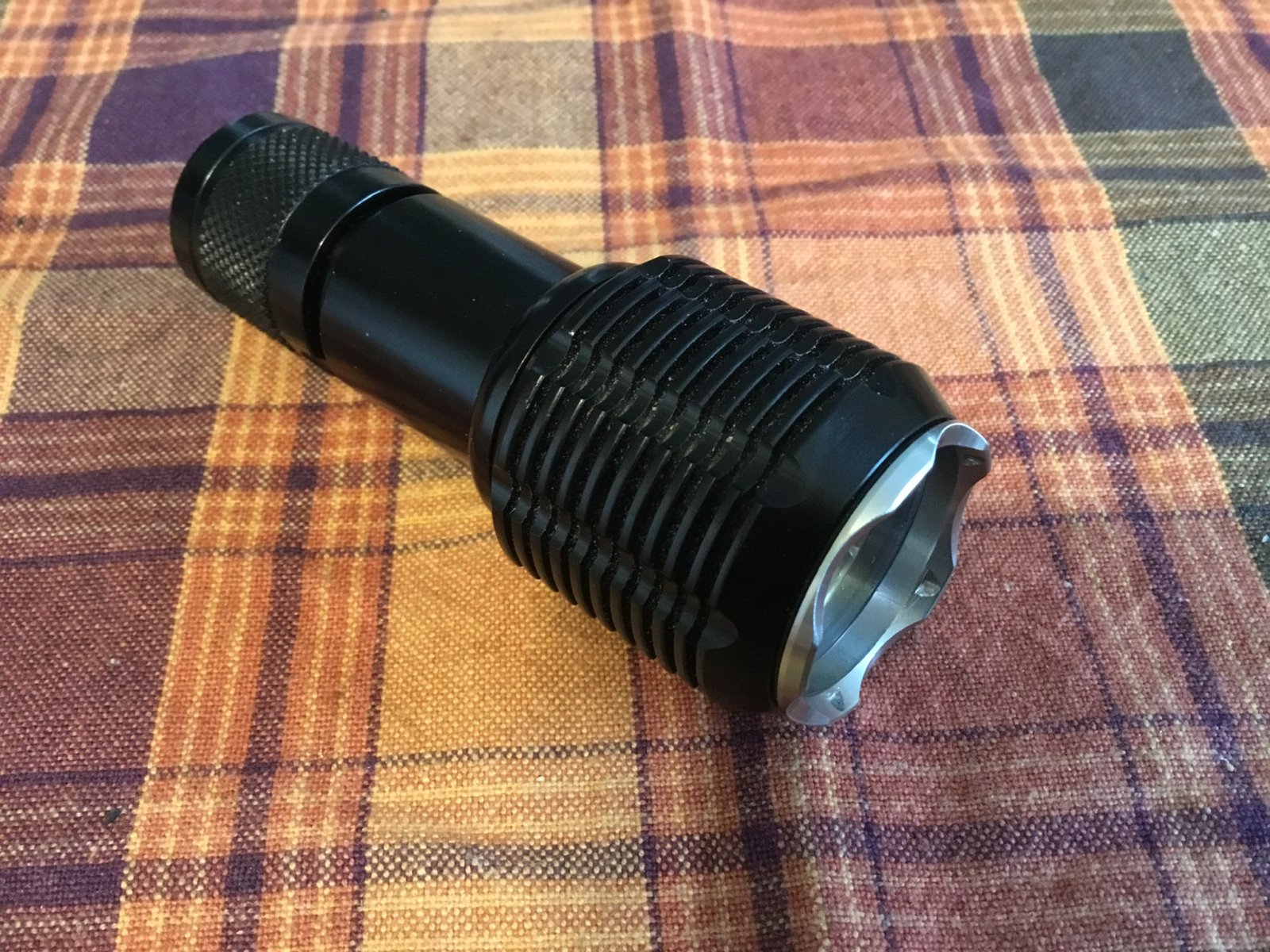

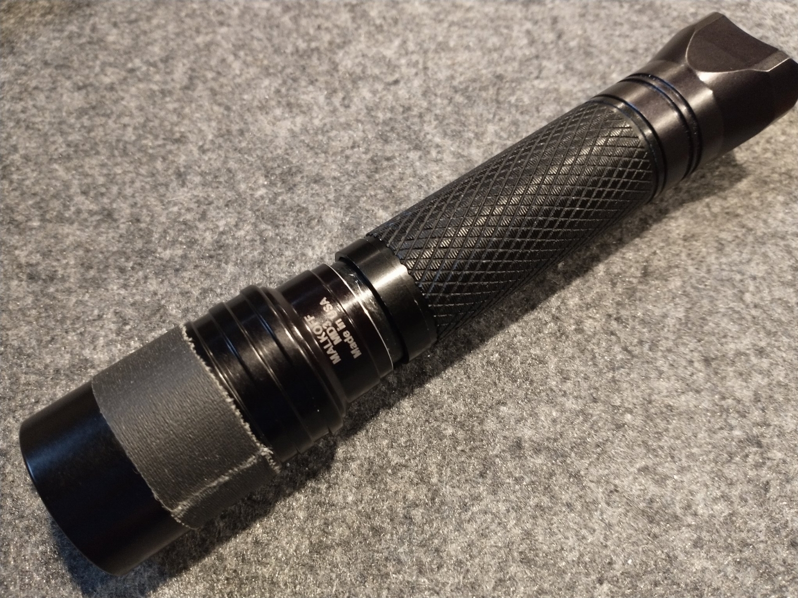

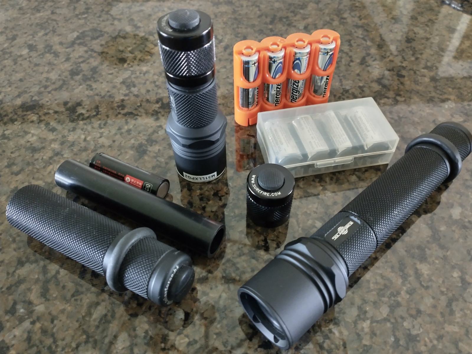

Until very recently I wasn't aware that the driver in the regular Hound Dog v3 had been updated to accept lower voltage. I've been having a bit of fun with it since that discovery. Did this happen around the same time that the M91B driver changed?
This one is a 4000K v3, and I have a 5000K v3 with old style head that doesn't work at 4.2V and below.
Hound Dog 4000K v3 head (w/d-c-fix)
MartinDWhite MD-1
FiveMega 18650 extension
Tri-cap

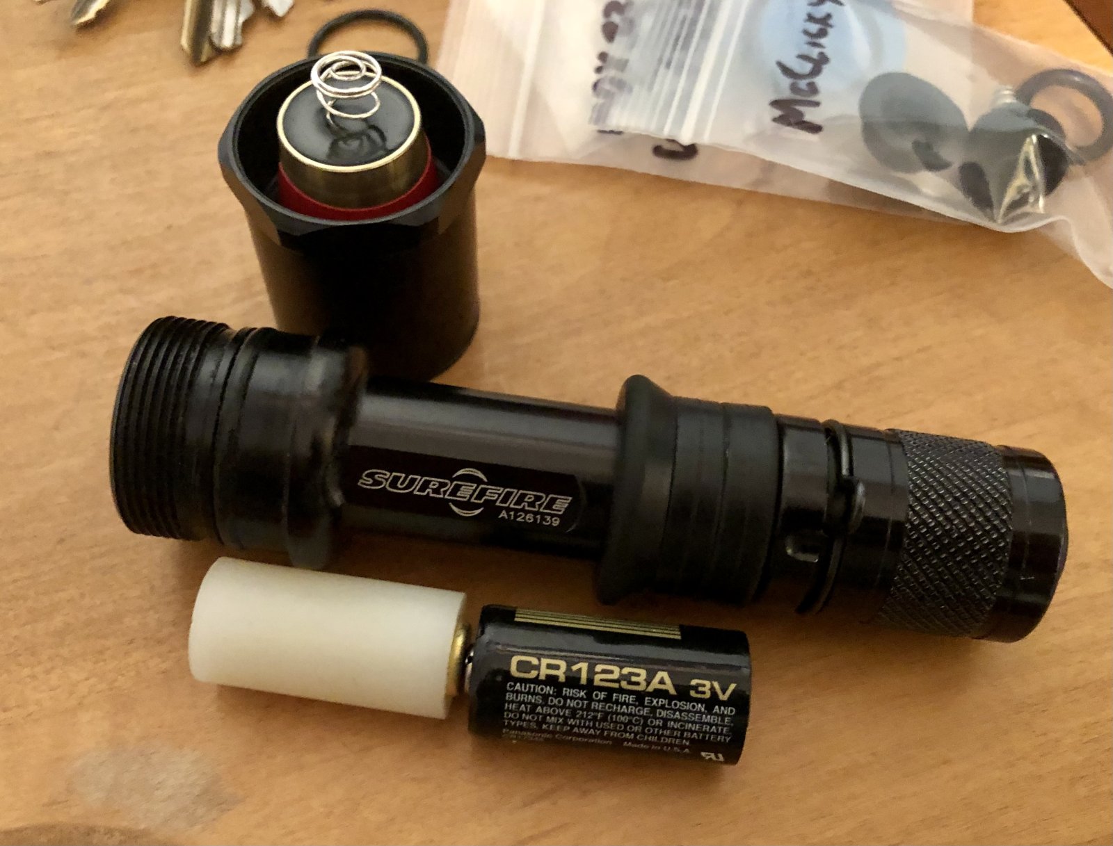

This is what I use around the house and shop to drain the occasional used CR123a. I have a couple of vampires that drain them further at sub-lumen levels when they quit working in this one.

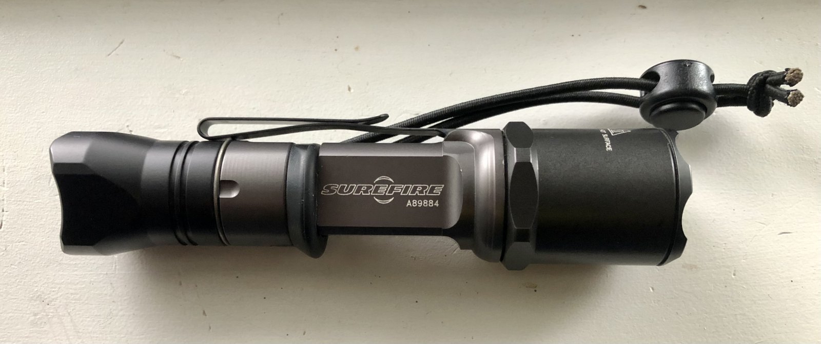

Z44
M31L 219b v2
Fivemega 18350 body
Nitrolon shorty tailcap
MartinDWhite MD-1
Tri-cap
