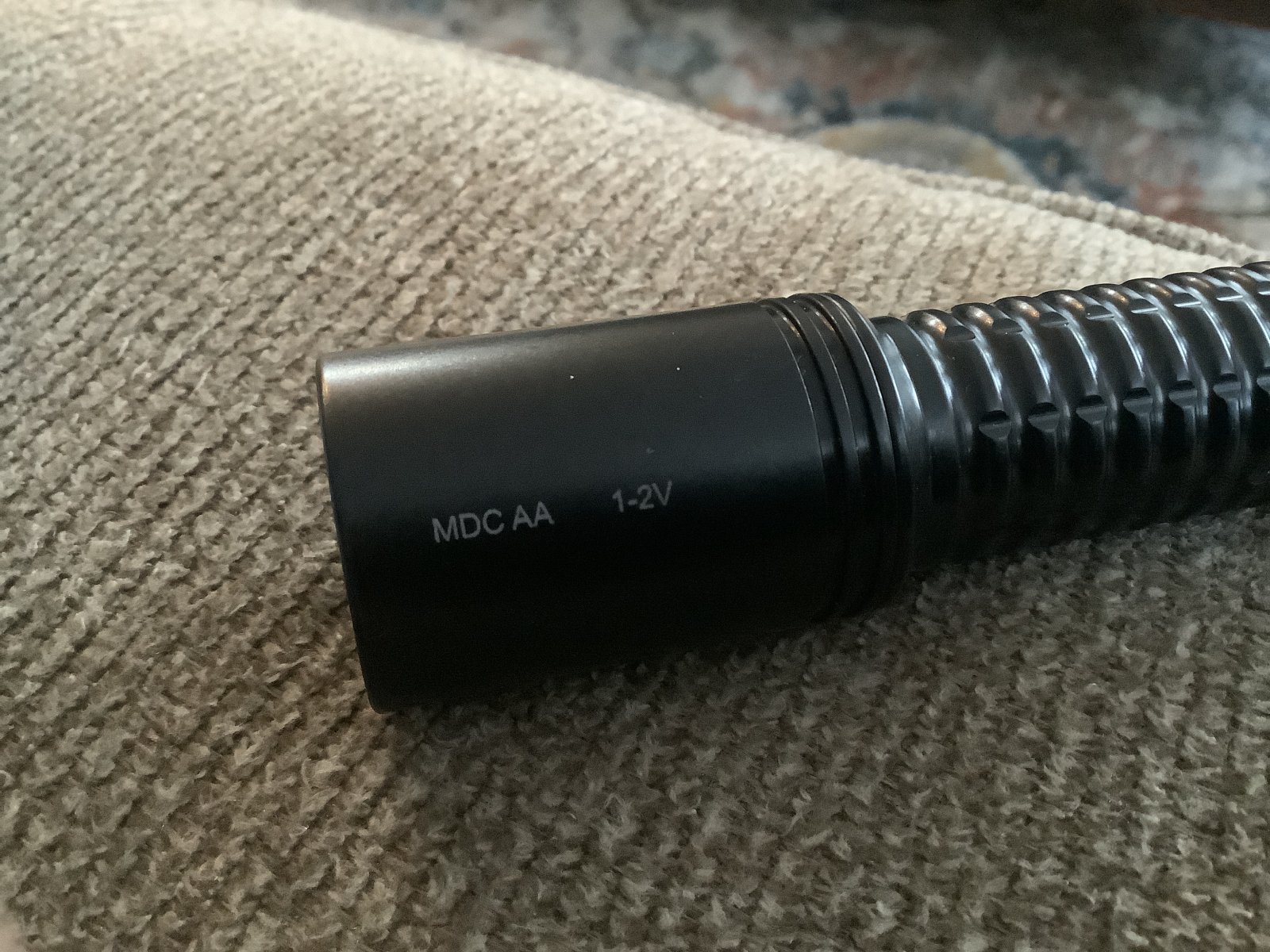

Per the website, recommended is 1.0-2.0 volts (right off the light) with possible erratic behavior above that and possible damage above 3.0 volts. 2.4 is safe and I have not seen any erratic behavior. I also use the single AA head with my double AA tube with two NimH, with similar results.
Right 0.8 to 1.7 volts is the range. so guess your ok with 2.4 if it’s not acting all crazy.

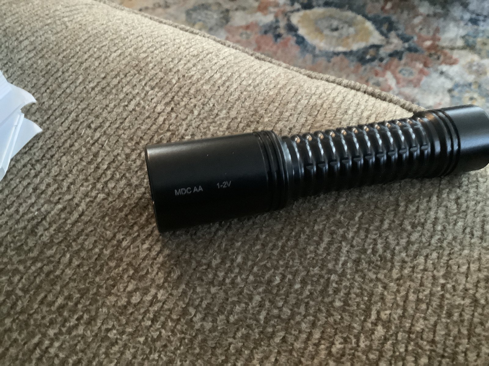

Yes, having great results at this voltage. Surprisingly, while the website says 0.8 to 1.7 volts, the imprint on the flashlight head says 1-2 volts and the website says voltages above 3.3 will damage the head. 2.4 is well below that, so guess I ma good to go unless it starts acting erratically. If it ever does, will post that here.
