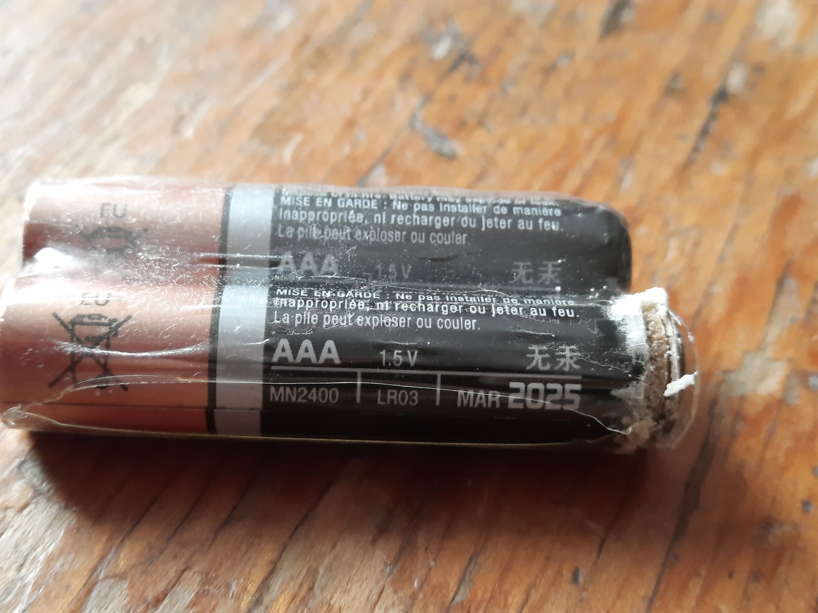

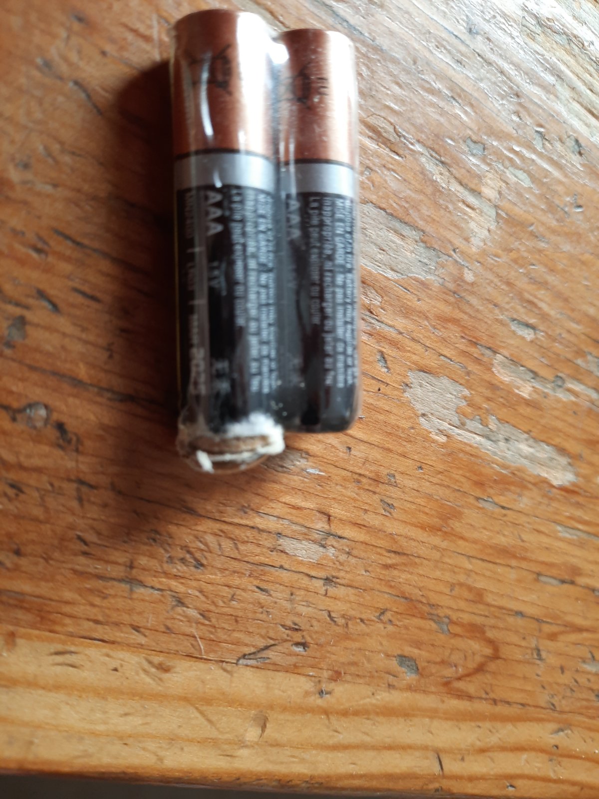

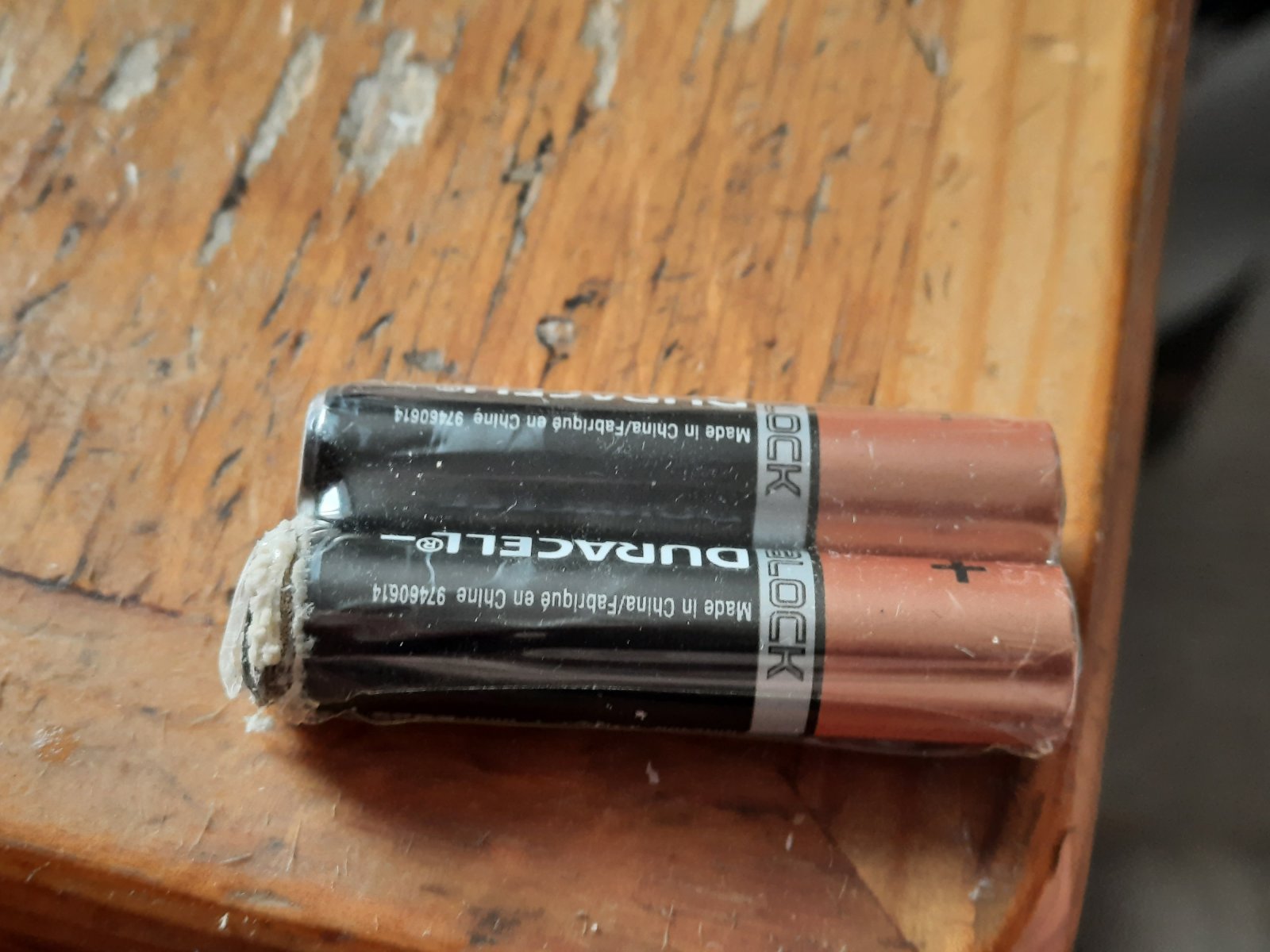

Funny how we have different experiences of alkaline manufacturers.
lately my experiences with leaky cells have been mostly from duracell.
Approx. half a year ago I found a pack of four triple A duracell batteries in my drawer which had leaked. They were still in their blister pack. I can't remember the expiration date.
But as recently as today I found yet another package, this time with two triple A duracell batteries named "Duralock" in the same drawer that had leaked, they were also still in their blister pack. And the expiration date is March 2025 as can be seen.
I think the only alkaline batteries I have good experiences with, in terms of not leaking are 9 volt batteries.
