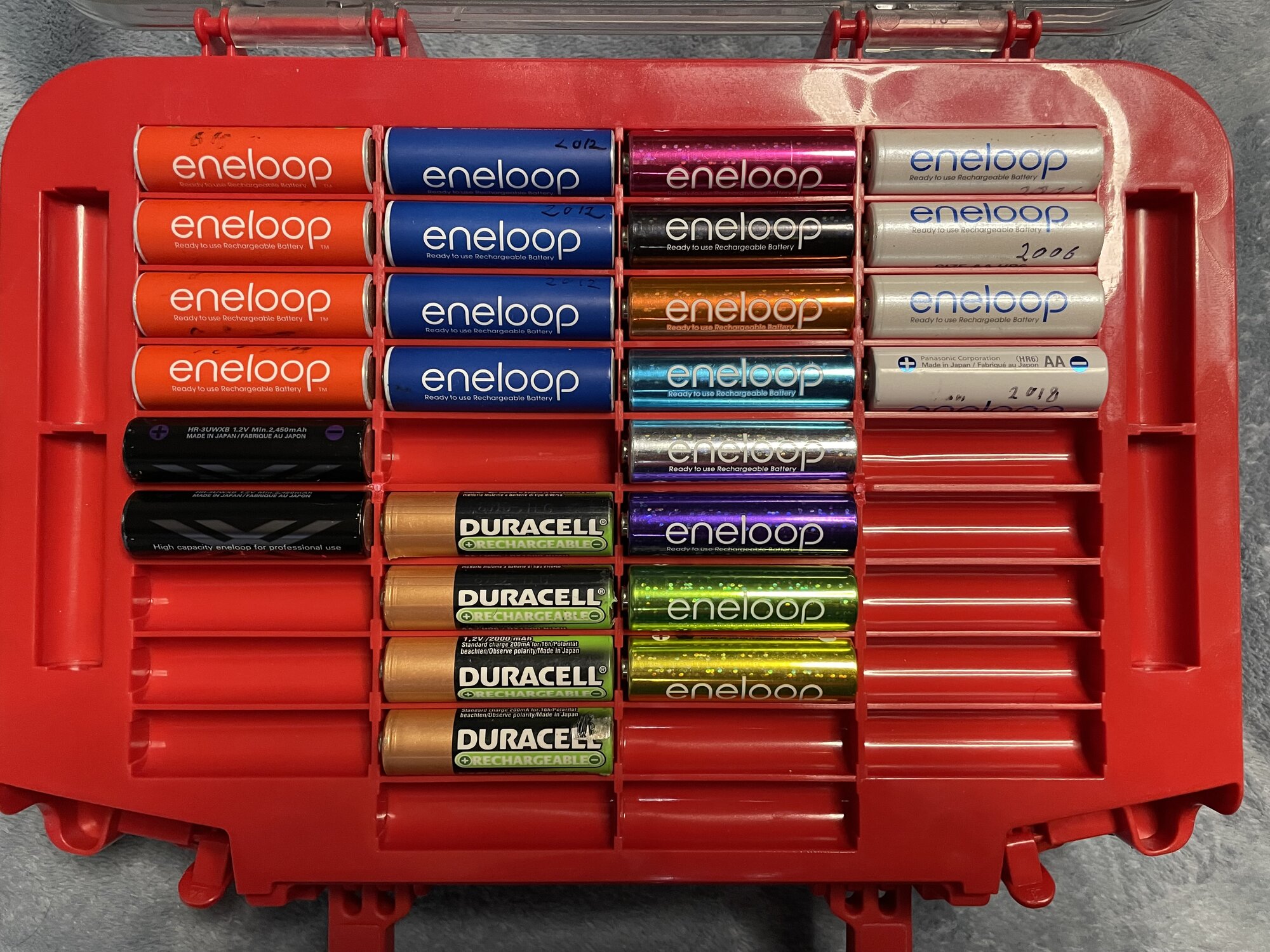

Sharing my Eneloop collection. I tried to pull back 2-4 of each type to take this picture. You see 26, but I have another ~50 or so currently in devices. All of these get used. I'm not really a collector, but I have made an effort to find different colors when I have needed to order. I've also got about 16 AAA's, but they aren't as interesting to look at.
The oldest are from 2006 manufacture, and they test out to a little under 1400 mAh, so they have lost some capacity, but they are still maintaining their LSD properties well. I had one fail after physical damage…. I thought I had retired 2, but I found 11 of my 12 originals, so I must have killed one of the newer ones instead. I've also got 4 2006 AAA's still going strong… I managed to kill 4 of those in a device that had a parasitic drain that caused them to be completely discharged for some long periods of time.
Sanyo
2006 - White
2008 - Duraloop
2009 - White
2010 - Tones Glitter
2012 - Blue Costco
2013 - Black XX
Panasonic
2017 - Red / Orange
2018 - White (not shown)

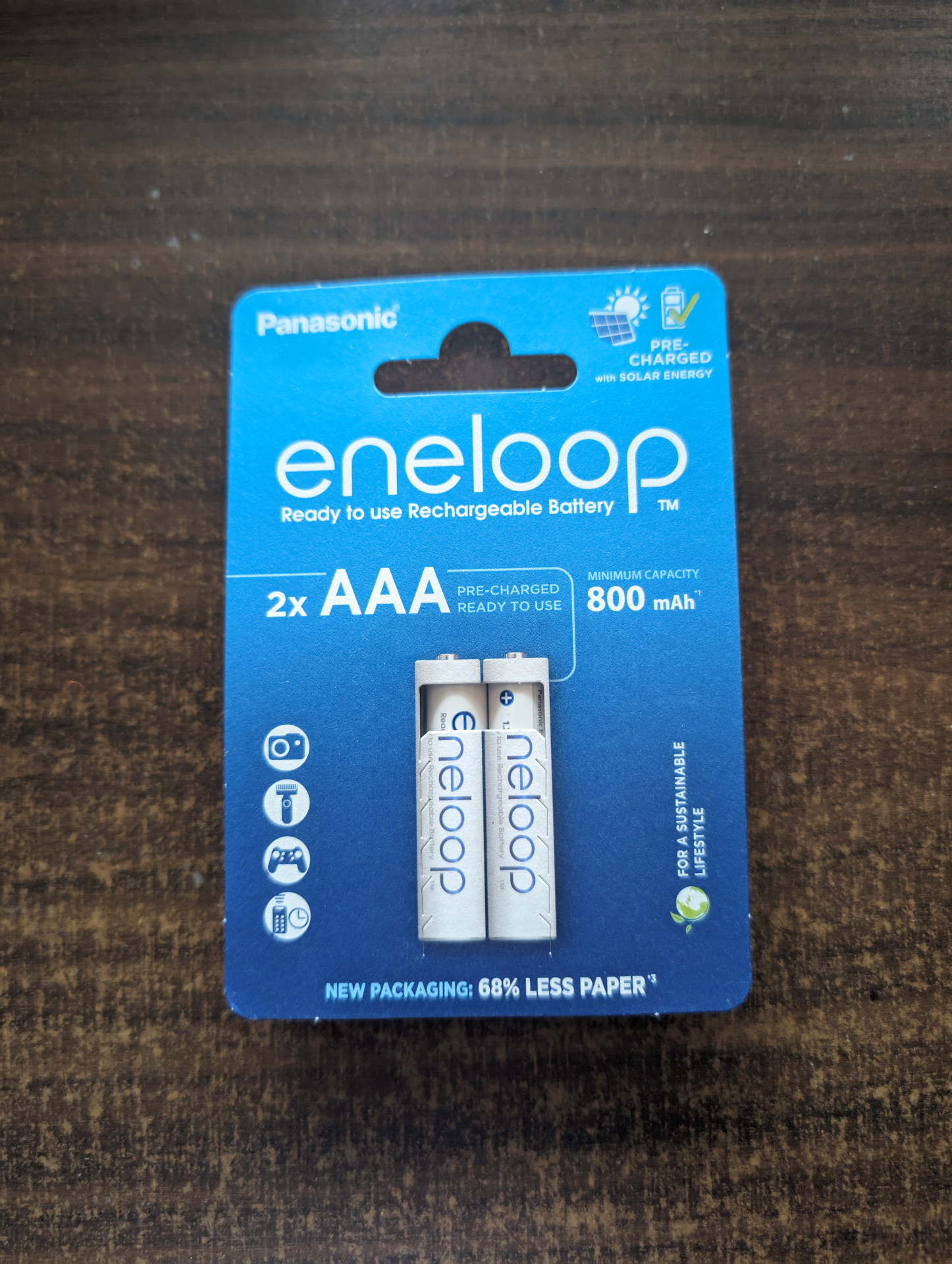

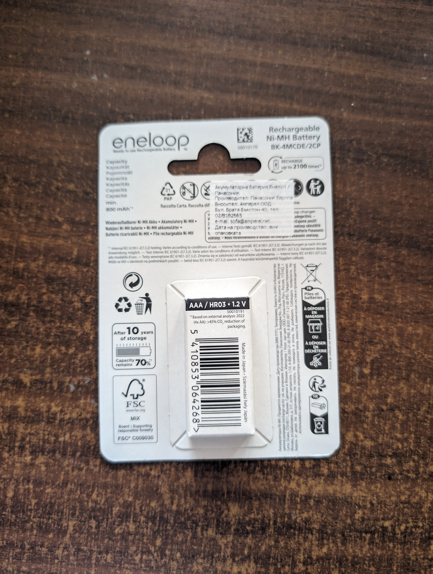

So yesterday i had to go my local Technopolis, its a appliance big store (i don't know how to say otherwise), and i was buying a device that required ААА batteries, because of that i bough of course Eneloop, but to my surprise there was a new packaging for them. So as i was buying them i didn't really check to see if they are made in Japan, but they are, however on previous packaging there is a date of manufacturing while here there isn't. I took photos and here is the new packaging.
    737.8 KB
    711.7 KB
That is something that personally i didn't know also i don't think they look strange, but it was just something i didn't get to see that much since i don't follow the packaging that close and i didn't know the different versions.
