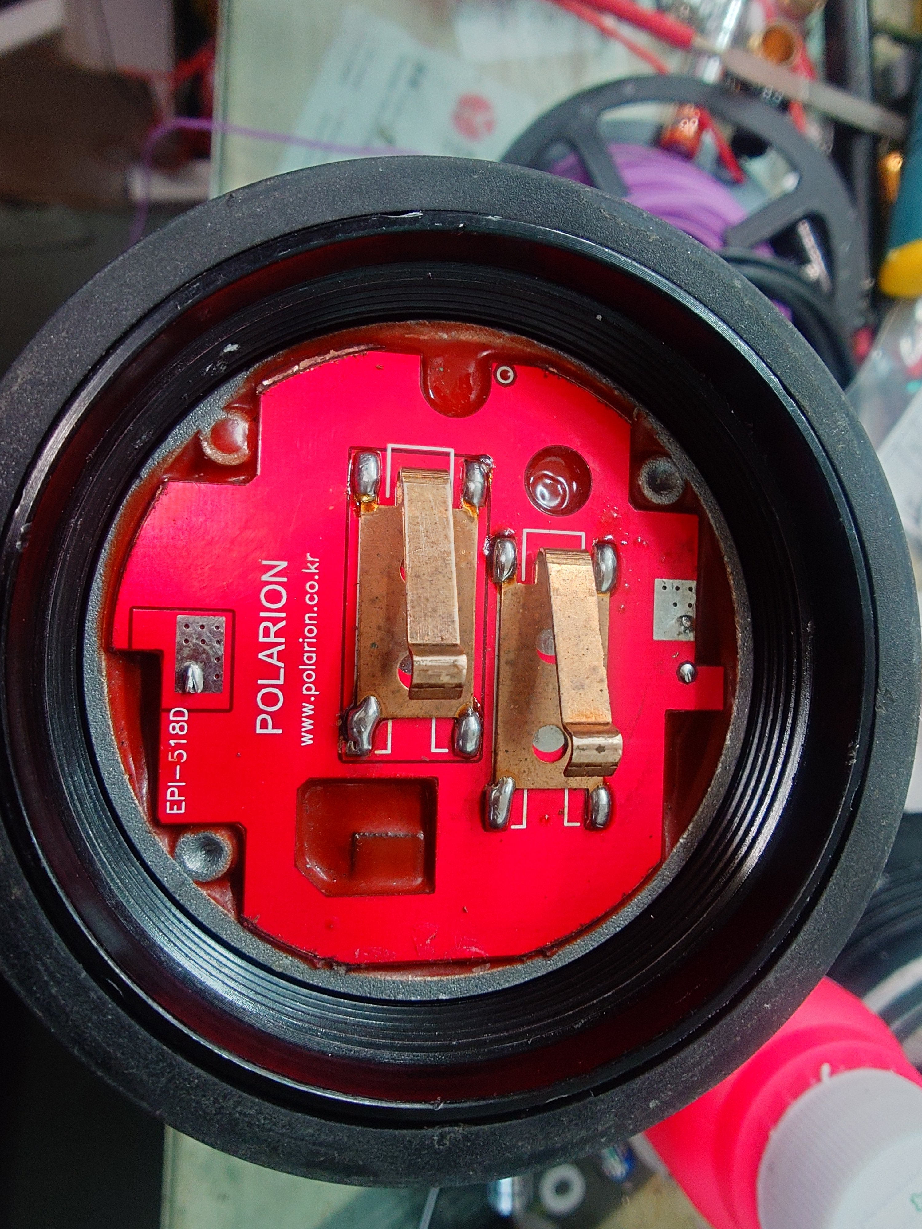

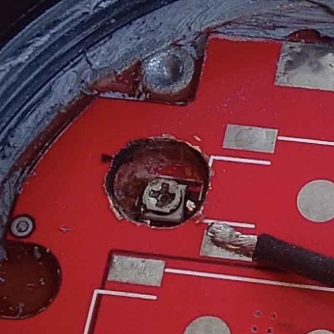

Top right. The potentiometer slot is blocked with epoxy.
Pull out the to the potentiometer. If broken, replace it 1 kΩ POT.
Operating the potentiometer will increase or decrease the output.

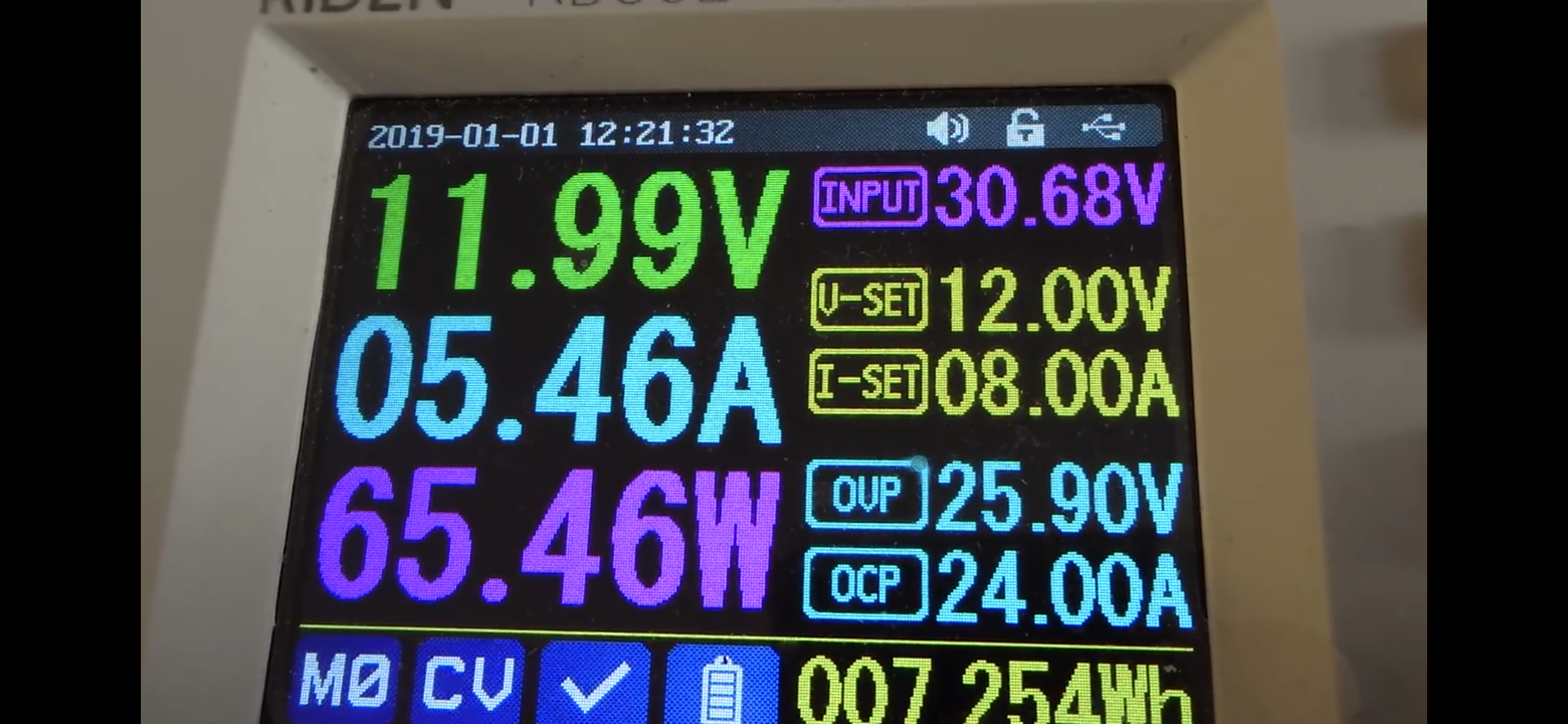

I temporarily soldered the wires to use the load tester.

When set to 65W, the starting output reaches 80W. After about 20 seconds, the output stabilizes and quickly decreases to around 65W, remaining there (with slight fluctuations).
