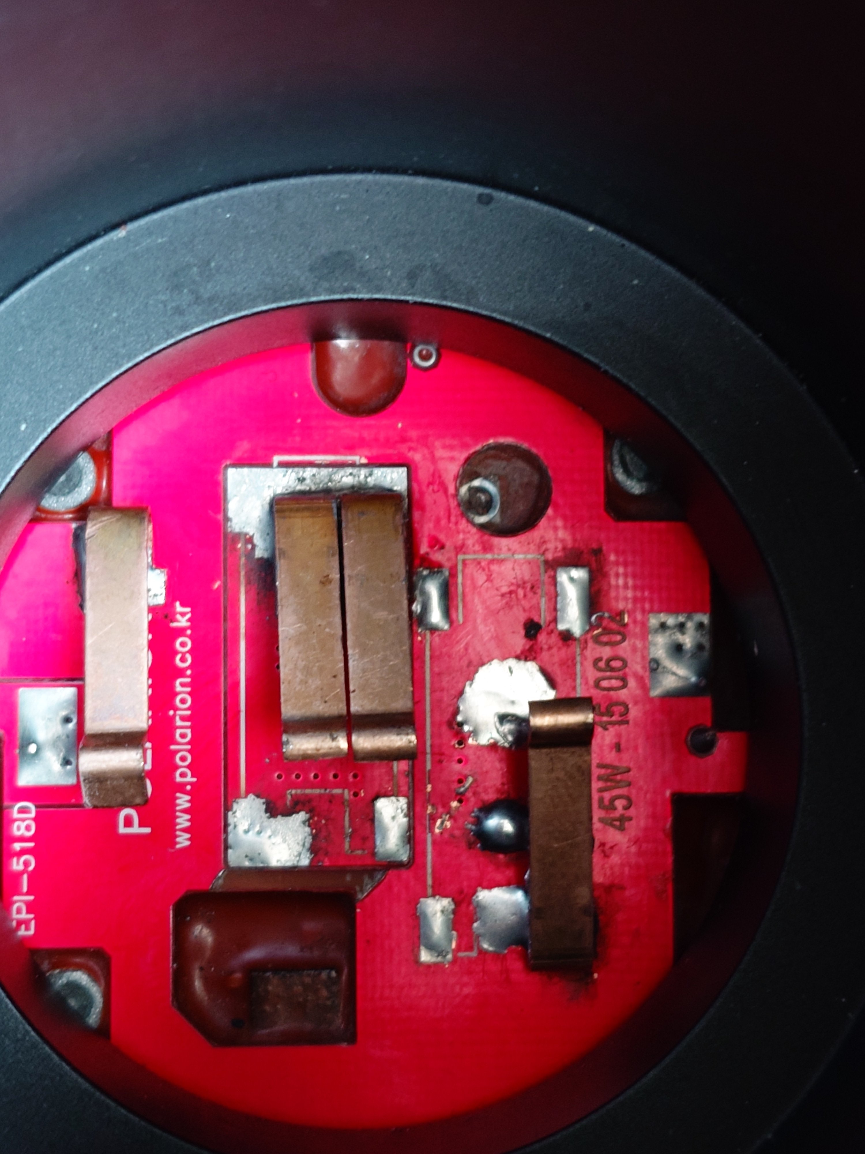

1. Lamp power - 40w to 50w (you can max 70w @ 12v reached it. But "considering very high heat-up thermal" condition, need to manage heat-up)
★ you can see "POT by 2' o clock. This cannot be manipulated at all because it is normally buried in epoxy. However, if you drop a large drop of paint remover (a powerful, toxic, and foul-smelling substance used in industry) and wait for about a day, the epoxy will break down into pieces, revealing the POT.(potentiometer, POT)
Be warning!!
By manipulating this POT, you can obtain a very high output of over 12V @ 100W, but you must sacrifice unbearable heat and extremely short battery runtime. Even when using the 18650 35E (3500mAh cell x8 EA) described below, the limit is about 1 hour and 20 minutes based on a lamp power of 55W.
If you use more than 50W, "you must absolutely not operate it indoors." The temperature of the battery tube heats up to around 60 degrees, and the stock protection circuit fails due to overheating. (Mine already failed, so I replaced it with a Chinese 4S 20A BMS.) If you are considering super overclocking above 50W, please make sure to do so in conjunction with the 21700 large capacity tube upgrade mentioned below.
2. Battery - 18650 35E upgrade. It much more runetime or sacrifice runtime and gain the more power.
3. Pin - Suitable huge current upgrade. double pin is more can handle huge current.
