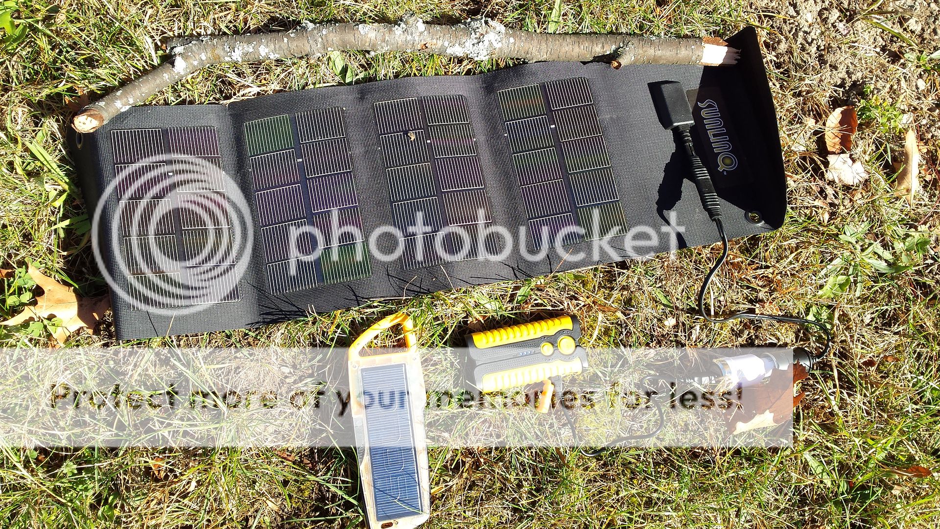

We need pics! :) I charged two 18350 cells yesterday with my little powerbank in the OP, it shut off at the end of charging just like I had hoped. Today, it will go outside to recharge via solar panel. I'll keep you posted.
EDIT- Charging in the sun with my Sunlinq flexible panel. Small Solio was feeling neglected, I had not seen it in almost a year. Figured a day in the sun can't hurt, hope my neglect didn't ruin the cells...
