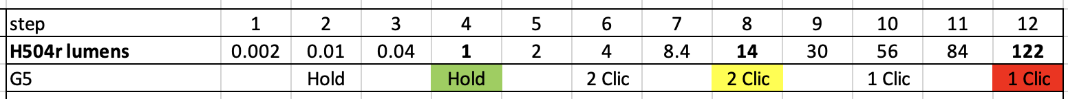

here are the website outputs for the 504r
step 4, 8, 12, (green, yellow, red) are defaults.
Their secondary modes, step 2, 6, 10, are toggled by doing 2 Clic from On.
Odd numbered outputs can only be activated by getting into the programming function.
