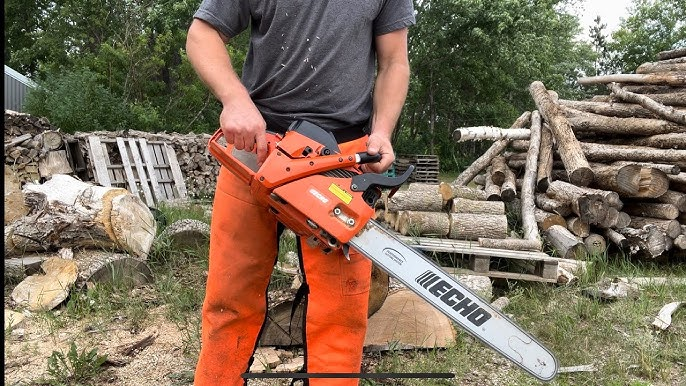

Good thing I own a ECHO CS-680 chainsaw 24" bar
stock pic
