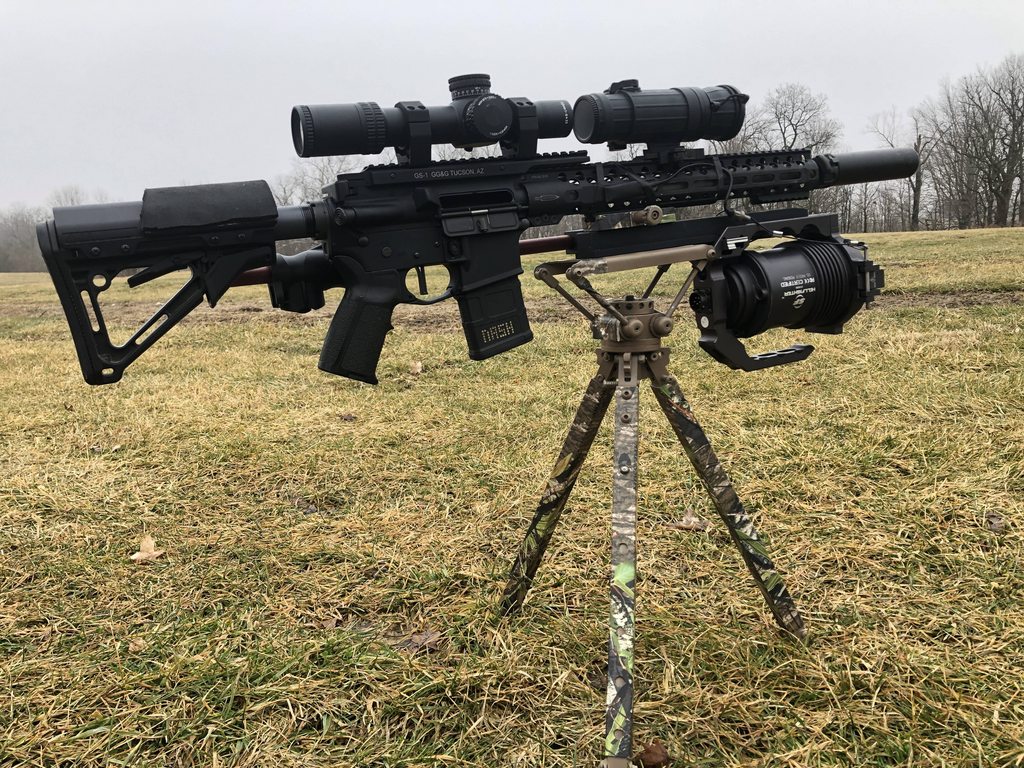

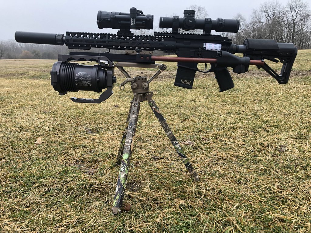

Thread resurrection time!
I recently purchased a Hellfighter in very good condition and I'm excited to finally have one after lusting years ago. I had an adapter made to attach it to my rifle tripod and I plan to use this setup with the IR filter to put some coyotes down with it.
I have an Amphenol connector coming tomorrow so I can get started on a power cord. I was wondering if anyone happens to know the model number of the female Amphenol connector that would plug in to the male? I'd like to have a short cord where I can use the Hellfighter as a handheld spotlight from my truck and a much longer cord I could use to get the rifle/tripod/Hellfighter setup a ways away from a 12v source.
Here's a few pics of my setup:

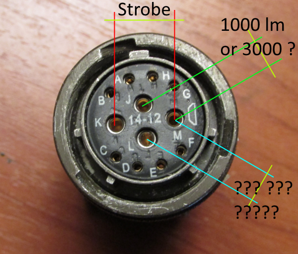

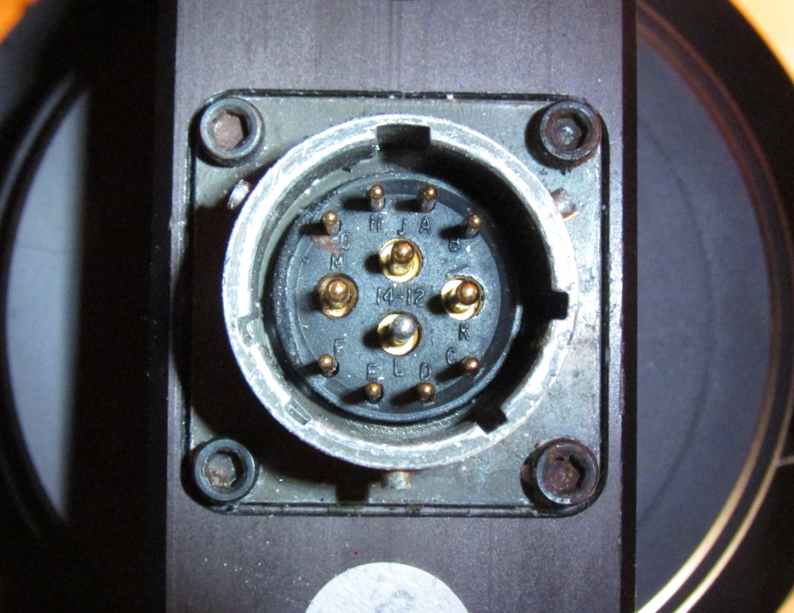

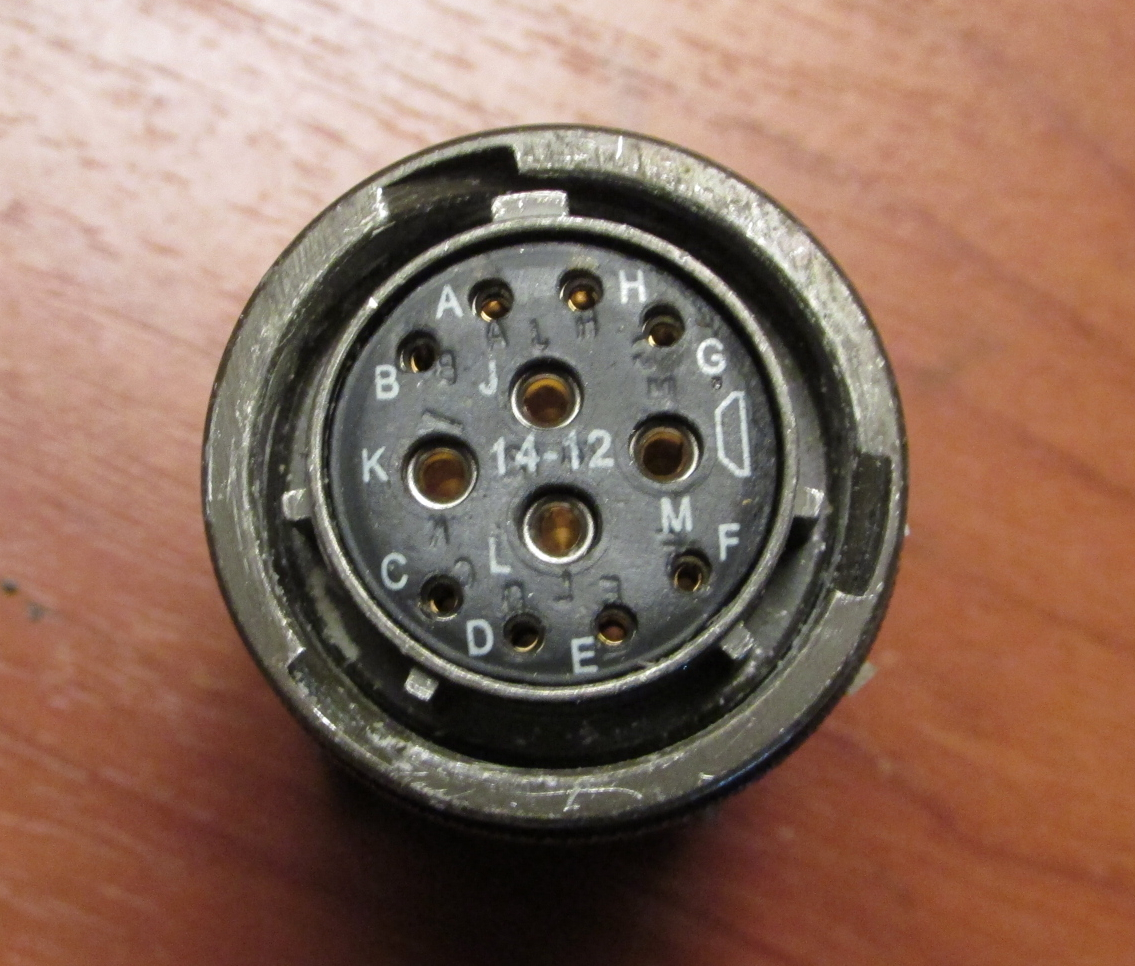

I wonder if anyone knows why the 12 pin connector?
Definitely, power should be supplied to 2 of the 4 central ones, now we need to determine which
I came across a similar thing in power plants, sometimes there is a connector like a bendix for 40 ~ 60 contacts and only 30-40% are involved in them, the rest are empty, maybe it's the same here? Or is there an opportunity to run SOS, various strobe lights or weaker modes? Although I doubt it
This connector MS3116P14-12S Amphenol.
Specification:MIL-DTL-26482
Sealing:Sealed
Shielding:Yes
Connector Type:Circular
Connector Style:Plug
Mounting Type:Cable
Contacts, # of:12
Contact Style:Socket
Termination Method:Solder
Insert Arrangement:14-12
Contact Size:8#20, 4#16
Contacts Supplied:Yes
Contact Material:Copper Alloy
Contact Plating:Gold
Shell Material:Aluminum Alloy
Shell Plating:Olive Drab Cadmium
Shell Color:Olive Drab
Insert Material:Neoprene
Grommet & Seals Material:Neoprene
Amperage Rating:13A & 22A
Operating Voltage AC V RMS Max:600
Operating Temperature °F (°C):-67 to +257 (-55 to +125)
Contact Mating Life:500
Insert Rotation/Keying:Normal
Operating Voltage DC:850
Orientation:Straight
Service Rating:I
Endbell Type:Potting Cup
Export Class:EAR / EAR99
RoHS:No
Or someone changed the standard 5-pin connector to this

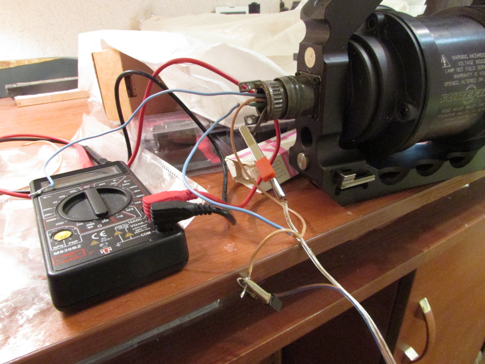

I found another HF owner on a local forum, he also has a 12-pin connector, which means SF made them for some specific purpose. Perhaps there is a weak mode for 1000 lm, and other types of strobe lights. I think we need to solder all 12 wires and close them in different combinations.
I decided to solder 4 wires for now, I use the power supply from the LED monitor ADPC12416BB 12V 4.16A, while I found only a stroboscope on terminals K and M or am I mistaken and the power supply from the computer monitor simply does not have enough power?

That's a military connector. I believe most of these were used by the military/government. Maybe ?
In all SF catalogs, and here on the forum, I see only 5-pin connectors. On the SF website, cords are also sold with only 5 pins. Perhaps I missed something, while there remains a way to iterate over the pins to determine what they turn on and off. In my opinion, 5 pins are better for the military connector, they are thicker and more reliable than the 8 thin pins in this connector, although the other 4 pins seem to have the same diameter. Although I know some soldiers, it's better for them to have 2 connectors with 1 very thick pin, and one connector is larger than the other, so as not to mix it up. And it will be harder to break
Something cleared up, I ordered a suitable power supply, it will be necessary to find out how all the other 10 pins are combined. It seems that the trapezoid icon on the connector seems to indicate minus or ground
Strobing is bad for HID unless its fully warmed up first (say about 30 seconds on initially), then not so bad. I dont believe they had a dual power output on these, either on or off. Strobing is caused by the inadequate power supply, momentary inrush current is at least double or more of steady stare power requirements.
desert.snake
May 8, 2017
2,080
Eastern Europe

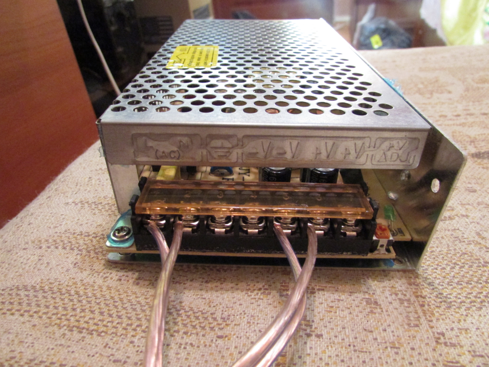

Yes, you are absolutely right, this flickering turned out to be due to a weak power supply. I connected a powerful unit for 12V 10A, tried all combinations of wires, only one works between pins K and M. That is, it is a standard HF with 1 operating mode but with 12 pin connector
Makes no sense they would use a connector with so many pins, you could slightly remove the connector from the light just enough to see only 2 active wires inside the connector actually serving the light.
