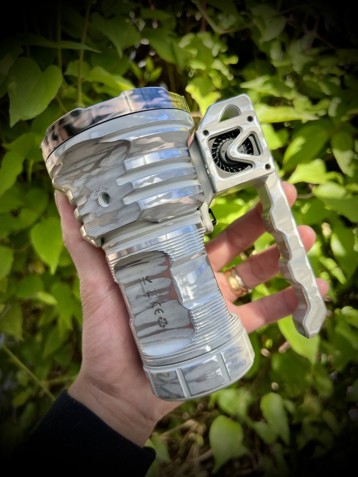

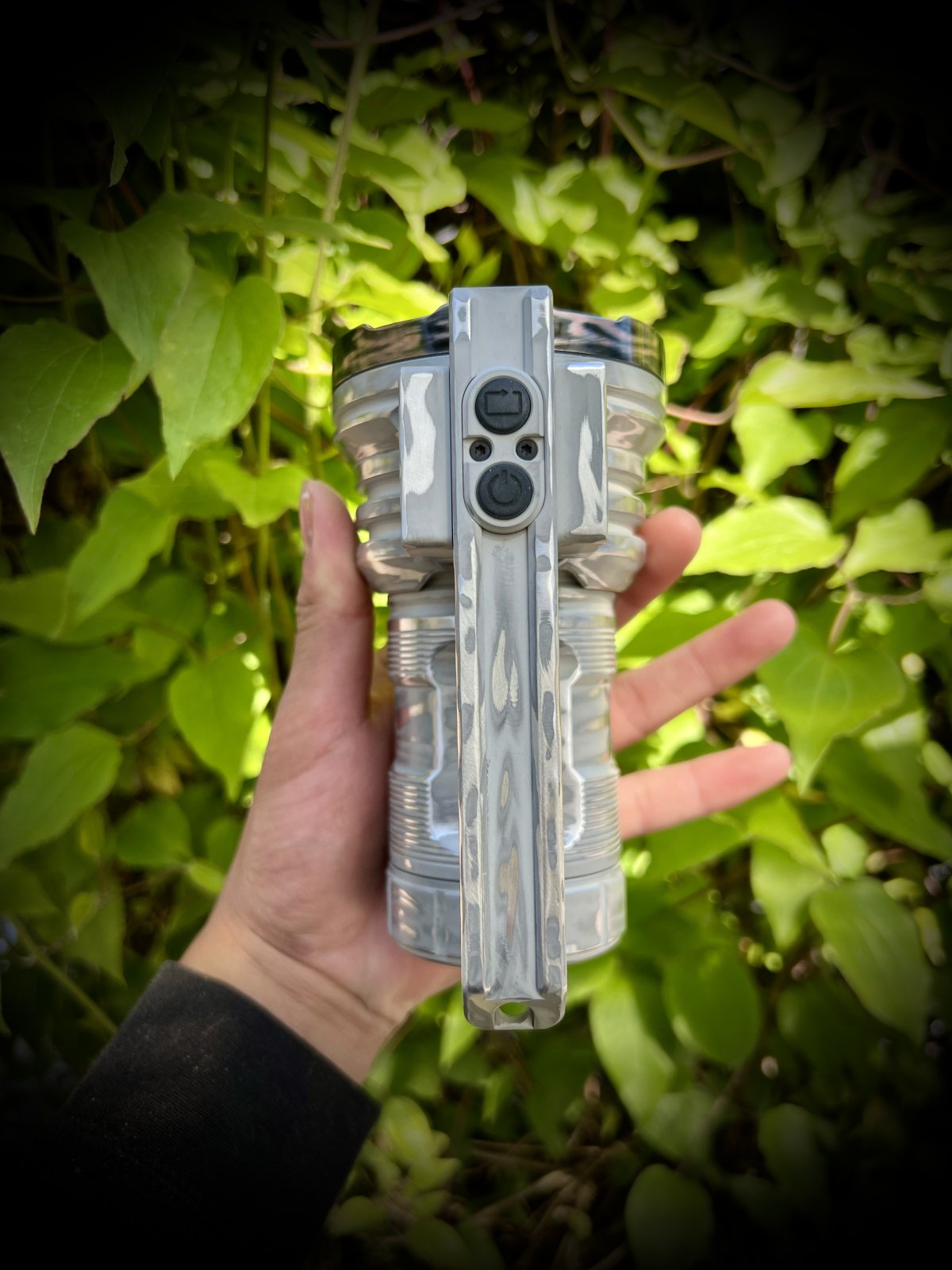

Manker CrownVN - World's First Electrochromic Flashlight
The one of the few lights that I have to first break before I can mod :-)
UpClose Video:
Purchase Here: https://skylumen.com/products/manke...hromic-flashlight?_pos=1&_sid=6a8240e4c&_ss=r

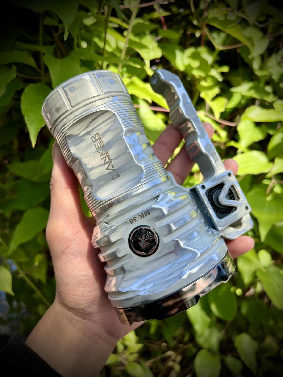

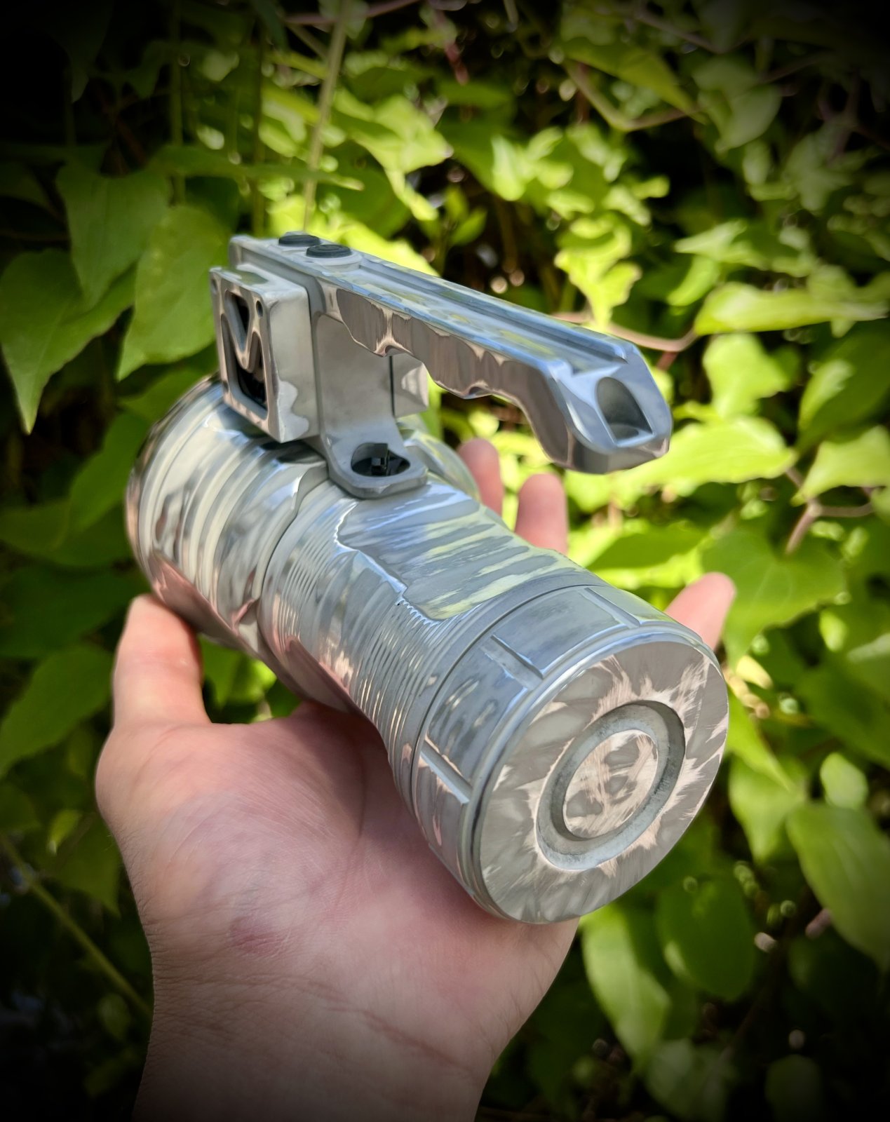

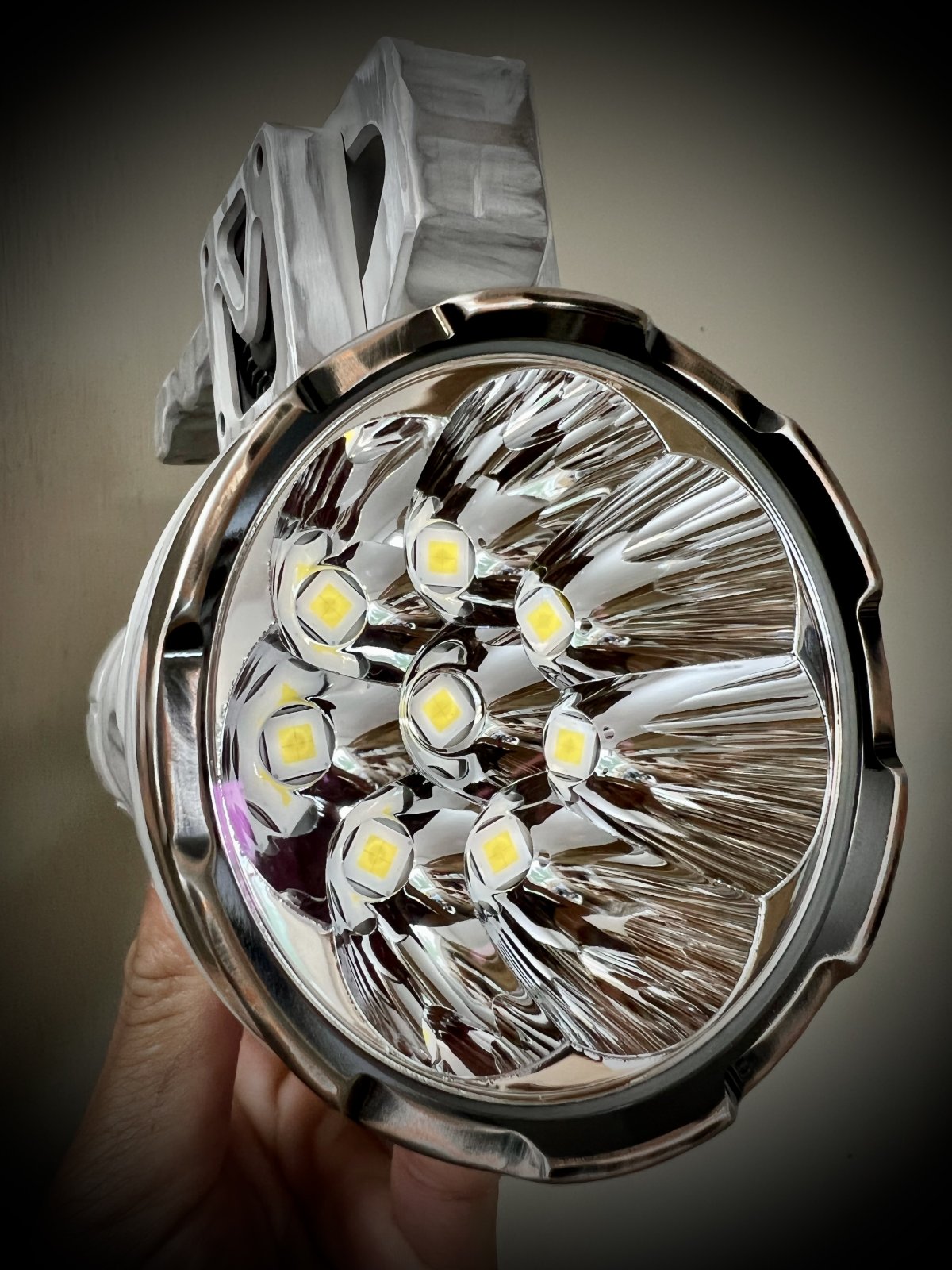

Manker MK38vn
XHP70.3 HI 6500K 80CRI @2s 31,000L, 255Kcd, 1010m
Wonderful blend of Compact, Output, & Intensity :-)

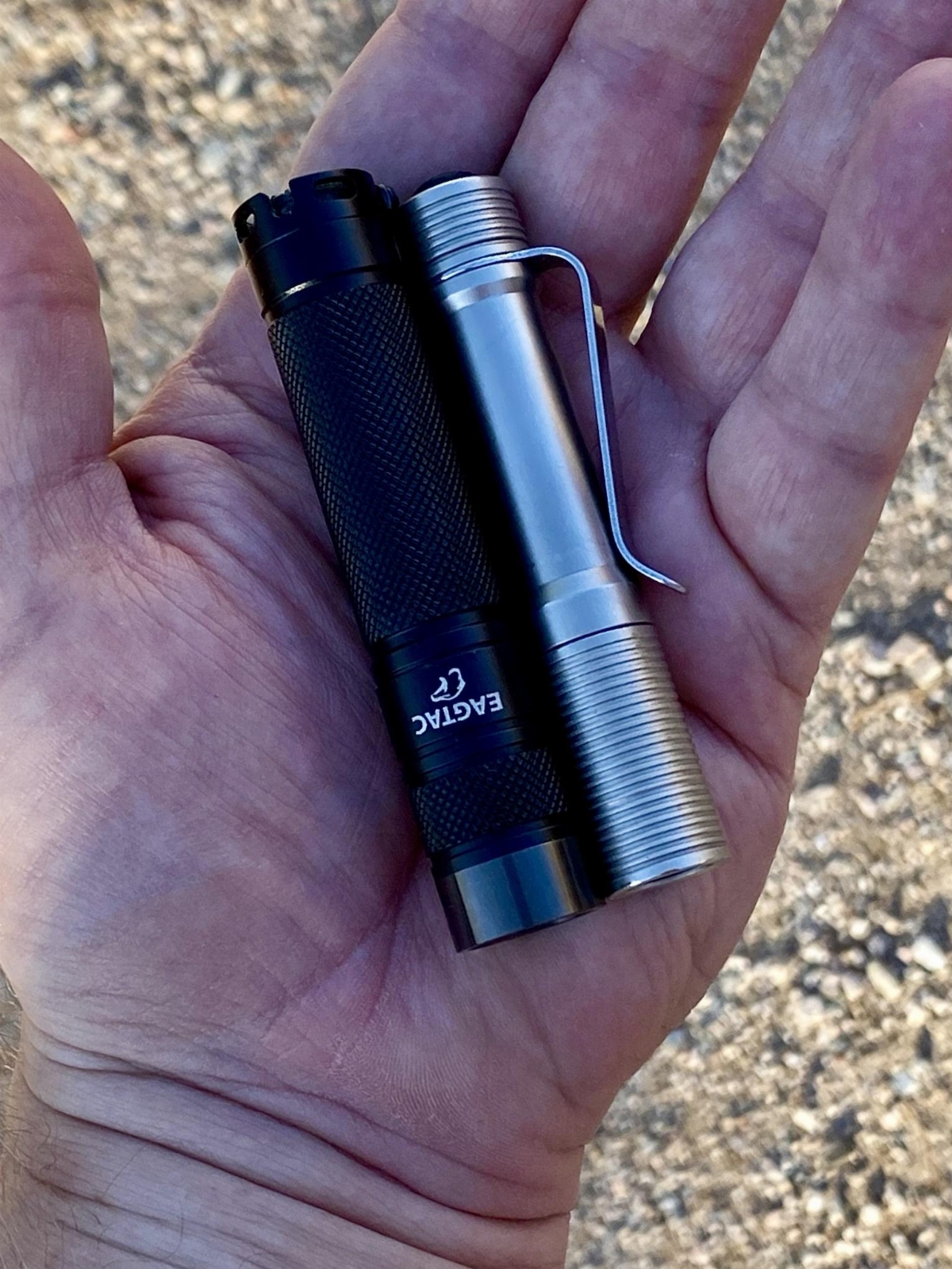

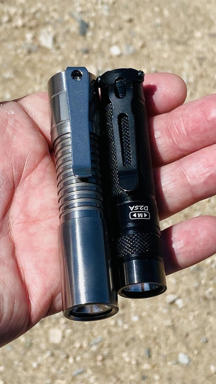

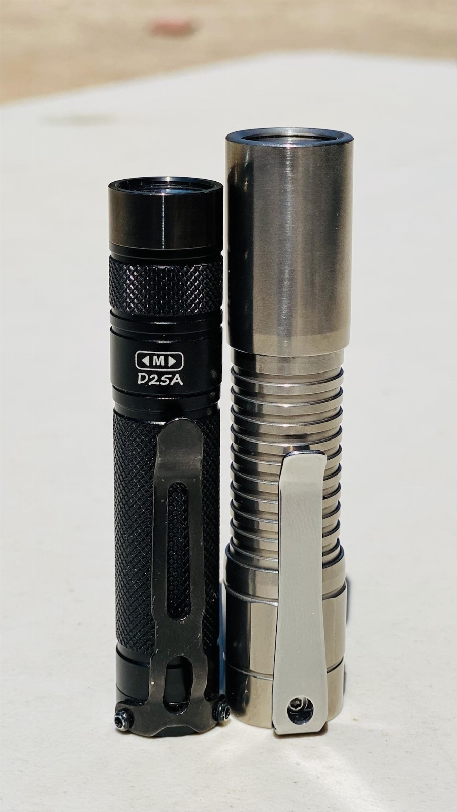

I recently became intrigued with SFT40 possibilities after buying a MK38. Impressed with the output and throw, my curiosity started to grow with regards to the VN2 driver and what might be possible with cells like the H10 Vapcell. I asked Vinh to build the E05vn40 that I reported on before and since my lumen measurements have always been in te ballpark, I didn't have Vinh spec it. When I saw outputs as high as 2300L, I just assumed it was reading 6500K far too high however, I still I knew just by eye that it had to be a 1500+L light, regardless of a supposed false reading in the cool end of the spectrum. I was literally seeing at least twice the output from the PreonVN W2, with the naked eye.
After that I asked Vinh to build a D25Avn40 (SFT40) and measure the output. He saw 1800L at turn on (I don't know what cell he used). I didn't get throw readings from Vinh because he got distracted after seeing 1800L. My lowest reading with 3 different cells was 1960L but one cell gave a reading of 2240L. I put this same cell in the E05vn40 and saw the highest reading in that light as well, by about the same percentage. So, on the surface, we're seeing low readings of 1800L with SFT40, VN2 & H10 cell, which I think is utterly impressive for a 14500 light. Better yet, the average with all three cells was 2083L, (again, my light box). The light with cell only weighs 1.624oz making this a 1282L per oz light. For comparison, the PreonVN W2 is about 648L per oz. I'm sure this D25Avn40 is breaking all kinds of records for 14500 lights.
In any case, I'm happy and it's just really fun for me to see some of my suspicions about the combination, play out. I'm guessing that a twisty 14500 might even deliver slightly higher readings than the clicky.

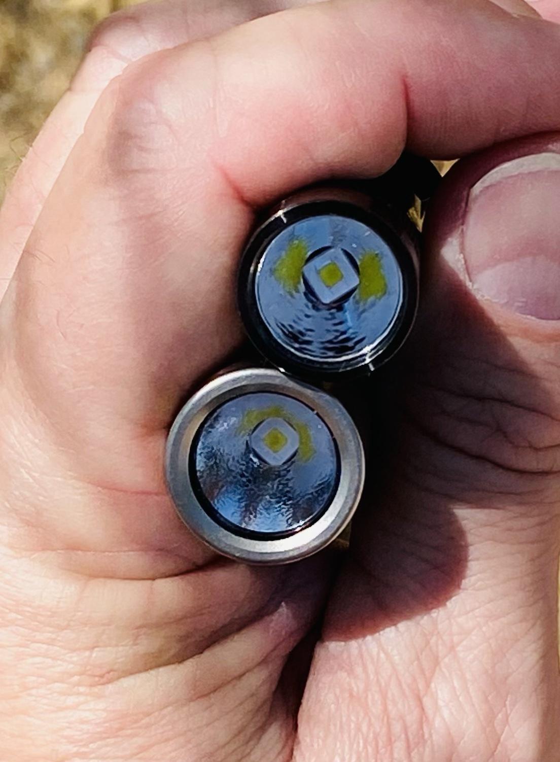

Only 2mm longer than the Preon. The Preon is actually .5mm wider at the widest point, due to the pocket clip curve.
I’m totally with you. The sft40 is currently my favorite throwy emitter. I love the balance of lumens and lux. I think the convoy c8 with sft40 was what first got me intrigued. I too, also asked Vinh to make me a custom light with the sft40. He built me the manker 14500 version with sft40. It’s a beast. After seeing your post, I wouldn’t mind having a d25a with sft40 myself. I edc the toolvn whenever I needed something tiny. I’ll think about it some more…
Ah! Yes, you were ahead of the game. What initially made me pause on the E05vn was Vinh's measured specs. I thought to myself VN2+ SFT40 + H10 Vapcell should certainly smoke a W2 in the Lumen department. I'm guessing he used the 4A Manker cell but it makes all the difference. I took the chance and got a huge reward.
Both lights are great, the pocket clip is nicer on the Manker but the ribs make it hard to slide in and out of dress pants. The D25A handles the dress pants perfectly. The clicky is a little easier to manipulate on the Manker but it's about 1oz heavier, 2.6oz instead of 1.6oz. The Manker is about 7mm longer and 2mm fatter but handles the heat almost twice as well. Although the heads are a different sized, I want to say the actual reflectors are about the same diameter of 15mm. If the Maker's is larger, it's hard to tell. The Manker has a noticeably more textured and frosted reflector finish. I'm guessing this is why the Eagtac is throwing a tiny bit better.
