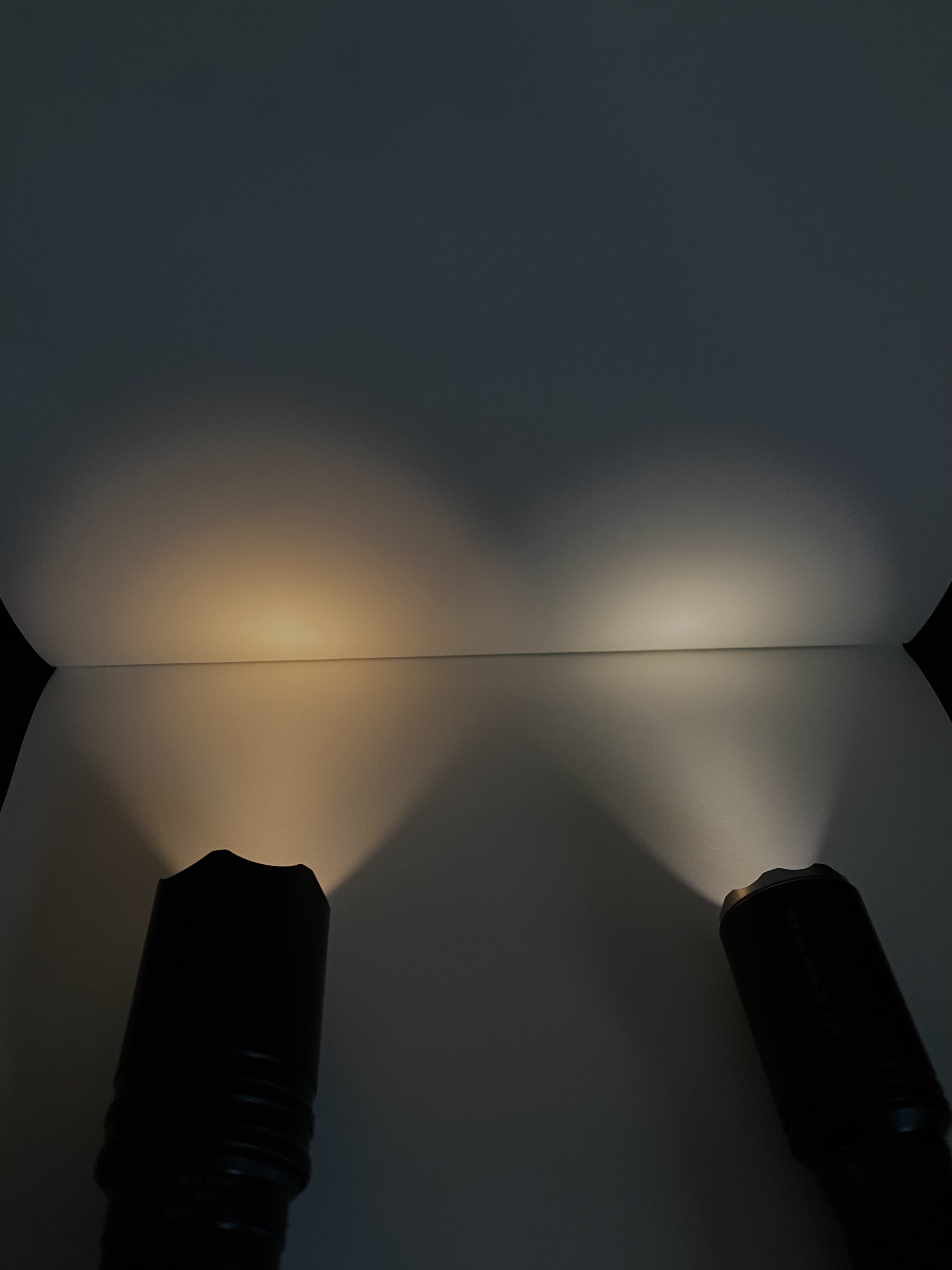

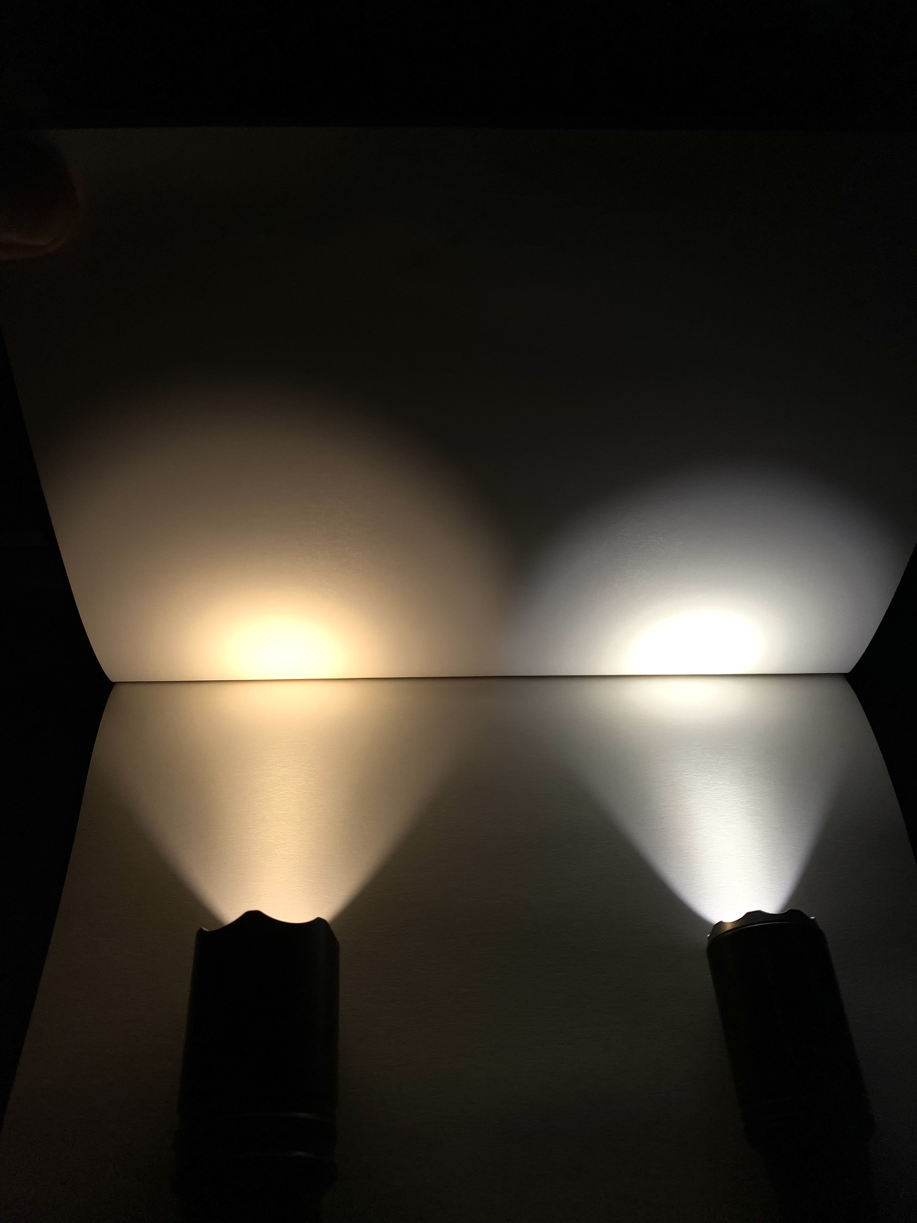

MD2 M31WLL 519a sm273 on left, MDC AA 519a sm353 on the right. First picture is full output. Second picture is low output.
Thank you very much. It seems to be a fantastic drop-in. In which modes did you use the MDC to take the photos? That would give me an idea of ​​how many lumens the drop-in delivers.
Thank you very much. It seems to be a fantastic drop-in. In which modes did you use the MDC to take the photos? That would give me an idea of how many lumens the drop-in delivers.
I used H and LL on the MDC for the first and second picture, respectively. The MD2 is high/low ring running a CR123 USB-C rechargeable 3V and CR123 dummy cell.
MDC in high mode delivers 100 lumens and in LL mode delivers 0.3, right? The drop-in seems to deliver more than 0.3.
That’s correct.
I’d say the M31WLL has slightly more output than the .3 lm lumens in AA MDC.. in person they look very close to the same. I wish I had something to measure the output..

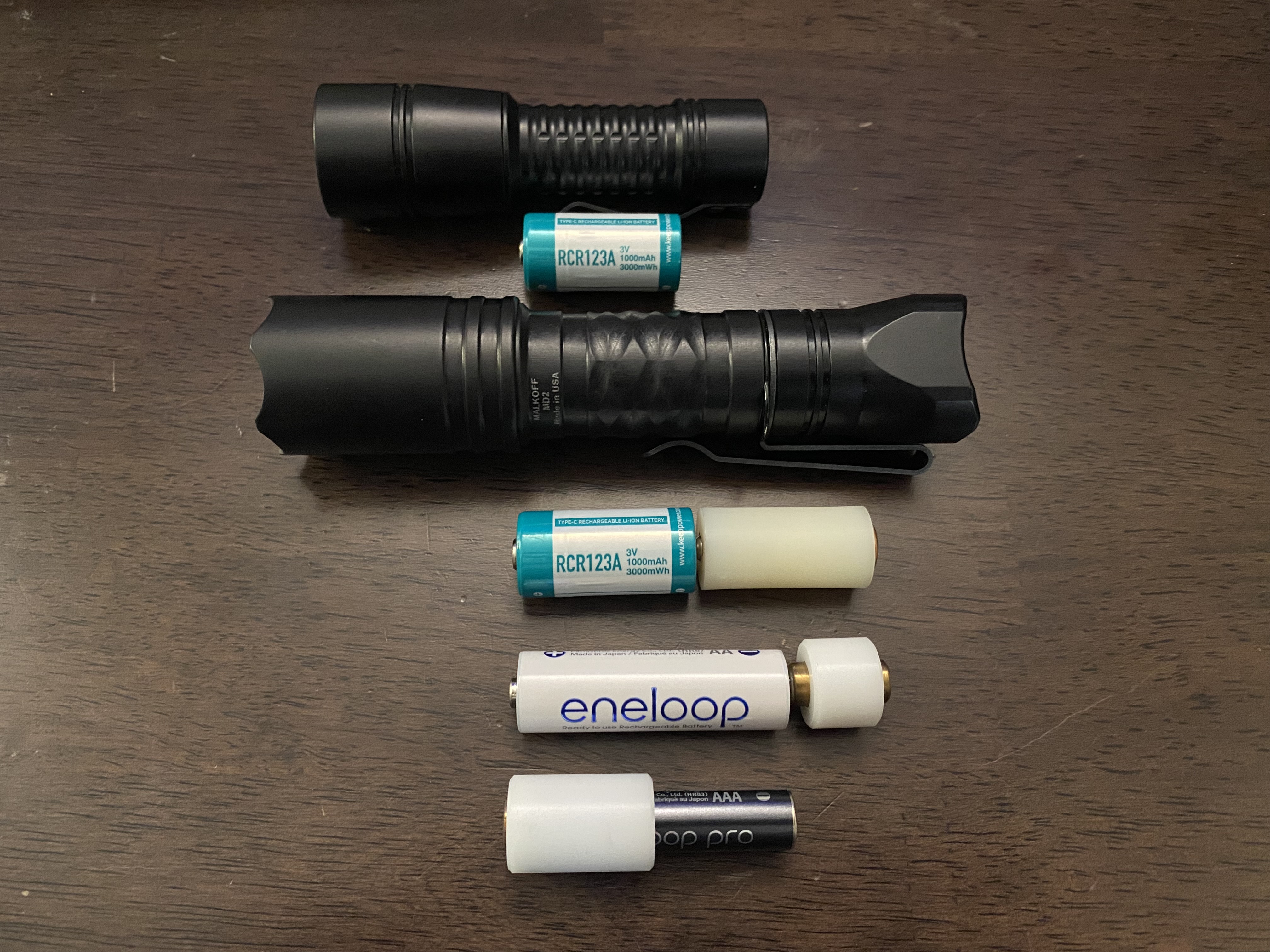

I wanted to throw this picture in here to visually show the flexibility of the M31WLL drop-in by showcasing the different cells I've been able to use in the MD2 with the use of a dummy CR123 cell I purchased from Malkoff and a Logan 17500 delrin battery adapter pack add-on from Peak LED. I also included the MDC w/ VME head for reference. Happy Humpday!
NOTES: The high/low ring in the MD2 ONLY functions using the 16340 KeepPower P1634TC 1000mAh 3V Protected Button Top USB-C and I expect would also work in an MD3 running 2xAA. Additionally, the low function on the high/low also works on a 3V primary (Surefire 123A in this case).
As I don't have an device to measure output, I reached out to Gene assuming he'd know what the output was roughly on low using an M31WLL and he said had no idea and that the high/low ring wasn't designed to work with a single CR123 running one of the 3V modules (M31) and I assume 2xAA. He was surprised that it worked well as he expected it to be quite flickery on low so take that for what you will if you run either of those setups.
I wonder if the circuitry in the 3V USB-C provides a flatter output versus the 3V primary allowing the high/low ring to function effectively and not as flickery as Gene was expecting? Maybe the same would apply to 2x AA USB-C 1.5V Li-ions as well?
I’m sure I’ve read somewhere that people have modified their hi/low ring with a different resistor more suited to 3.0v M31 drop-ins. I think it’s a bit tricky to do and you risk destroying the ring. Also, knowing Gene the resistor is probably potted.

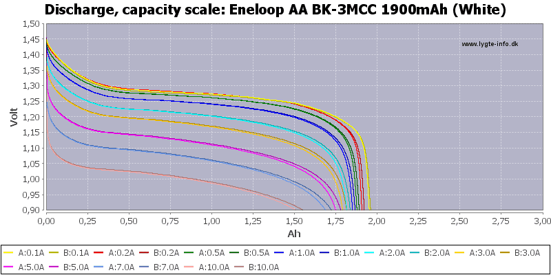

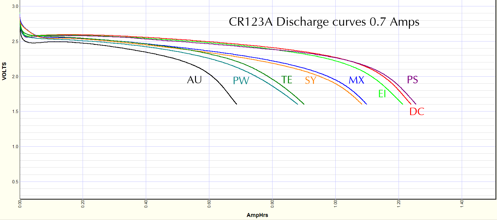

The Li-ion 3V one actually probably is perfect for using the high/low ring. I can use the H/L ring with 2xAA AT FIRST, once the voltage drops a bit, it only works if I start it, THEN rotate it, and then after that, it will not work.
It's interesting because Eneloops have a pretty stable discharge curve, so the H/L ring (made for the Li-ion cells) seems to just barely function around that 2.4V. CR123A cells have a horrible discharge curve in comparison. Just a TERRIBLE slope, so yes, I could see Gene being surprised because a single CR123A would drop voltage pretty quickly, under the range that the H/L ring seems to work.
If you look here, you can see they are BARELY ever at or near 3V, and tend to operate closer to the 2xNiMH ranges.|
CR123A (these are each different brands):
Eneloop:
