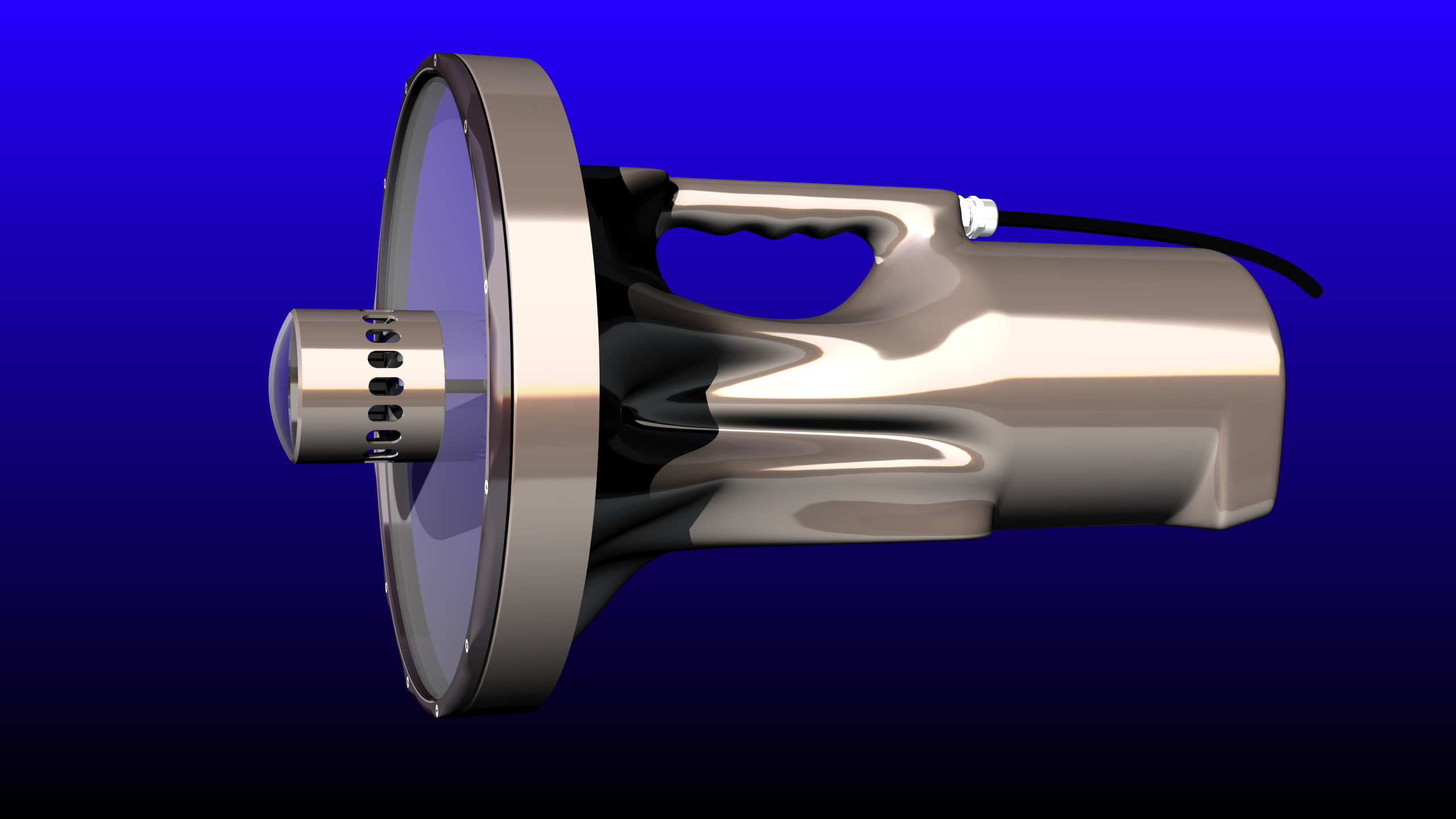

I also recently improved the exhaust by reducing the number of components within it to lighten it up and to eliminate an internal cylinder whose wall thickness was partially blocking the light path. You'll see in the render below, the exhaust includes a front lens which allows all of the light from the reflector to pass through the exhaust (minus the wall thickness of the exhaust outer cylinder wall). Allowing that light to pass through the exhaust through the lens allows for 5% additional beam power that would otherwise be blocked by the exhaust. There is also a second one inside the exhaust, and they will have to be tempered and A/R coated as well and I'll be seeking a source for those lenses.
I will also be making a CNC mold for the bezel. Decided to go with a molded composite bezel instead of machined metal to save weight while having more rigidity. Plus a CNC molded bezel just looks bad ***. It will have to be a two-part mold because the back side must be shaped around the lens and EPDM seal.
I'm also finding that I will have to make the rearward most section removable in order to access the internal air filter. It won't be as clean looking as a single-part housing with un-broken curves, but I could make it work.
Also, in this drawing, I have yet to give the curves a final cleanup, and the outer diameter of the optics housing (the section directly behind the bezel) is still being worked on to accommodate securing the removeable reflector assembly apart from the lens assembly. When completed, that outer diameter section will be much less thick. I also toyed with the colors a bit to make it easier to see the curves than with the all black renders...
