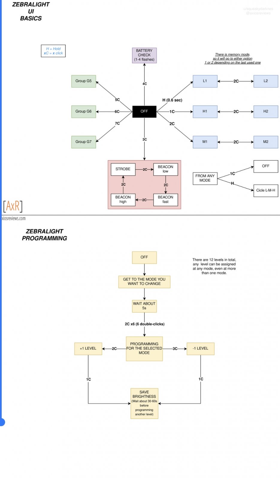

i am haveing issues programing g7 mode i click 3 times to go lower and it just shuts off. i think i have to start off in the mode i want to program like set light to a certain level then shut light of then go sttraight to that mode from off then 6 double cllicks
From off did you click 7 times to get to g7? Here is a graph that might help you.
