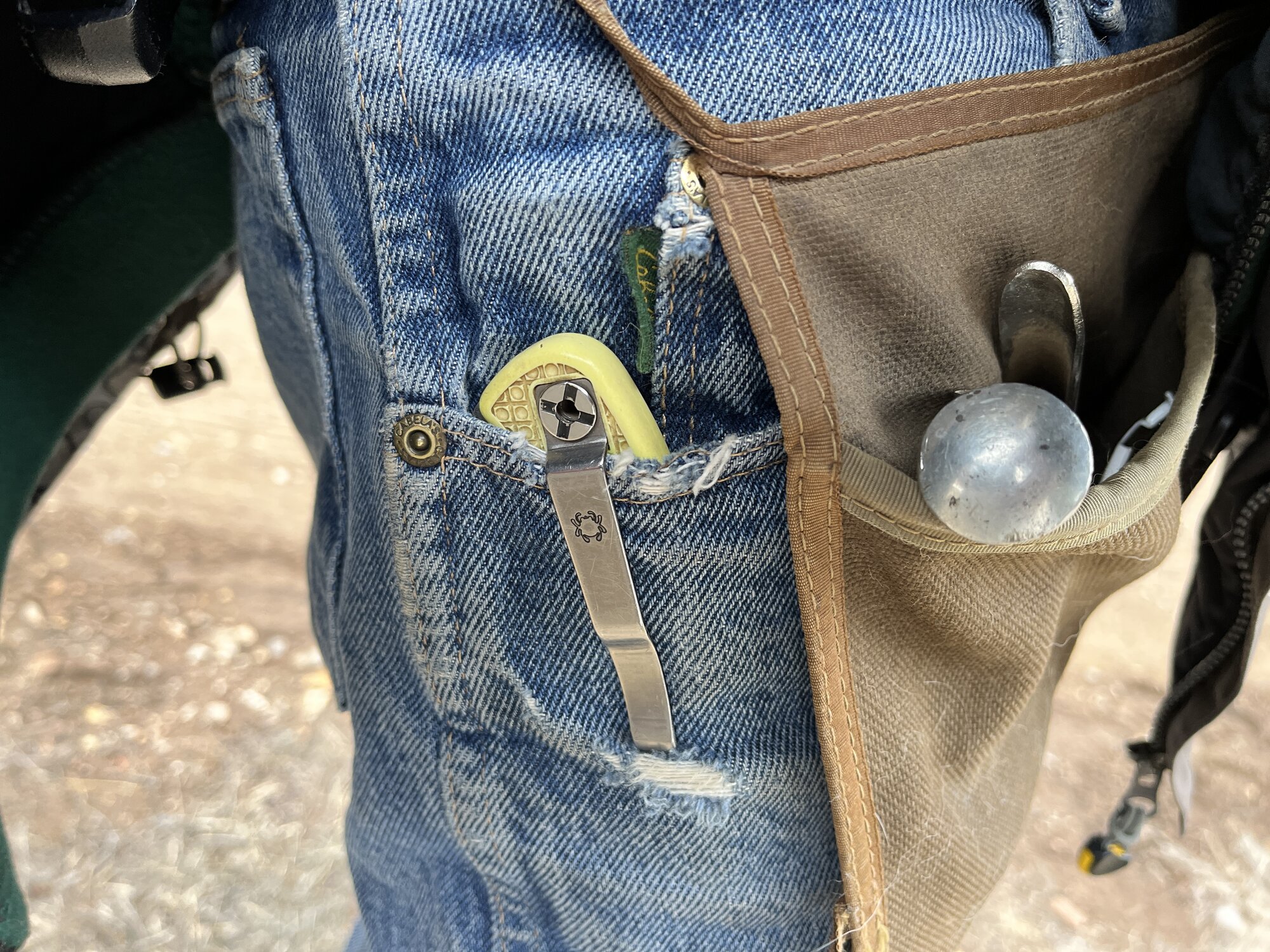

“Clip-torn pockets is just part of EDC life”Telltale mark of hard users
Hard headed maybe?

The original clip ate my pockets, which I suppose meant that it was too tight. Maybe the thinner clip solves this by loosening the pocket grip.
I thought the original clip was too thin as it was.

Clipping and unclipping many times a day?i wonder if your pants pocket material is even thicker than mine. i wonder what would explain the difference in pocket wear.

Not having seen or used the new clip, I can not say for certain, but I thought the original clip was too thin as it was. Metal is hard, skin is soft, and thin metal can become a blade, and even a dull blade can slice skin with enough force. Zebralight only increases its quality and utility by allowing clips to be removed and replaced, which I appreciate because I prefer a thicker clip and one that is deep carry
