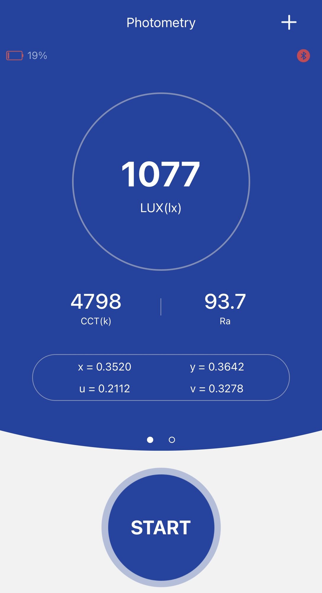

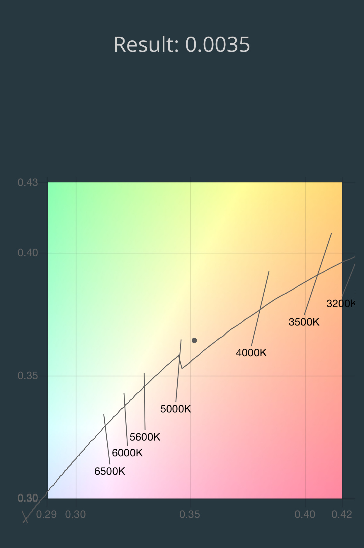

I got one and took some basic Opple measurements. I do not have a lumen tube though.
    81.1 KB
    190.1 KB
    319.6 KB

I got one and took some basic Opple measurements. I do not have a lumen tube though. View attachment 55956

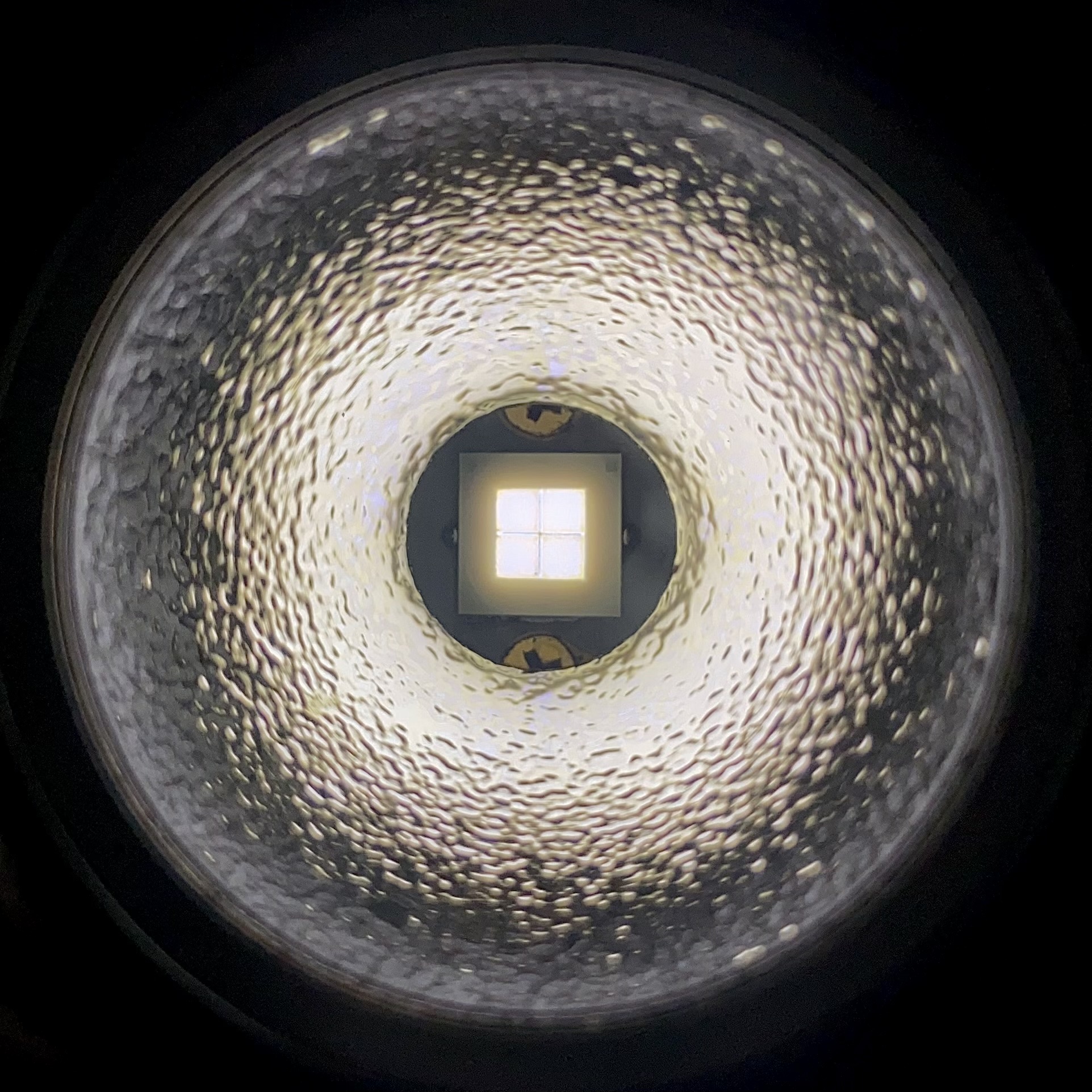

Can you take a photo of the LED, and do you have the SC700d to compare in the beam shots? I would like to see the difference in beam (outdoor shots) in order to determine whether I will be ordering a HI version. Thanks for your help.
Tony
Tony
Sure. In use the light is great. The tint is very usable and only looks dingy next to nice rosy emitters. The picture with two lights on the wall is a 519a 5000K (left) and this ZL SC700d HI 5000K (right). In the last pic you can see how your eye sees it on its own. It is not a McBob but it is a very usable stock 70.3 but if you want the rose, plan on a swap.
