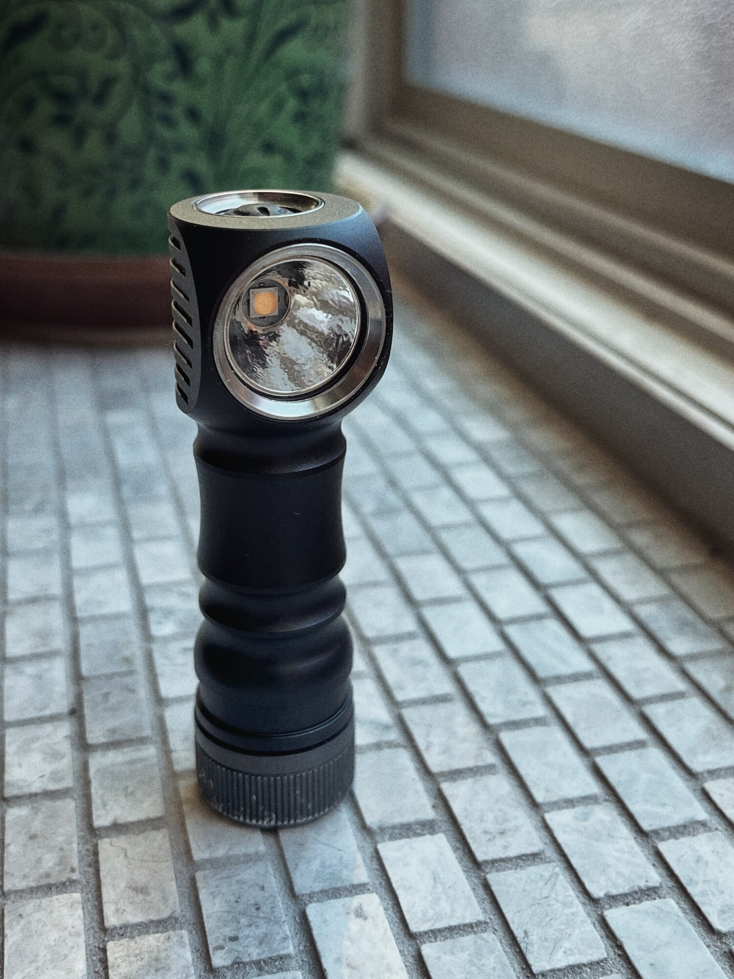

This is a great flashlight. Currently running it with a AAA Eneloop. Makes me happy.
    449.3 KB
