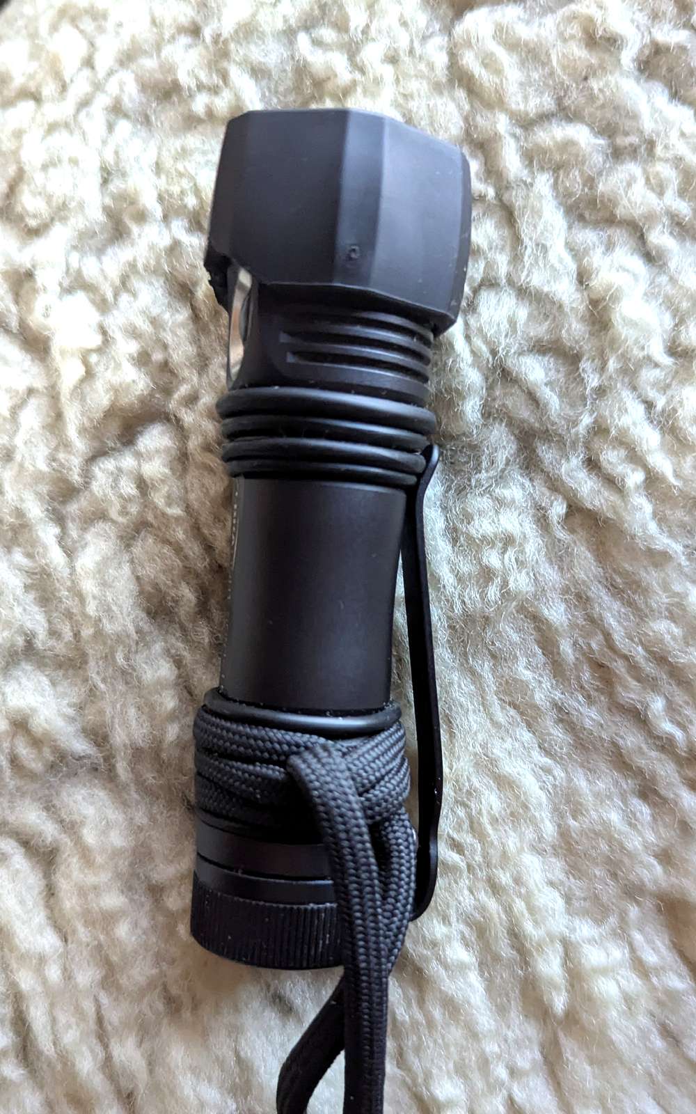

SC64c/65c with a Mini-Maglite Anti-Roll protective cap. Been EDC'ing this in my front jeans pocket for a while with good results. Had to trim it slightly for button access.
Handy! Looks like a more capable Rayovac Indestructible lol

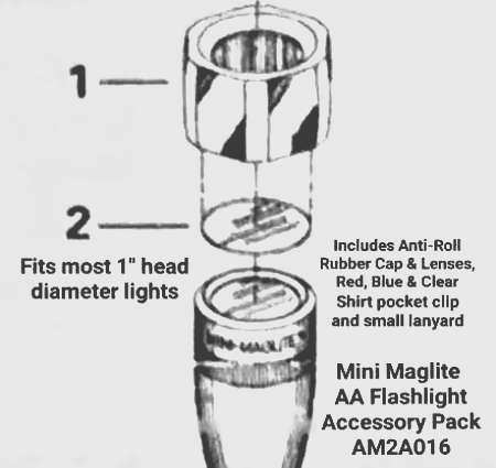

If you want it, provides excellent drop protection, virtually eliminates accidental turn-ons, anti-roll and optional red/blue lense color changes .. with surprisingly minimal bulk and weight.

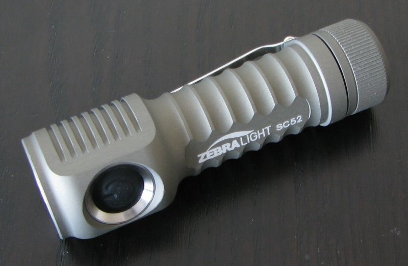

Anyone remember when the ribbed or scalloped body tubes for the H5x started? I'm confused going back in time even though I was there with Zebralight from the beginning. Pretty sure I have both a H3x and H5x with the ribbed body and I know I have at least 3 H600 lights with the ribbed body. When I search I see reviews of H52 lights both with smooth bodies and the ribbed bodies. Would be great to see a timeline of all the different variants. Zebralight used to have their pages archived with pictures but those links don't work anymore from the Google spreadsheet.

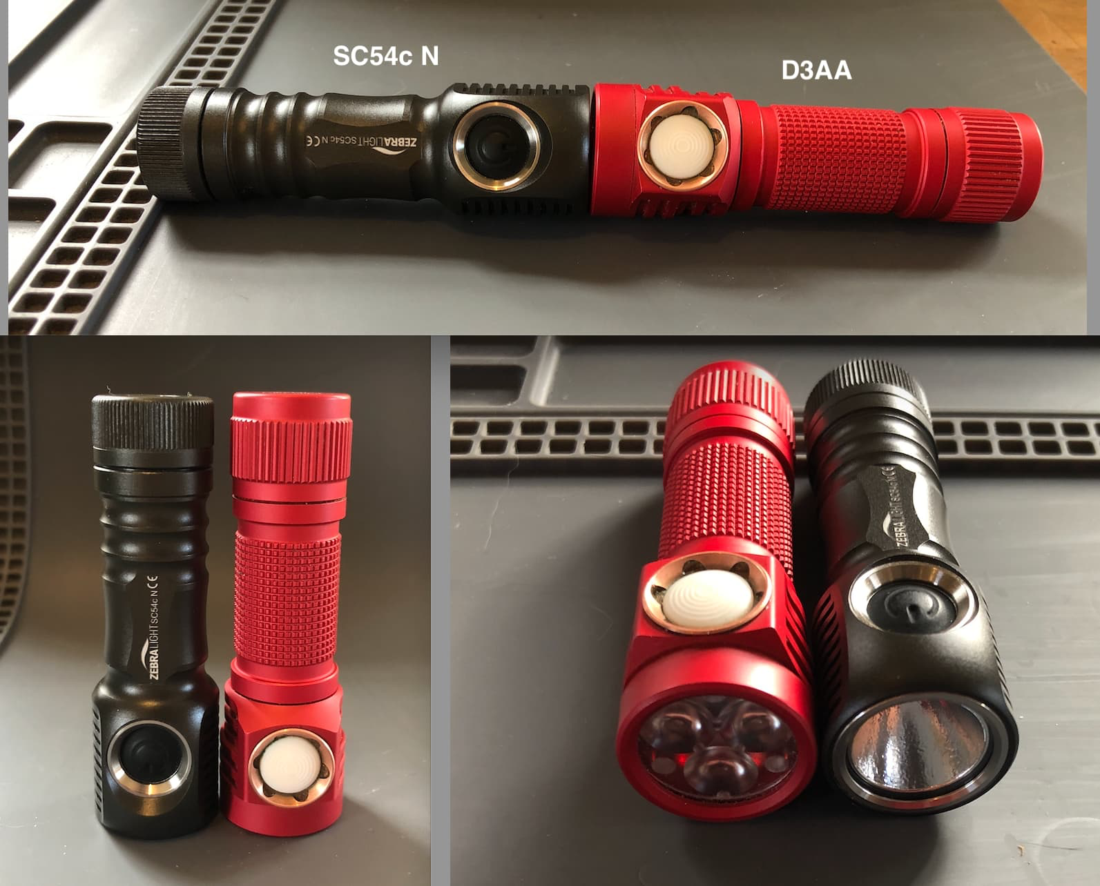

If you want to consider a different light, I suggest a D3AA. It is the same size and weight as the SC54c N:
D3AA is more efficient at all outputs over 2 lumens, works with both AA and 14500, choice of primary LEDs, includes secondary RGB LEDs, and illuminated switch button in your choice of LED color. The UI makes it much easier to change output, gives you the option to use stepped modes, or smooth ramping (personal favorite), and the price is lower.
The D3AA driver will never give you High nor Strobe by mistake, and wont Preflash at High when you go to Medium.
otoh, the Zebra body is smooth, and imo much nicer than the knurly D3AA. And the Zebra pocket clip is far superior.
Both have excellent switches that are recessed and protected from turning on in a pocket.
The beams are different, D3AA is floody, with a consistent brightness across the beam. Zebra beam has a smaller hotspot with better outdoor distance reach.
