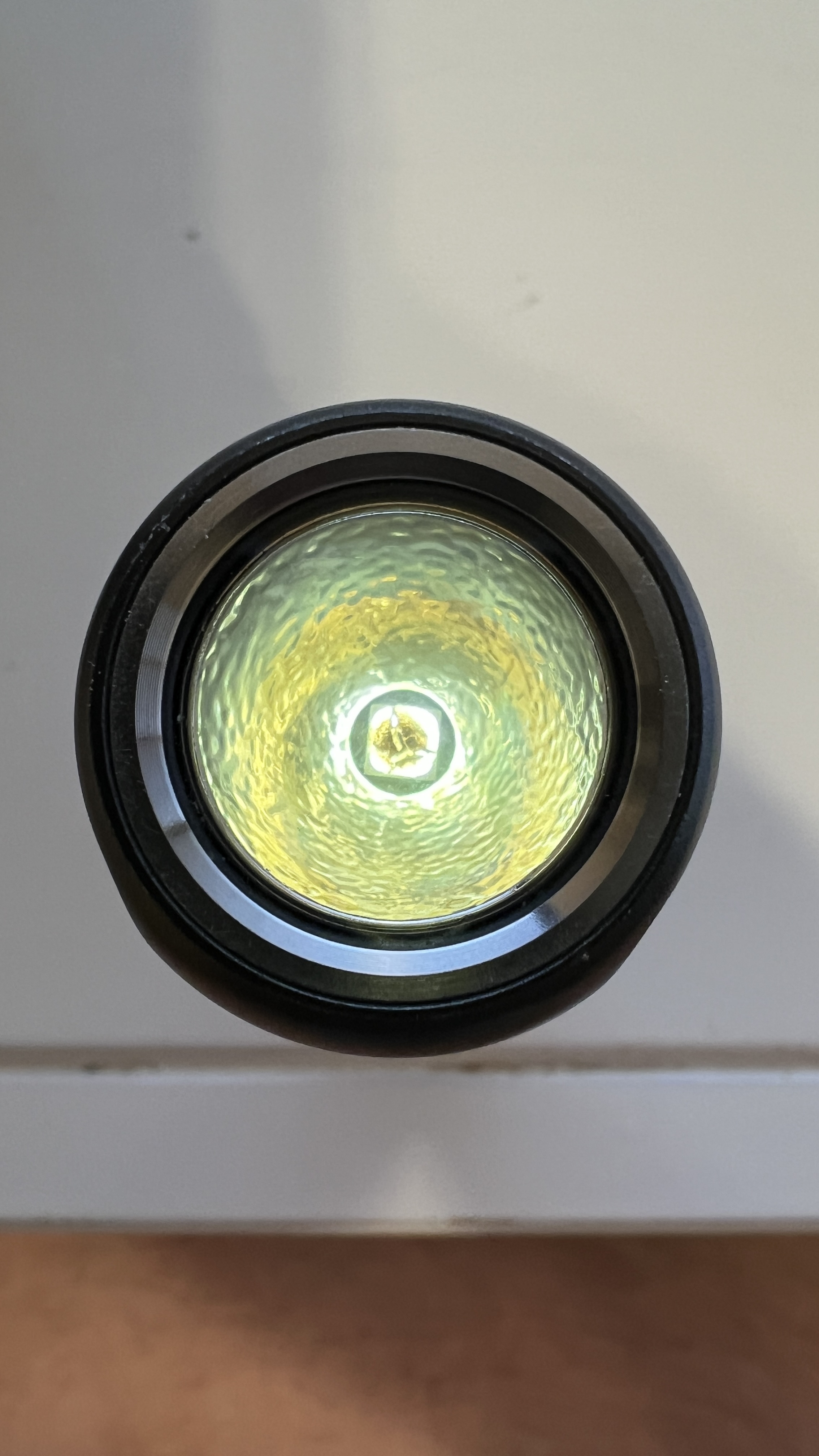

After 9 years, my Zebralight SC63 CW finally died. The LED still comes on, but the Color temp is 5700K normally and now looks more like 4000k and has a large black hole in the center of the beam. Oh well. It lasted me 9 years of daily carry. I am not a fan of the lower K lights, so I emailed Zebralight to see if they would be releasing something in the 5700k range and they told me they would never be releasing anything higher than 5000k. They said they would be releasing an SC66 later this year, at 4500k and perhaps an SC66d at 5000k. Here is a photo of my LED, it looks melted.
After 9 years, my Zebralight SC63 CW finally died. The LED still comes on, but the Color temp is 5700K normally and now looks more like 4000k and has a large black hole in the center of the beam. Oh well. It lasted me 9 years of daily carry. I am not a fan of the lower K lights, so I emailed Zebralight to see if they would be releasing something in the 5700k range and they told me they would never be releasing anything higher than 5000k. They said they would be releasing an SC66 later this year, at 4500k and perhaps an SC66d at 5000k. Here is a photo of my LED, it looks melted. View attachment 85369
Change the LED to a new one.

Must not have mentioned that I contacted them, and they said they don't stock the LED that came in the SC63 anymore, so no RMA. I actually sent this light back to them for at button issue as well, earlier this year. The button, when pressed once, would sometimes not activate the light. They fixed that, but now the LED, oh well. I am carrying my SC600 Mk III, a little bigger but the same output, but will hold the higher output longer than the SC63.

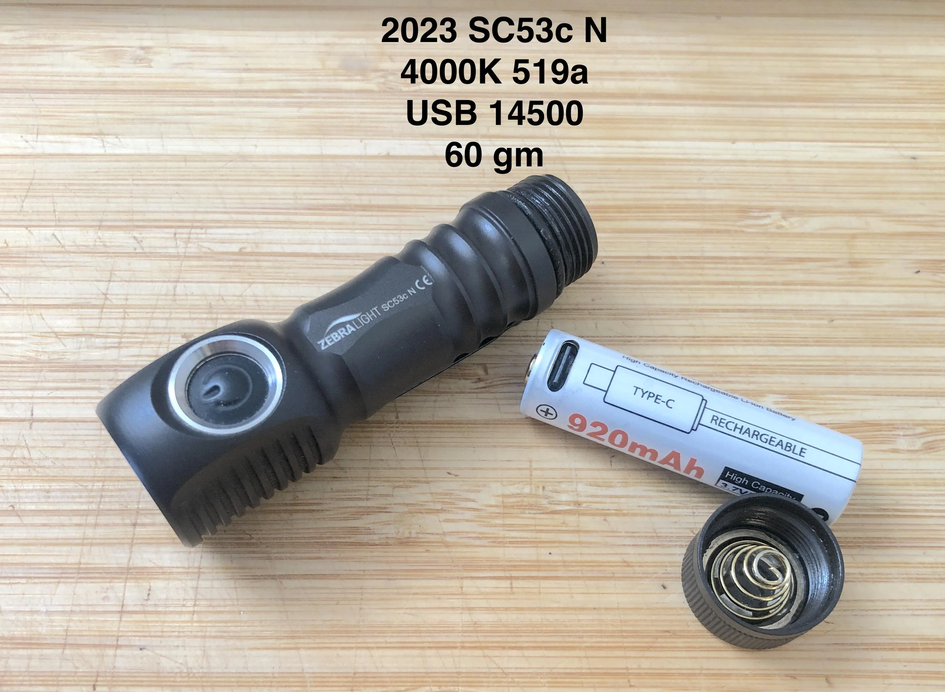

about 18650 models.. I like the previous generation better than the new generation,
Im very happy w my SC64 LE.. driver has much lower Flicker Index than the new SC65
about AA models... I also prefer the previous generation AA models (because they work on LiIon), over the new AA only ones
Im very happy w my SC53c N and H53Fc N for their dual fuel capabilty.. much better than the new AA only SC54c N and H54Fc N.
I like 14500 LiIon much better than Eneloop.. both require recharging, but 14500 is available w built in USB-C, and 14500 offers double the output of Eneloop, on H1.

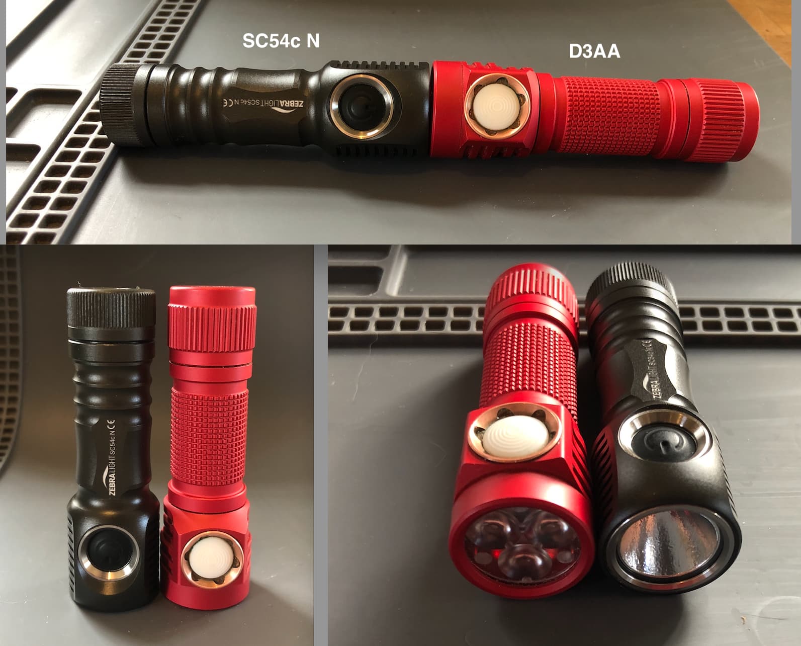

I did compare the SC54c N form factor to a D3AA, and definitely prefer the Zebra form factor and clip. None of my SC54c N had the 90 second blink issue.
I do rave about the 2023 SC53c N that is dual fuel.. Once I found one, I sold my SC54c N
I’m amazed that Zebra can’t fix there known quality problems. They don’t even check the lamps before sending them out.
for me the SC54c N is inferior to the 2023 SC53c N, in several ways, even when they dont have the 90 second beacon bug.. Im not a fan of Eneloop (heavier than LiIon,) and the 54 driver has higher Flicker Index than the 53 driver. Plus I prefer the longer tailcap spring of the 53, which allows use of AAA, in addition to AA/14500.
