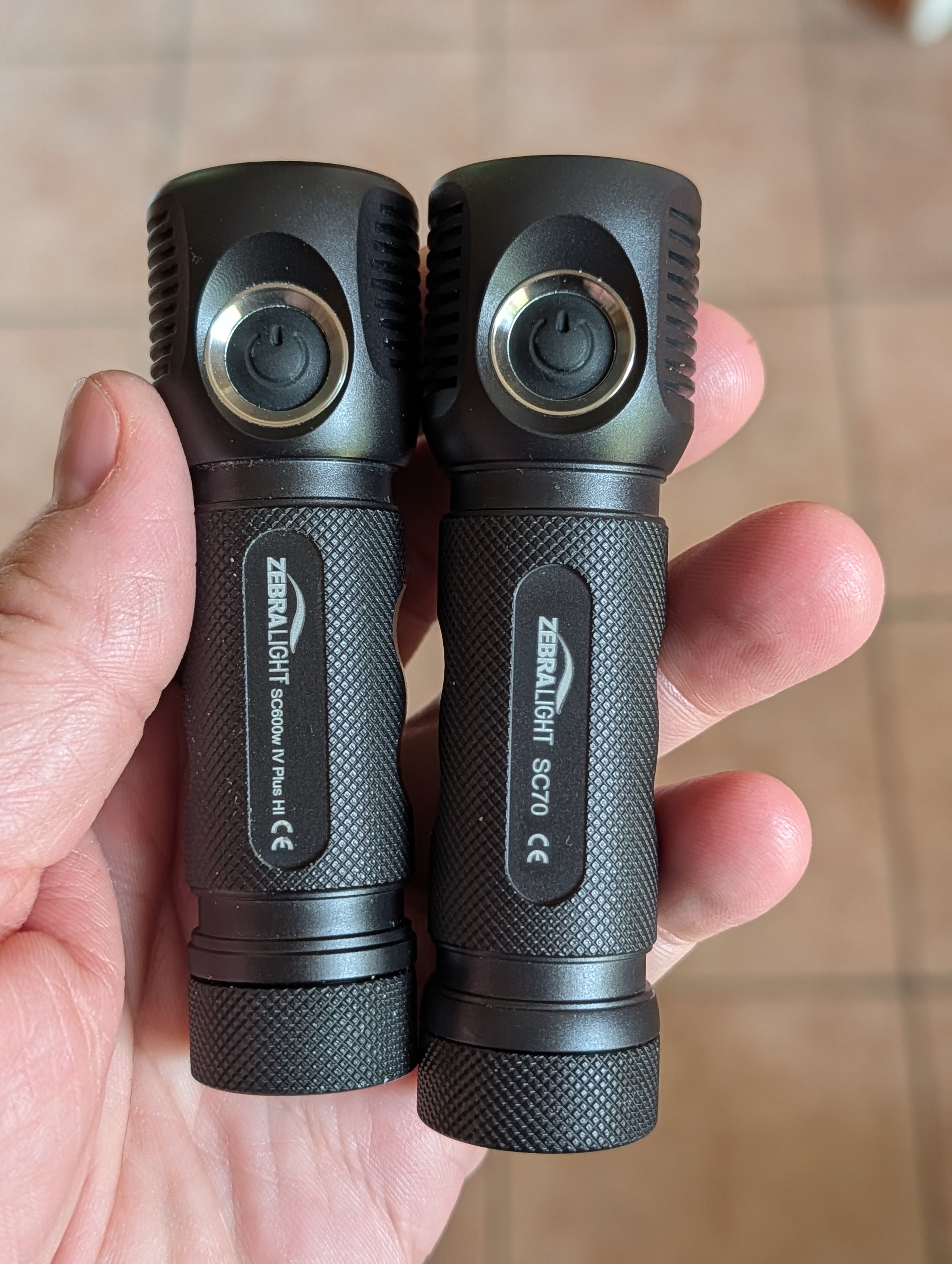

I don’t care much for SC70 personally. Thought about getting it but if I’m going big might as well get the SC700 for larger reflector at that point. Their 18650 lights give plenty of runtime as it is.
It's not really "going big". The SC70 is basically the same size as the SC600, but 5mm longer. The SC700 is a much larger light.

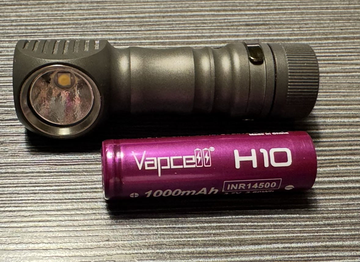

I have upgraded AA Zebra by soldering 0.2mm brass button to positive side of wires. Now i can use any flat top liion unlike previously seeking for smallest button top. And normal AA cells can be still used without issues.
Of course i had try new Luminus SST-36F 6500K 90CRI emitter and i am very pleased to say it looks better than SFT-70 5700k 90CRI.
