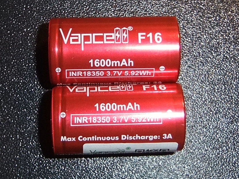

Vapcell are claiming their F16 is the highest capacity 18350 battery on the market, So I thought I should check it out.

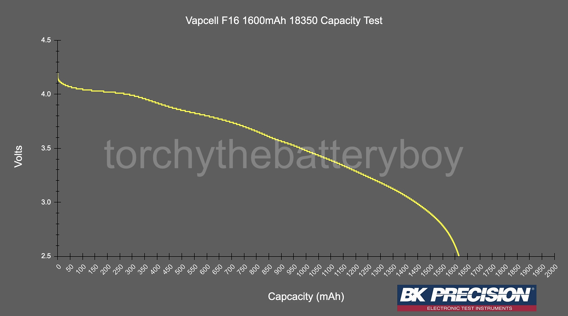

Actual capacity tested at 1601mAh, so no argument on that score and as yet, I haven't come across higher capacity 18350.

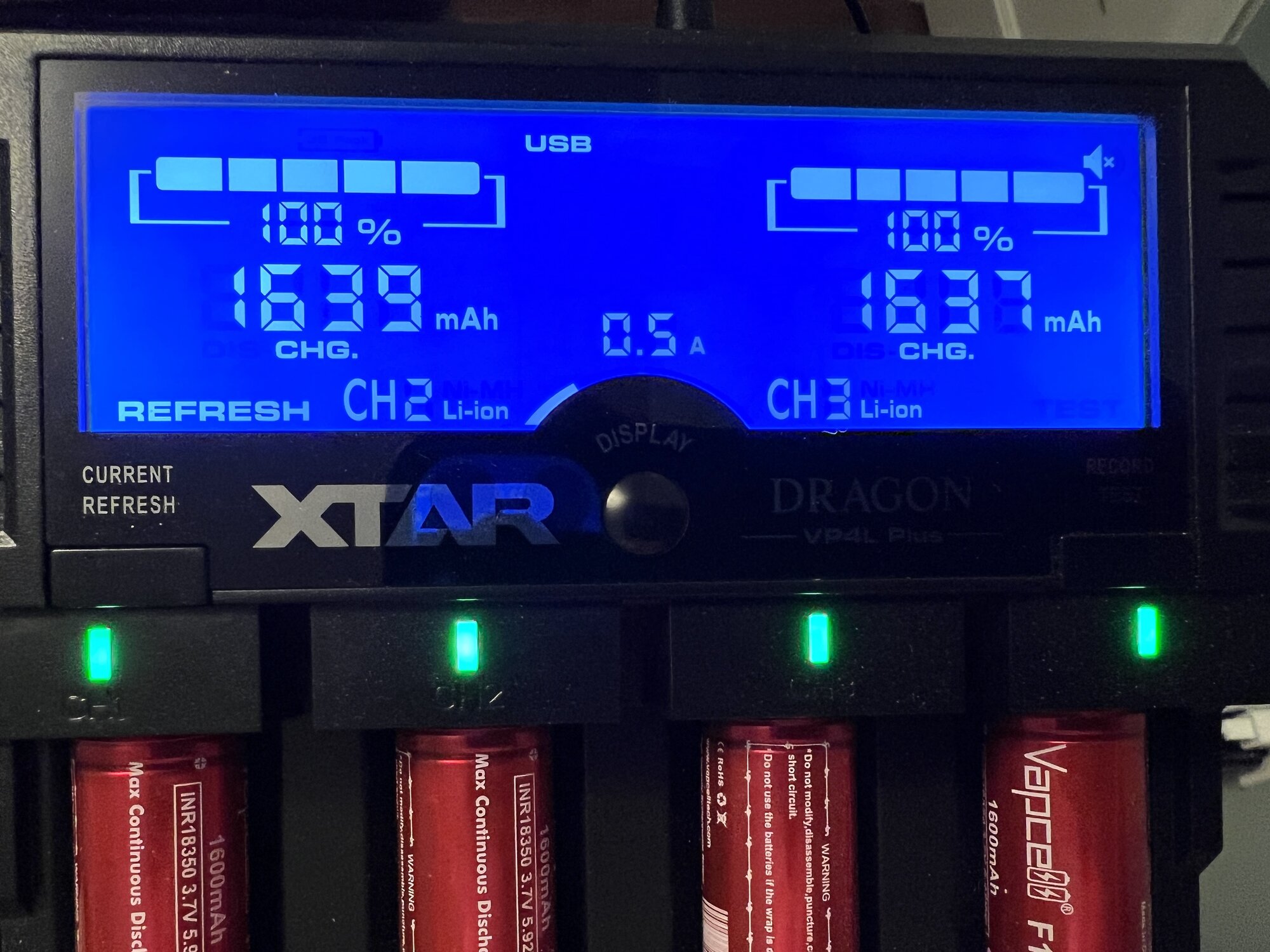

Got the vapcell f16 yesterday and overnight the test result was 1525 mah capacity. It being brand new I'm going run it a few days in my flashlight and then retest, will see how it does then I'll retest capacity again……….well I ran it down and charged it twice so test this time was 1575 mah, hopefully it’ll reach stated 1600 mah after a few more cycles??
When u tested had u ran any cycles or just straight to the testing like I did? In the past after a few charge/discharges I’ve had batteries to increase capacity just a little, that’s why I’m asking
