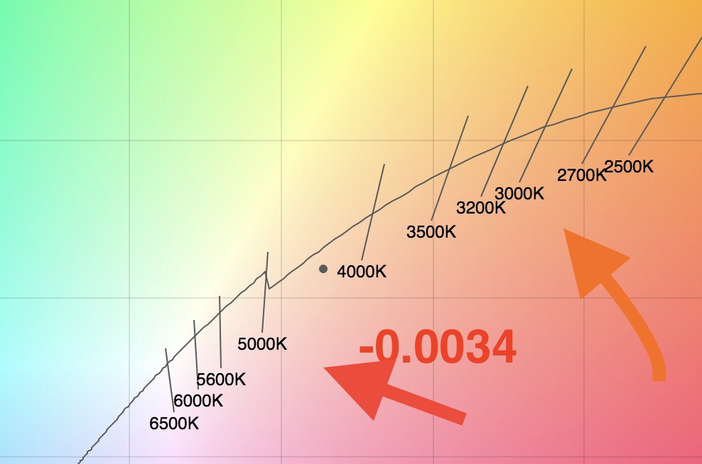

I am very much Team Yellow, which should be a positive DUV-value, but limited from to around 1000K to sub-5000K (which is the CCT-range I like the most anyway). Above 5000K, if I am reading the charts right, the yellow becomes green. Intensity based on the value number..

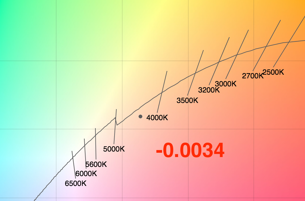

...And looking at a chart like the one below, I can really tell how bad my monitors are at colour accuracy. >-<
Please correct me if I'm wrong, but are rosy tints a negative DUV value, but spans across the whole range of CCTs?
If so, I can see the appeal of rosy tints - it's like a "cheat" to get flashlights with cold tints (and with that, increased perceived brightness), but without the green tint.
If anything, I am definitely Team Anti-Green, aka photon vomit (Nitecore, I am looking at you)!
As much as I think I won't like rosy tints, I can't and won't say for sure until I have tried one.
@jon_slider I really like the NTG50 2700K you show above - what can I expect (CCT / DUV) from a 2x NTG35 2700K + 2x 4200K mix? Looking at the D4V2.
I don't own a "rosy" flashlight (NTG, FFL emitters etc.), but from what I have seen of a wide array of beamshots, I do not like it.
I am very much Team Yellow, which should be a positive DUV-value, but limited from to around 1000K to sub-5000K (which is the CCT-range I like the most anyway). Above 5000K, if I am reading the charts right, the yellow becomes green. Intensity based on the value number, of course.
...And looking at a chart like the one below, I can really tell how bad my monitor is at colour accuracy. >-<
