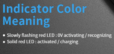

Are the red light indications you refer to 'flashing' or 'solid / continuous'?
I have no idea what's going on, but did note that there's both a "slow flashing" and "solid red" state documented, and they have different meanings, but you didn't note which one you are seeing.

Solif red. I've never gotten a flashing llight, red, green, or otherwise. .

Cool. If you ever do see it flashing red, ...
