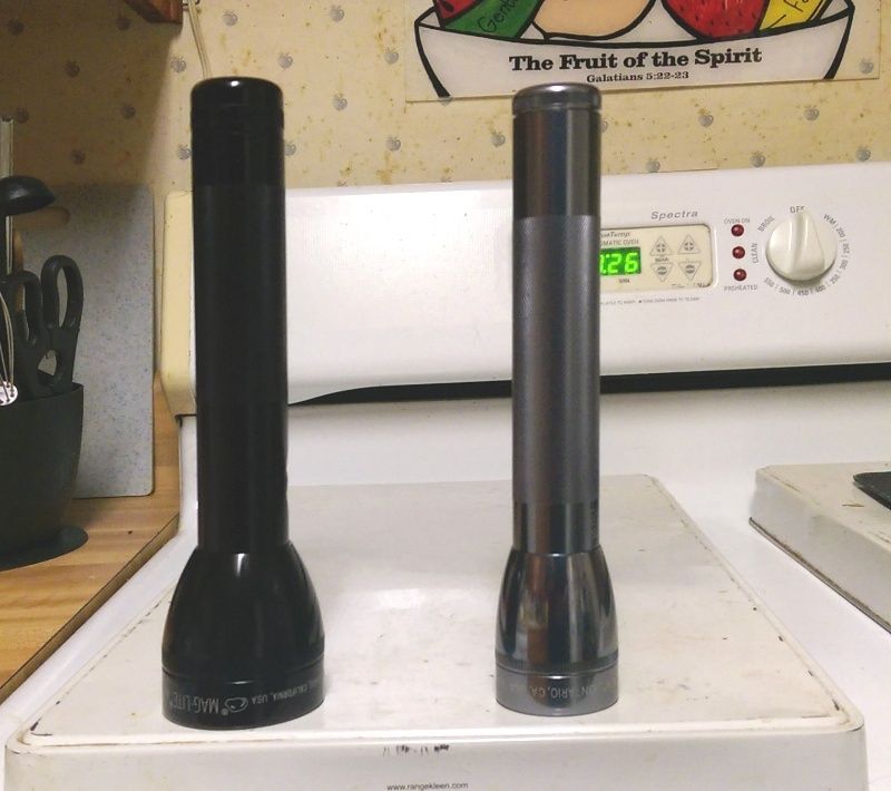

Here's a 3 cell version next to the classic 2C.

No. The full size bi-pin holder is easily removed from full size lights making it easy for swapping in the Malkoff.
This one has the bi-pin holder fixed kinda similar to a mini mag. So without removing and disassembling the switch assembly only a bi-pin LED drop in will work.
Now I tried a TerraLUX and Nite Ize mini mag drop in that will work. But it's fitament does not allow the head to be used as an on/off switch.
