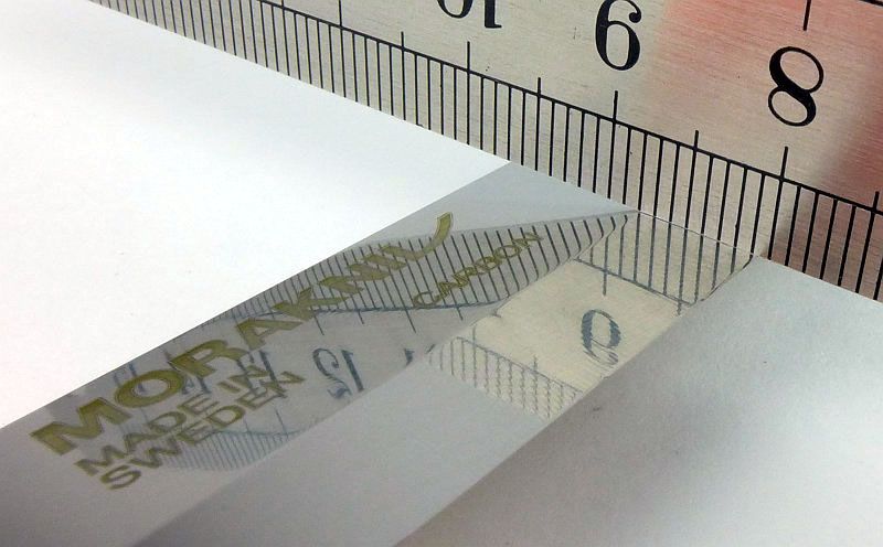

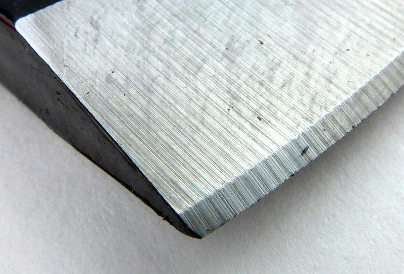

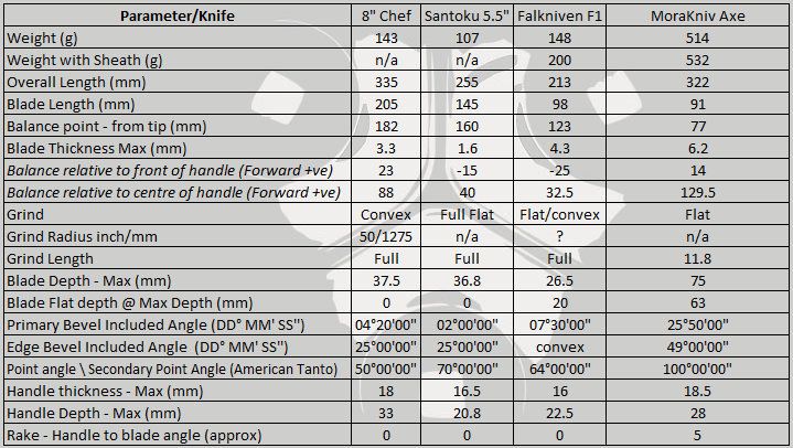

Using a set of gauges and precision measuring equipment including a Vernier protractor, callipers, fixed radius gauges and the unique Arc Master adjustable radius gauge (the one that looks like a crossbow).
These measurements have been tabulated and are presented along with a few reference blades (8" Chef's Knife, 5.5" Santoku and the popular Fällkniven F1).
Key aspects such as the primary bevel angle, grind type, blade depth, blade thickness, length, weight are detailed, along with balance information.
The 'Balance relative to the front of the handle' tells you if the knife will feel front heavy, or if the weight is in your hand (a positive value means the weight is forward of the front of the handle). The 'Balance relative to the centre of the handle' indicates how close to a 'neutral balance' the knife has in the hand.
In the case of full convex grinds the approximate centre of the grind is used for the primary bevel angle estimate.
With the large number of knives in this review, three tables have been prepared. Starting with the reference knives and the Axe.

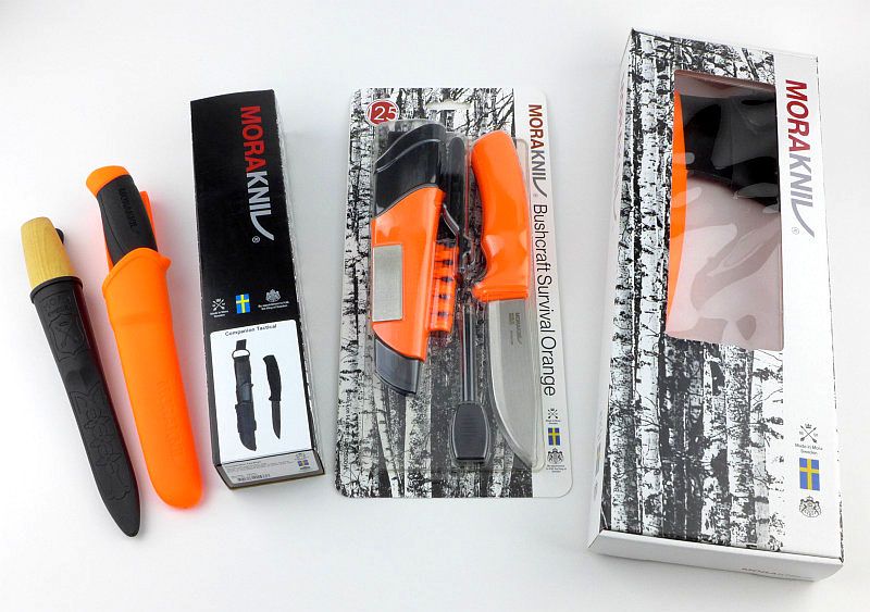

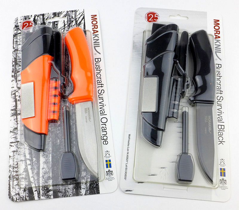

Designed as working tools, Morakniv products arrive in a variety of packaging ranging from none to blister packs and boxes.

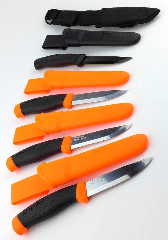

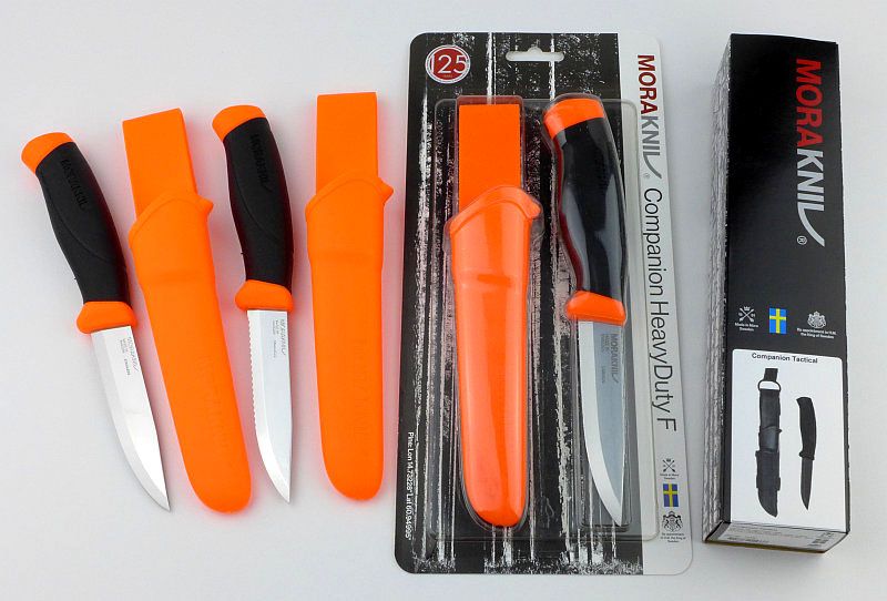

Being the most popular of Morakniv's products, the Companion comes in several different versions. Ignoring colour variations, the main types are (from left to right), the Companion (Stainless Steel), Serrated Companion (Stainless Steel), Companion Heavy duty (Carbon Steel) and the Companion Tactical (Stainless Steel).
All companion versions come with the same design plastic sheath (colours vary), but the Tactical version has an additional sheath cover which is MOLLE compatible. The Morakniv fluorescent orange is very bright!
Taking just the Companion knives themselves, the main differences are the thicker blade of the Heavy Duty, and the black ED coated blade of the Tactical.
The Companions are considered about the best value outdoor knife on the market, and as a step up in performance, the Bushcraft Survival models are also rated very highly for their value for money. Both models come in a cardboard backed blister pack.

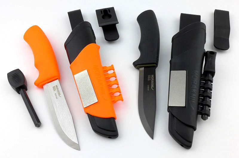

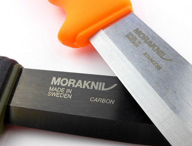

The 'Survival Bushcraft' has a Stainless Steel blade, and the 'Survival Bushcraft Black' has a Carbon steel blade.

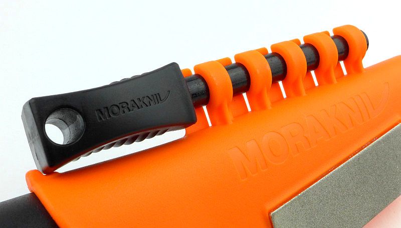

The ferrocerium rod fits into a holder on the side of the sheath.
Here the 'Survival Bushcraft' is shown in the sheath with the enclosed belt loop fitted, and the 'Survival Bushcraft Black' knife and ferrocerium rod are shown next to the sheath which has the belt clip fitted.

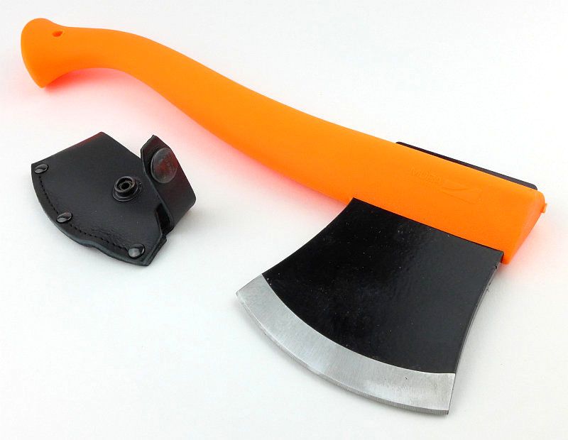

Unpackaged for a better view. Like the Companions and Survival Bushcraft models, the orange handle of the Outdoor Axe is very fluorescent.

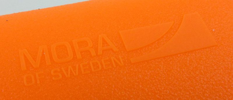

Though this image is low in contrast, you can see the Outdoor Axe still bears to older 'Mora of Sweden' mark, but the box it came in was branded Morakniv.
Like the Companion Tactical the Outdoor Axe has an ED coated blade.
The Axe blade is Boron Steel.

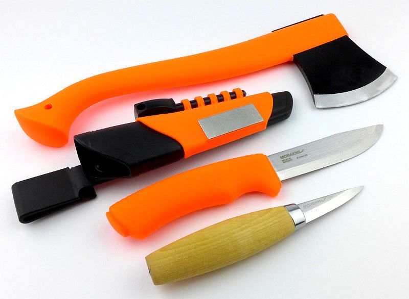

A perfect camping trip kit here with the Outdoor Axe, Bushcraft Survival, and a 120 for fine whittling when relaxing next to a roaring camp fire.

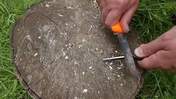

Moving more into the 'survival' area, though a Companion would serve you well if it were the only blade you had, the Bushcraft Survival is that much more sturdy and has a built-in diamond sharpener and a fire-steel; definitely a more complete package.
The spine of the Bushcraft Survival has been left with a sharp corner to make striking the fire-steel effective and this is a typical strike. (slowed down to better show the sparks).
