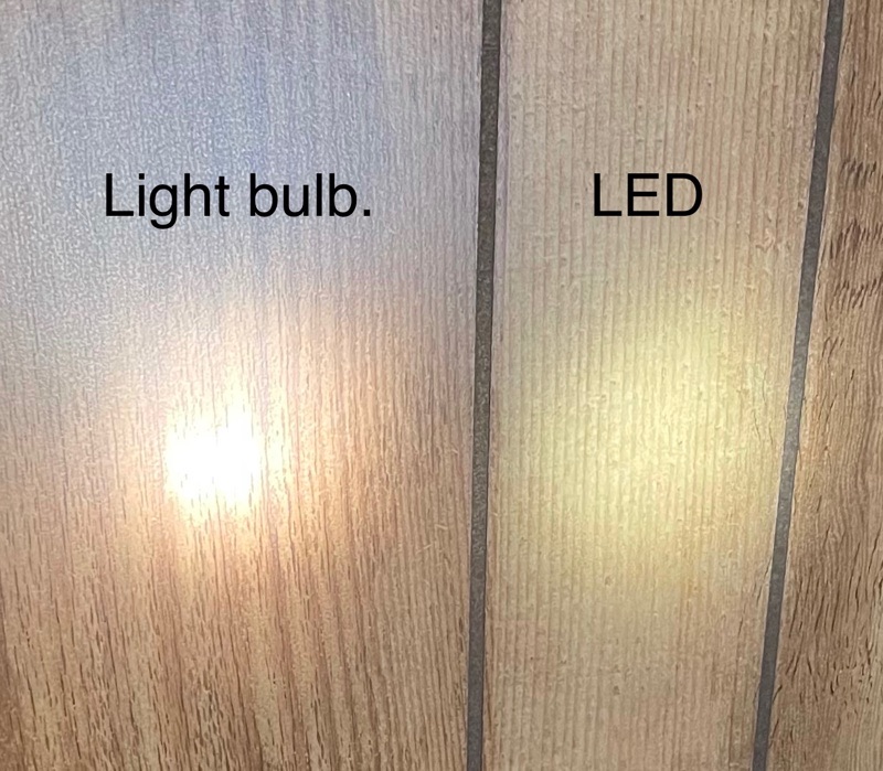

One of the things I like about the Tana singLED is the placement of the LED is such that it picks up the light reflected sideways and adds it to the reflector.
Now of course it does not cast the light like the incan SureFire bulb does in a drill bit fashion but it does a better job at mimicing the beam of a light bulb.
One day I was sent an E with a Tana to compare to my incan E and the difference between the two was pretty subtle indoors. Now outdoors, yeah the light bulb out threw the LED but not enough to change my mind about going LED in my E2D.
Not trying to endorse one brand over another but to me the Tana was well worth the cost if for no other reason, the beam is pretty nice.

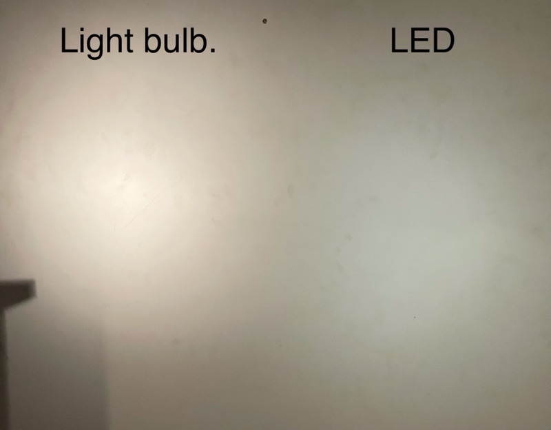

Some pix:
Up close the apples and oranges thing shows they are similar
But add some distance and you see the bulb is so much more throwey as the LED hot spot begins to show how less reflected light affects the beam.
Pics are from an E1 incan head with a SureFire bulb and an LED module from an E1 incan head set to about the same output.

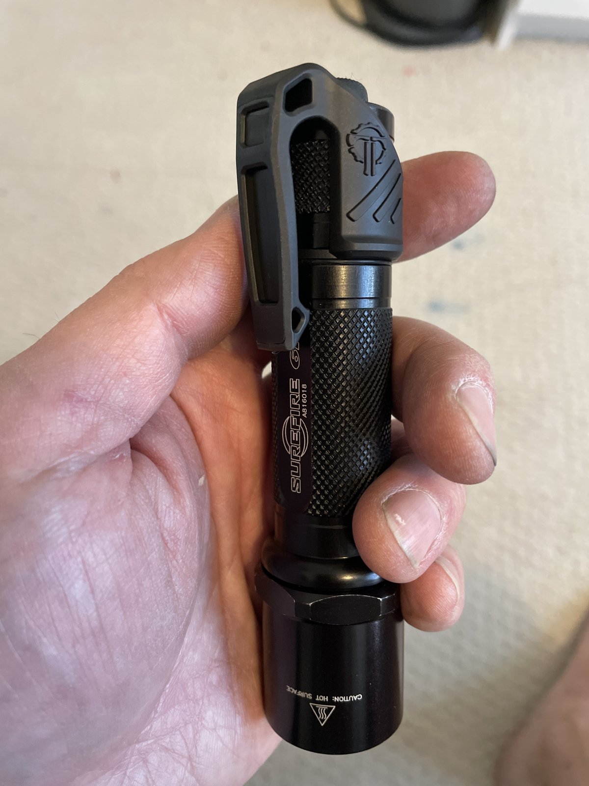

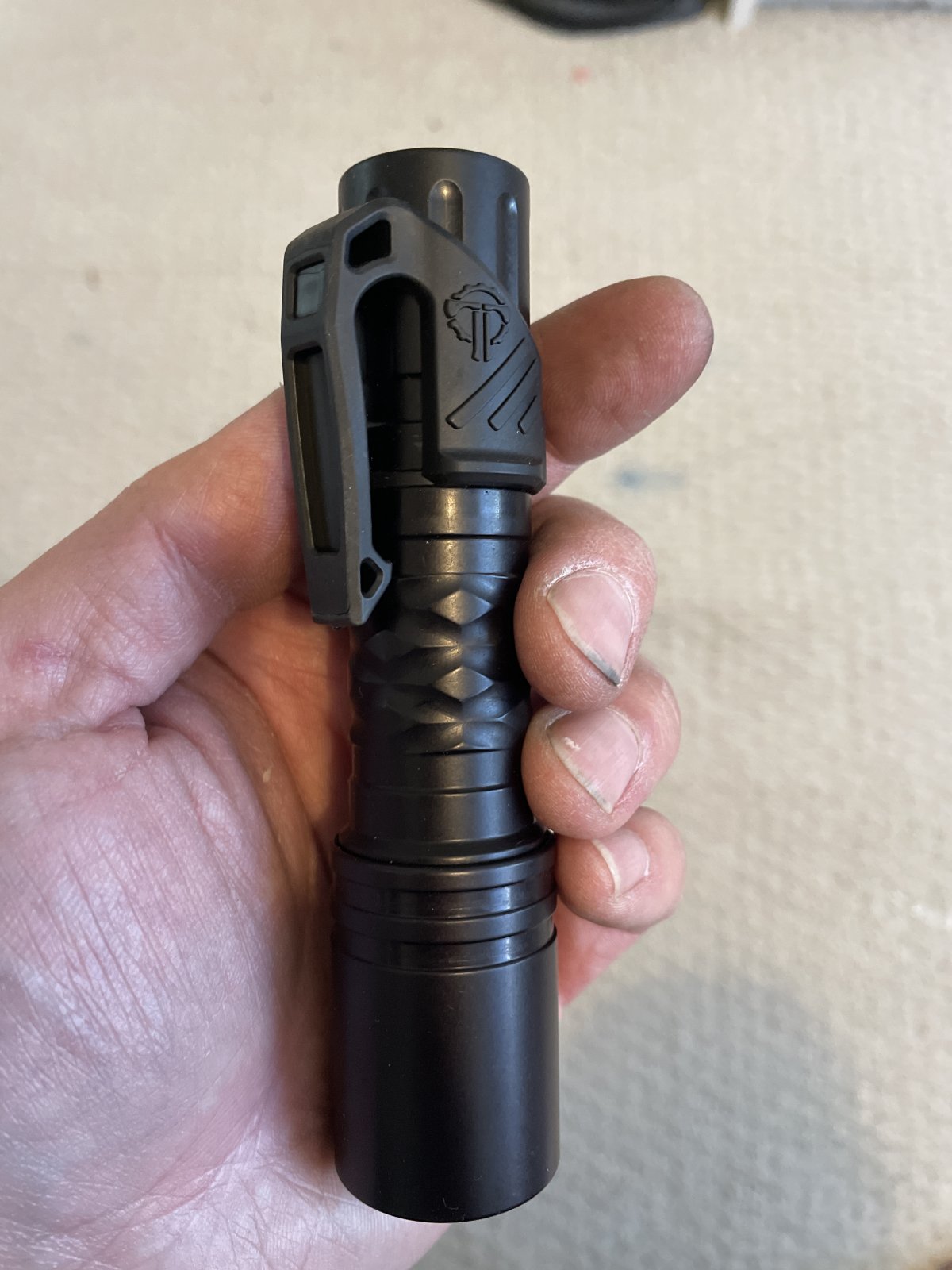

That's pretty snazzy! What clips are they? I could use one for my 6P.
LPC, or Low Profile Carry made by Thyrm.
It comes with an aluminum washer and O-ring to fit different models. It actually fits the MD2 the best, using no extra parts or spacers.
The 6P needs an O-ring to take up the slack in the gap between the tail cap and body.

Thanks for the photo. Too bad it doesn't allow for tailstanding. I thought the clip part on the side may have been enough to allow it to tailstand.
I think a version that allows for tsilstanding would be useful. And if they had that then I'd also want a different version compatible with an e series.
