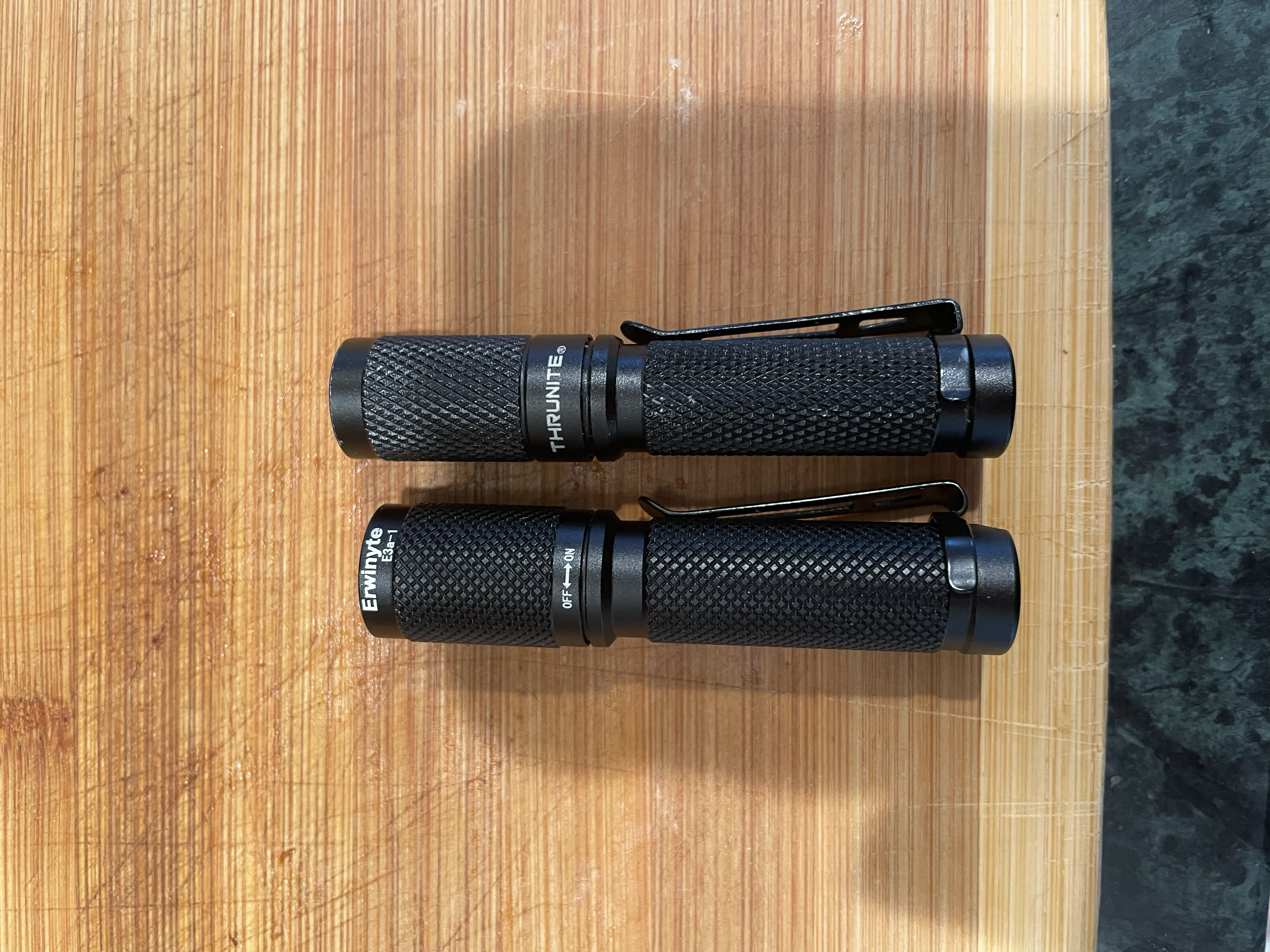

The light bears a strong physical resemblance to the old Thrunite Ti3 (or Maratac), but it is about 3mm shorter.

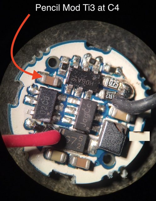

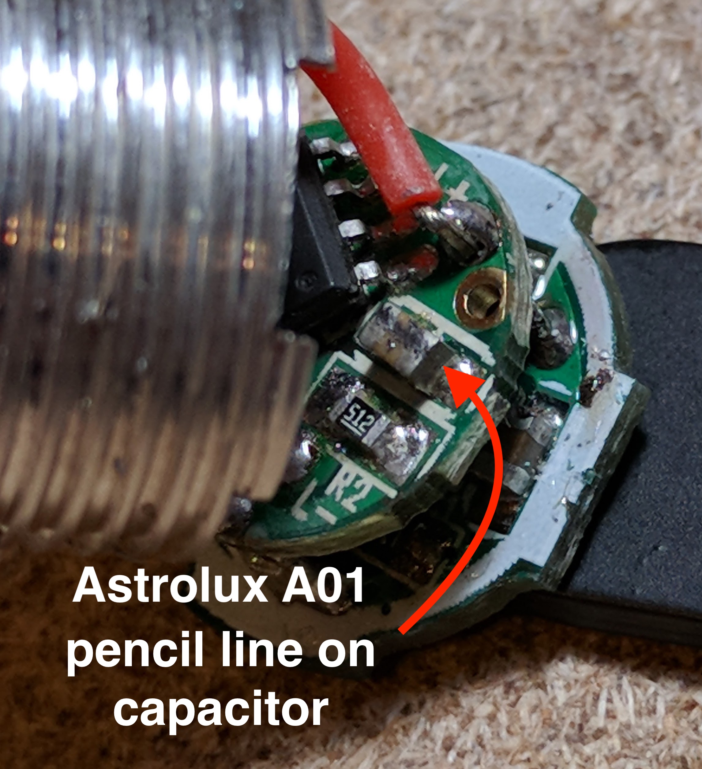

fwiw, the Next Mode Memory problem, can sometimes be solved with the Pencil Mod.. (that is for an Astrolux AAA)
this is where the pencil mod needs to be done to a Ti3 that suffers from Next Mode Memory:
The Ti3 V2 was slightly shorter than earlier Ti3..
Jon -- Any advice about how I can tell which of the capacitors I should be trying to short? Suppose there are a couple of capacitors visible on the pill -- do I just try one and see what happens? Or is there a visible clue?
I imagine there will be more than 1 capacitor. I suspect it would be trial and error. the nice thing about using a pencil is its easy to erase. It's possible you will damage the light shorting a capacitor. I suppose that's what returns are for . . . .

clic Here to see photo of Ti3 driver ;-)

clic here to see photo of Ti3 driver ;-)

ime first came the pencil mod for Astrolux A01 (not all batches had the NMM problem):

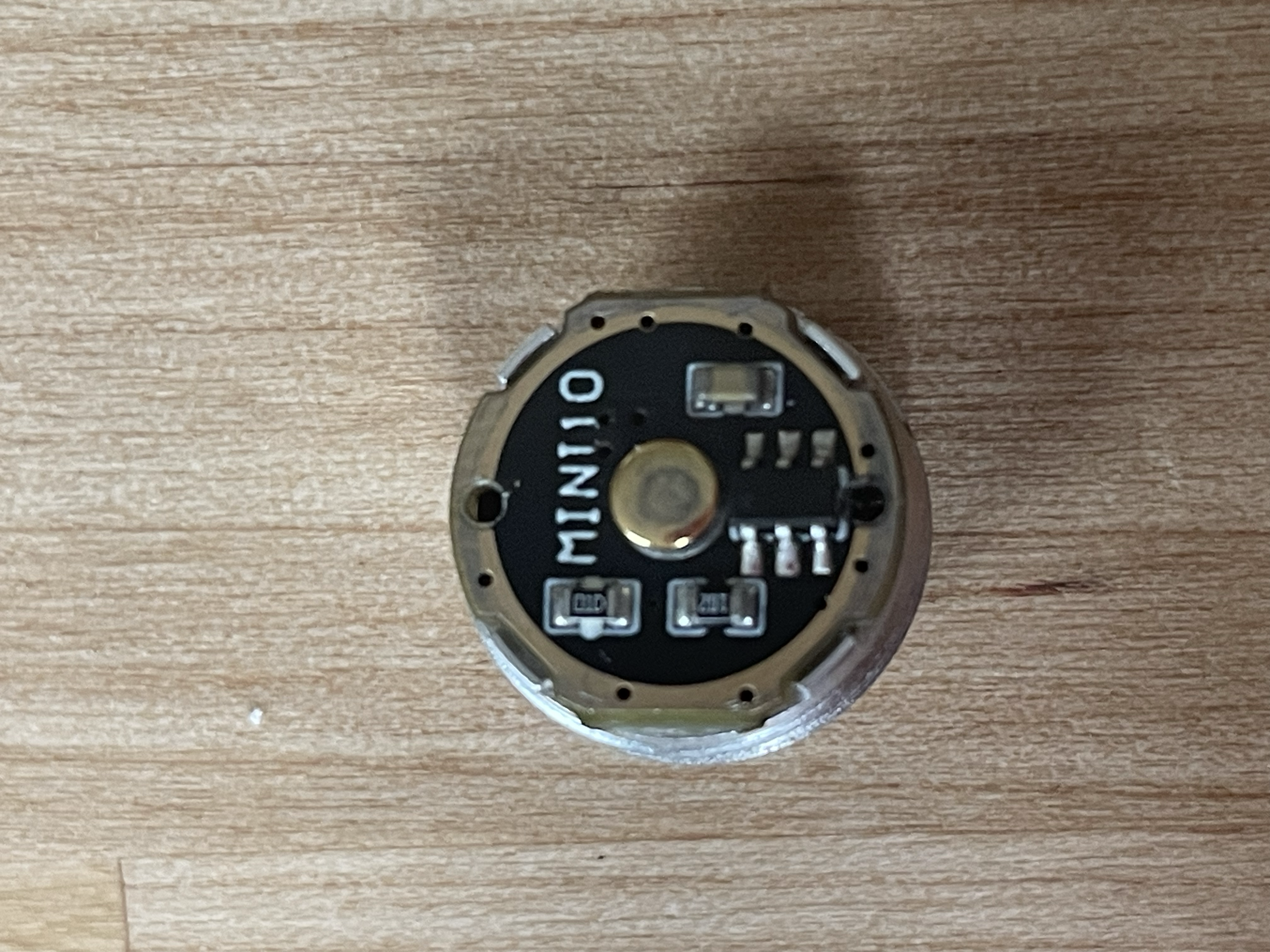

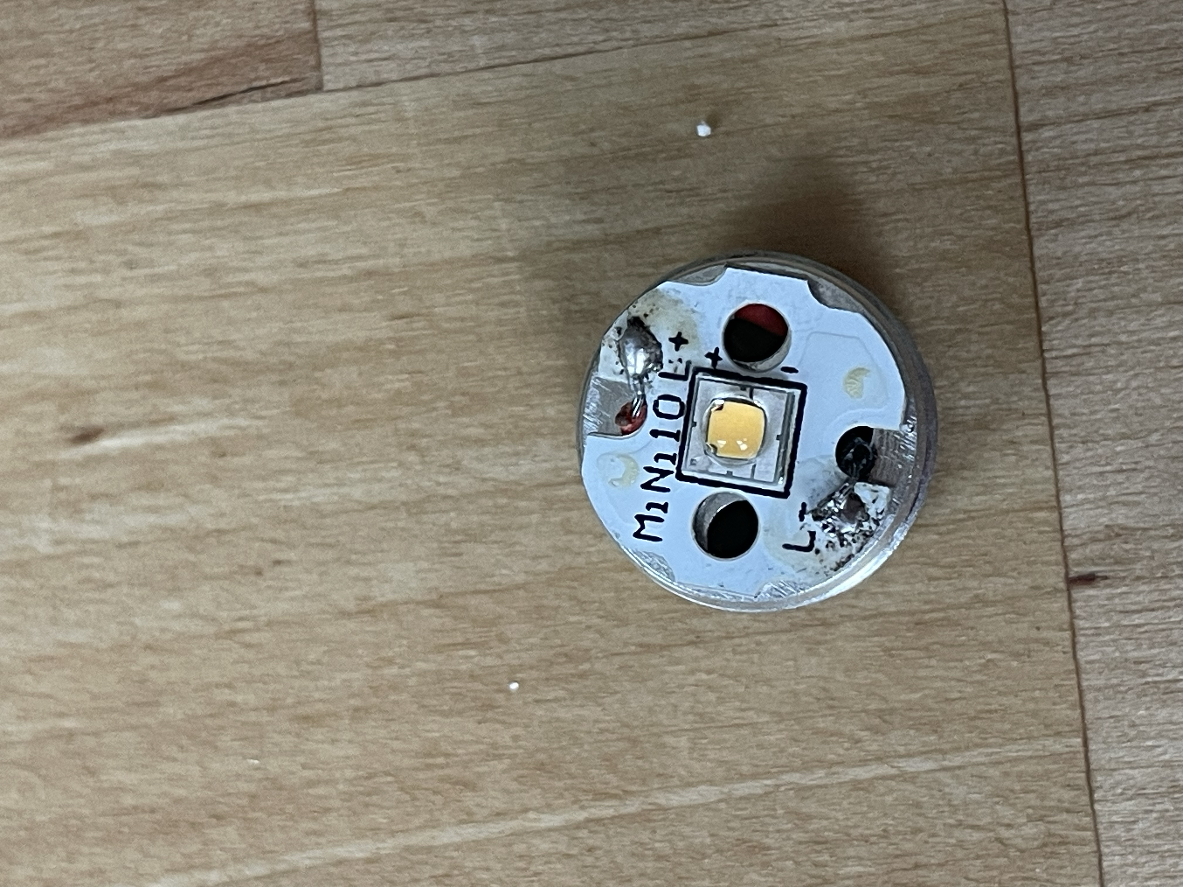

Haven't shipped off the return yet, so I thought I'd look a little closer. I could not open up the pill, because the disc is secured by four metal fingers, a bit like the way a jewel is mounted on a ring. There was one cap visible on the side towards the battery, so I scribbled some graphite on that, but it had no effect on the NMM problem.
To get to the back side of that circuit board would involve more strong-arming of the pill than I want to do, given that I'm returning it. So, I reassembled, checked that it all works just as before, and packed it up again. Photos below, just for the archives.
I cannot be sure, but from the evidence of what is on the battery side of the board, I doubt that the opposite side looks like Jon Slider's photo of the Ti3 board.
